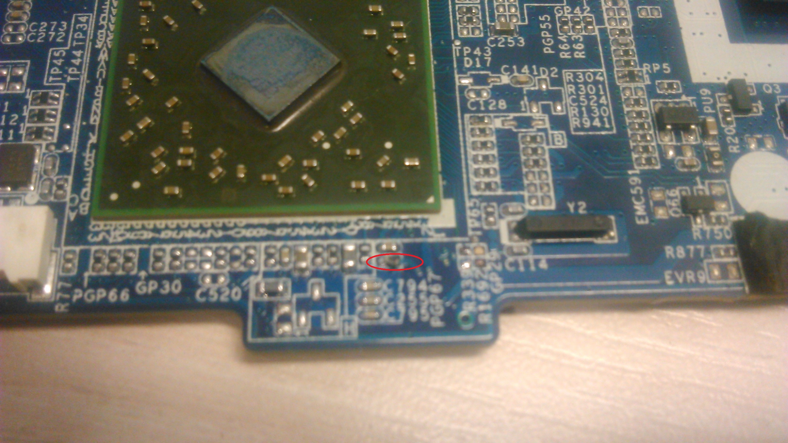

                • quic307
                  • Jun 2015
                  • 255
                  • Greece
                  Re: foxconn v181 mbx-272 schematic
                  Hello techs,
                  Does anyone have the MBX-272 V181 schematic?
                  I have a problem with rezistor in photo. (attach...)
                  Thank you...

                    • quic307
                      • Jun 2015
                      • 255
                      • Greece
                      OK, does anyone knows what resistor is that?
                      If anyone have the netbook to measure the resistor?
                      SOS is the only problem and I cannt fix it!!!!!
                      • fagoon bhuiyan
                        Mahmood
                        • Aug 2017
                        • 27
                        • Japan
                        That resistor is 0.00 Ohms.

                            • JIMBOYVOLTRON
                              • Dec 2020
                              • 5
                              • philippines
                              Originally posted by quic307
                              Hello techs,
                              Thank you...
                              512 ohms
                              • abdulhashim
                                • Jul 2015
                                • 20
                                • india
                                Originally posted by JIMBOYVOLTRON
                                512 ohms
                                thanks i put 510 ohms its working
