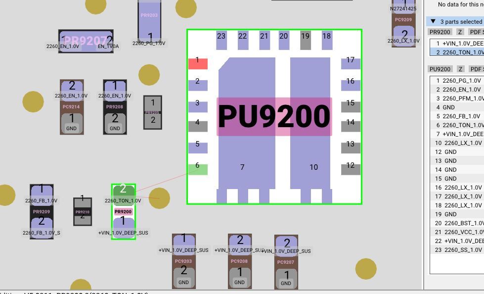

    HP 450 G7 da0x8mmb6d0 the problem is the pr9200 burned. what is the value
    thanks NO SHEMATIC JUST BOARDVIEW

    Pr9200 near ic APW8713

        need shematic
          • 21577
          pr9200 is connected to APW8713 pin 6 TON .Look at the APW8713 Typical Application Circuits https://www.anpec.com.tw/product-download/0/APW8713-1/

            thanks bro pb solved

              pr9200 100k
