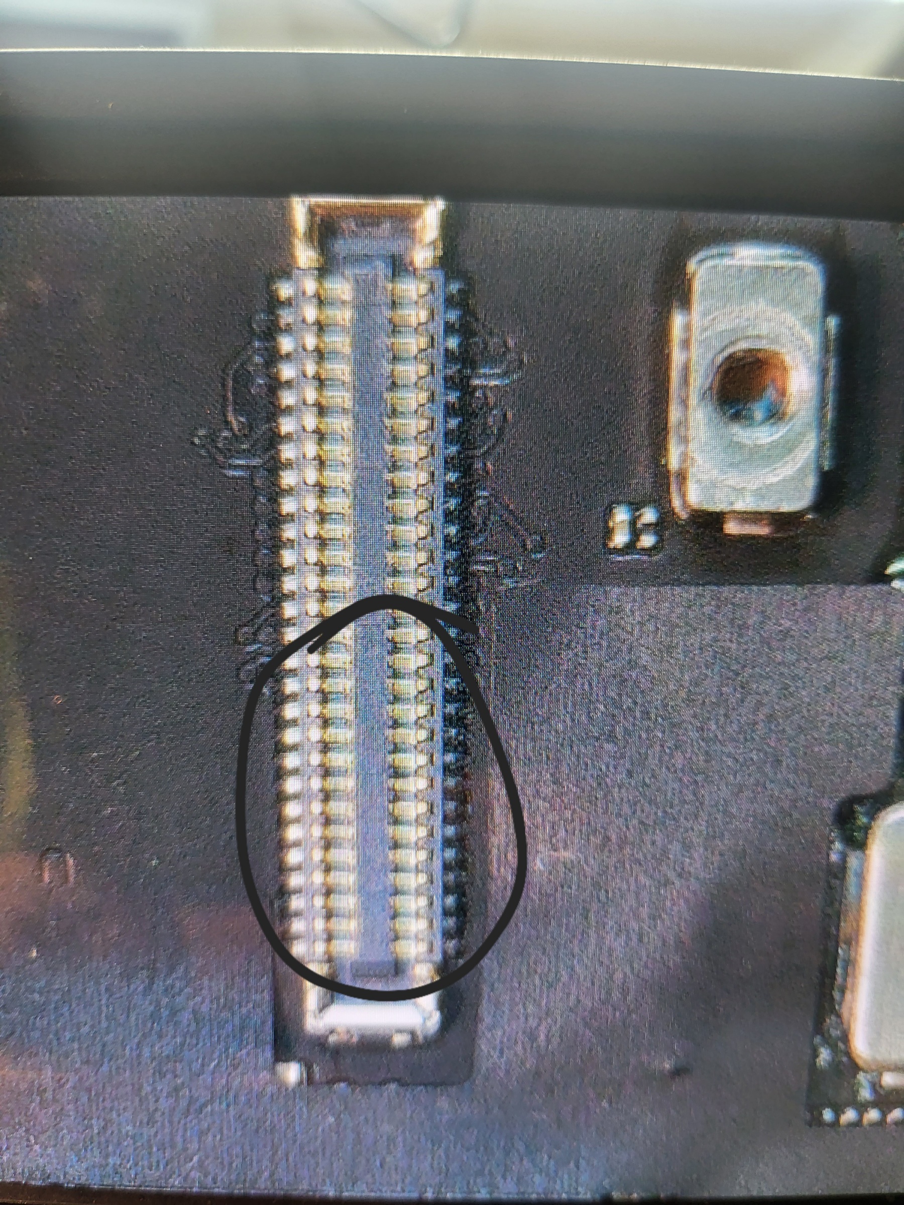

    Hi guys, I have 2 ipads with the same issue. Both suffer from severe ghost touches, I have tried several different digitisers and checked the connectors. But what they seem to have in common is that the the pins on the bottom half of the socket on the MB are all short to ground.
    Now, I can't tell if that's normal as I have searched high and low for a boardview or at least a schematic but I keep coming up empty. Anyone here have any experience with this? Or even better, a link to some technical information?
    I'm at my wits end after several days of searching with no joy!
    Thanks all!
    Andy

    its seems no short to ground i have checked on working board
