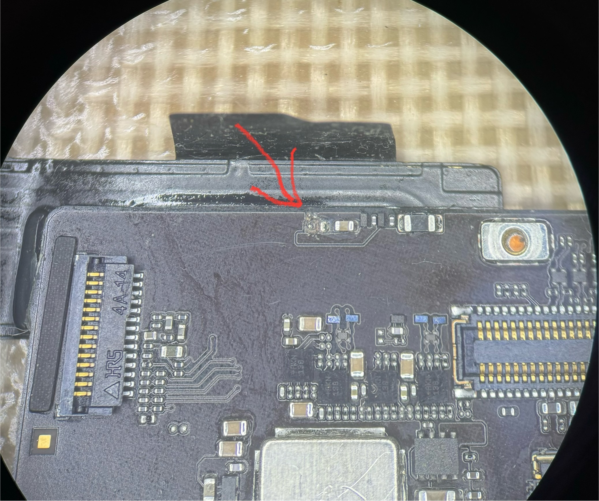

    i have a problem with dead no charging iPad 9th. i dont have xyz or boardview.
    can somone help me to identify this componen as attached. i believe it is a mosfet. it gets hot when i injected voltage from battery connector on the board.
    thanks in advance

    It's a mosfet : FDMC 6686P

      already found the culprit caps..
      case close..

        What is the part IC?
        the part was heated and the inscription was not visible, and not have schematic.Thank you

          It is backlight IC : LP8566

            Hi! I have another ipad 9 this ipad broken pads and missing part,i dont know what is it,and is it possible to fix it broken pads? Thank you

              It is a zener diode BZT52C10.

                Thank you,the diode solder joint is missing,how can I connect it,with jumper?

                  Hey guys I got the same iPad and also no luck finding schematics. Anyone can help me out with which components these are? It seems like 2 capacitors but not sure and the ipad doesn't charge (0.005 amps)
                  I replaced the charging IC already
                  any help appreciated!
