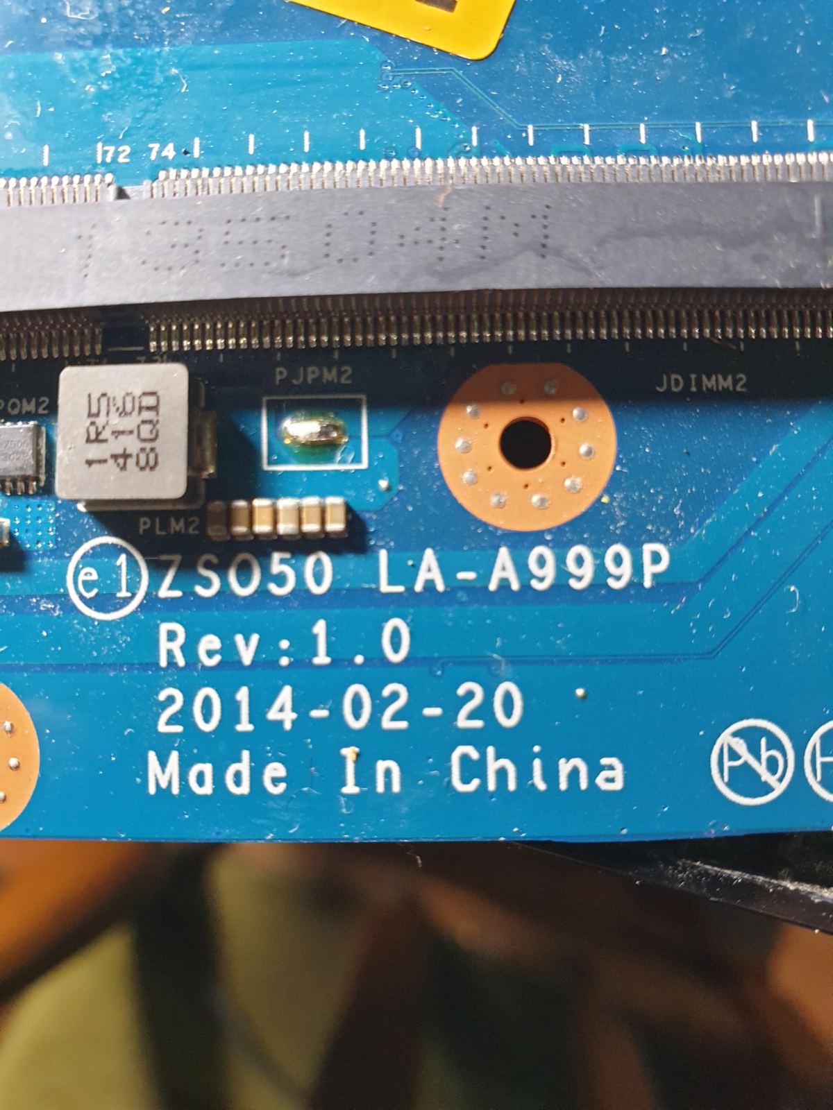

La-a999p Anyone have boardview ?
  • baddjavo
    • Jun 2018
    • 87
    • Serbia

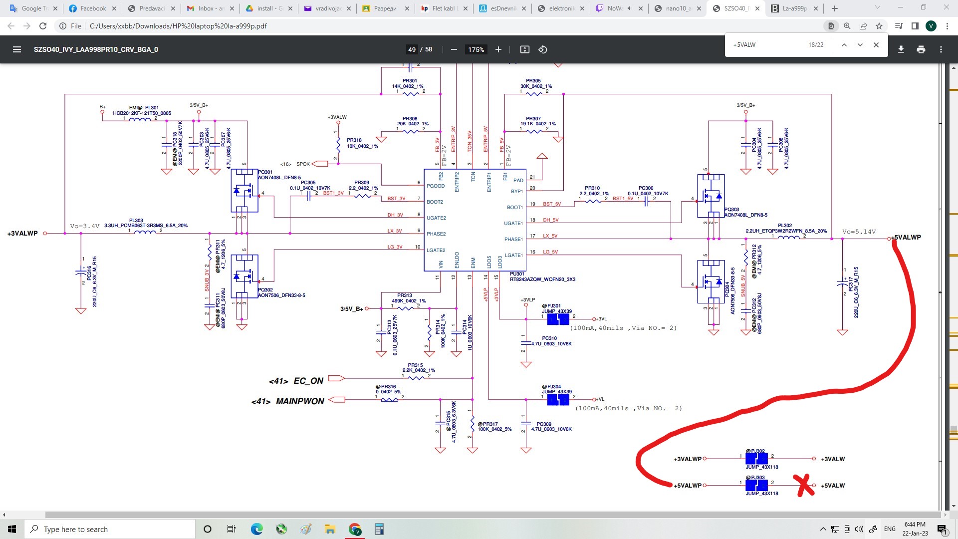

    Here is schematic if anyone need. La-a999p
    Problem is after pressing pwr btn led just goes off. If i remove solder-jumper on 5valwp, led stays on. Probably short , need boardview to trace it.

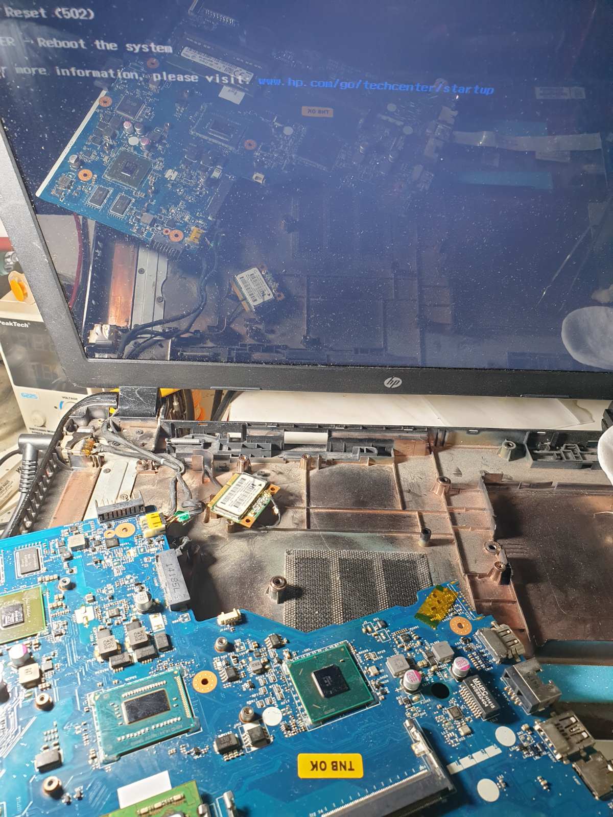

      i know. Right. But let me show you problem.
      After remove pj303 solder jumper. Laptop have normal 3.3 and 5v etc.
      So problem iz after that jumper, but where ? 22x places to go. Maybe less.
      Its not short. Tried already with lab power supply, no current.

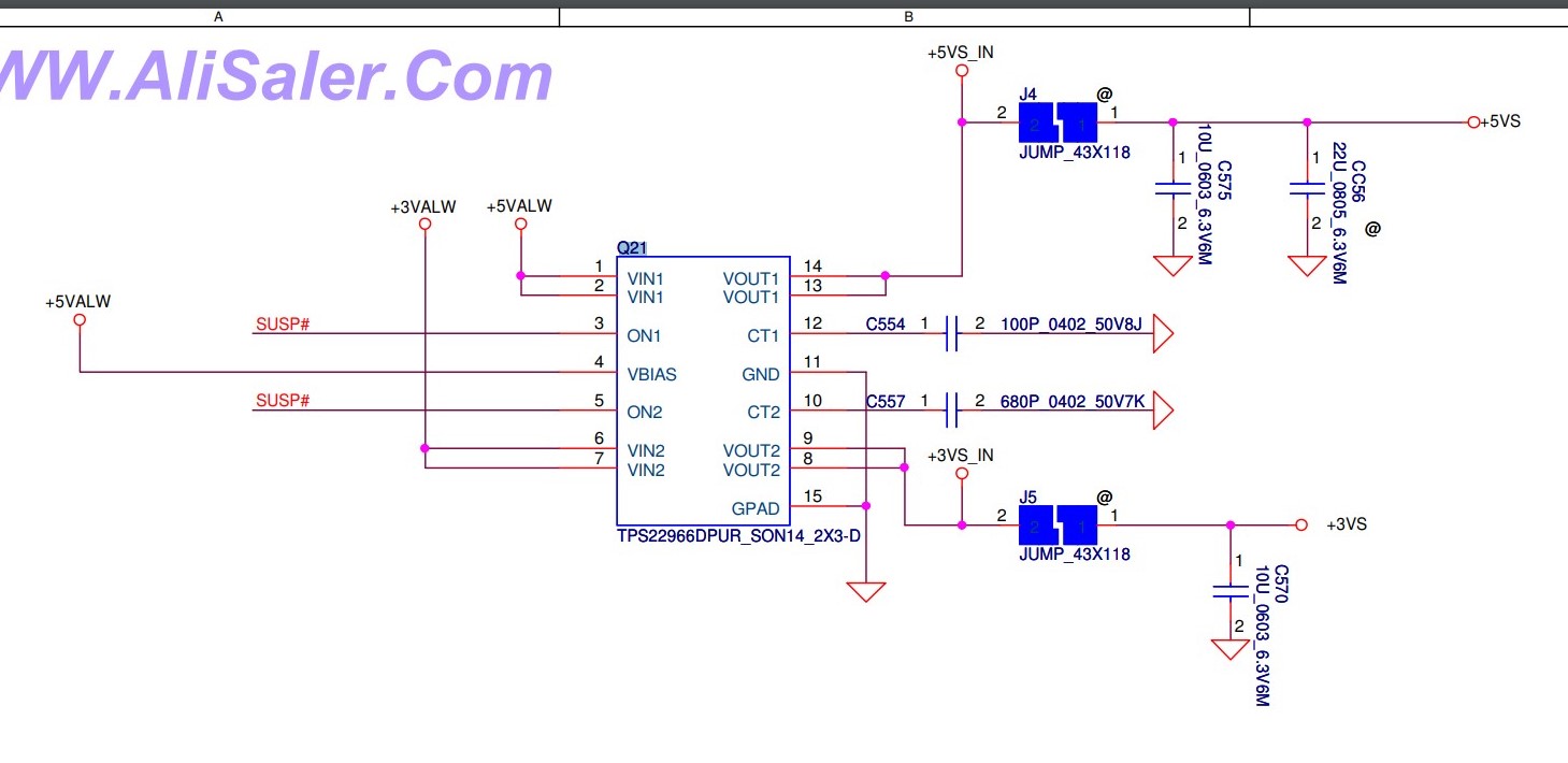

          Check resistance after Q21, Q22, US2, US1, QV12, QV15, PUM1.

            Cant open that .brd in boardviewer22 , any easy software recommend ? I will check those, guess manually for now. Just found Q21 ...
            • baddjavo
              • Jun 2018
              • 87
              • Serbia
              Re: La-a999p Anyone have boardview ?
              After removing J4 jumper after Q21 (voltage on output pins 13, 14 is 5volts) , 3 and 5 always voltage present.
              Resistance after J4 is zero. short
                J4 is marked with an '@' symbol which usually means that it is NOT shorted = should be left open.
                Was there a factory short on your logic board ?

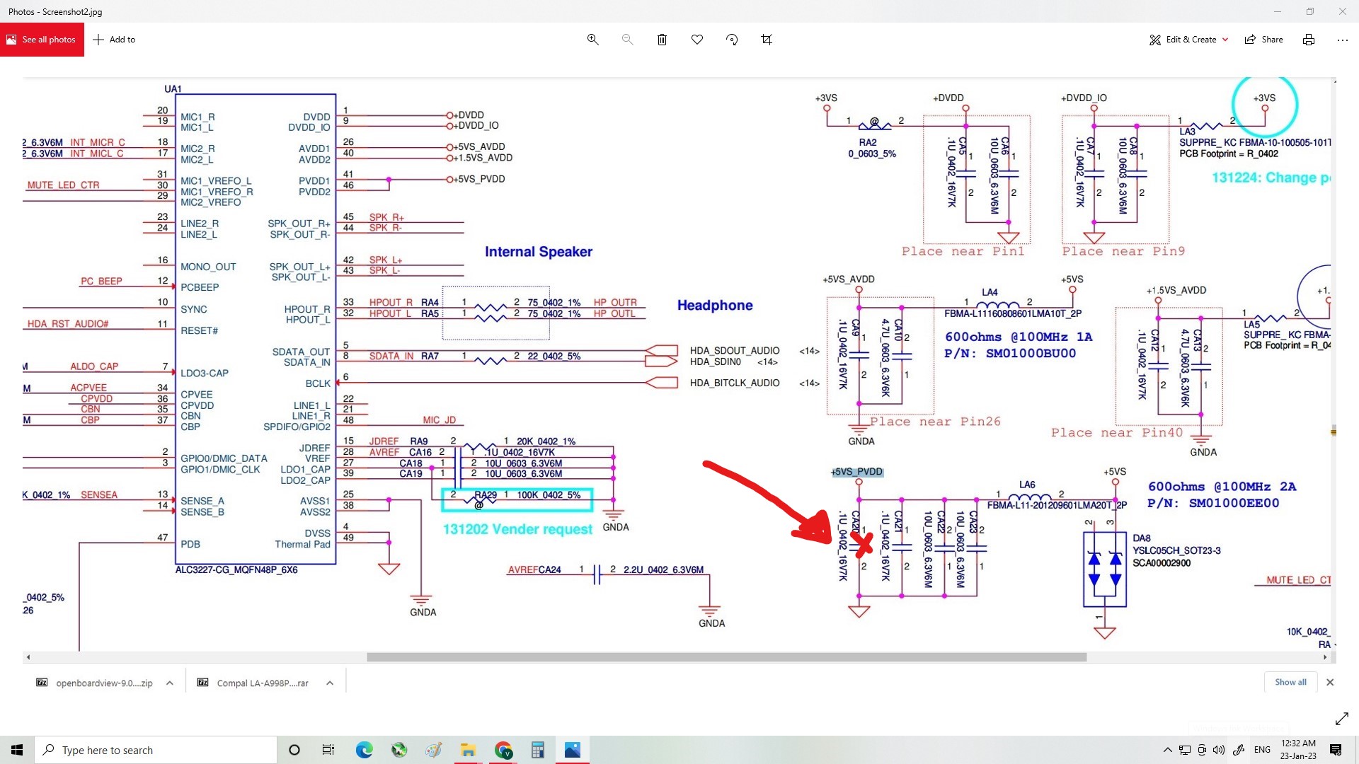

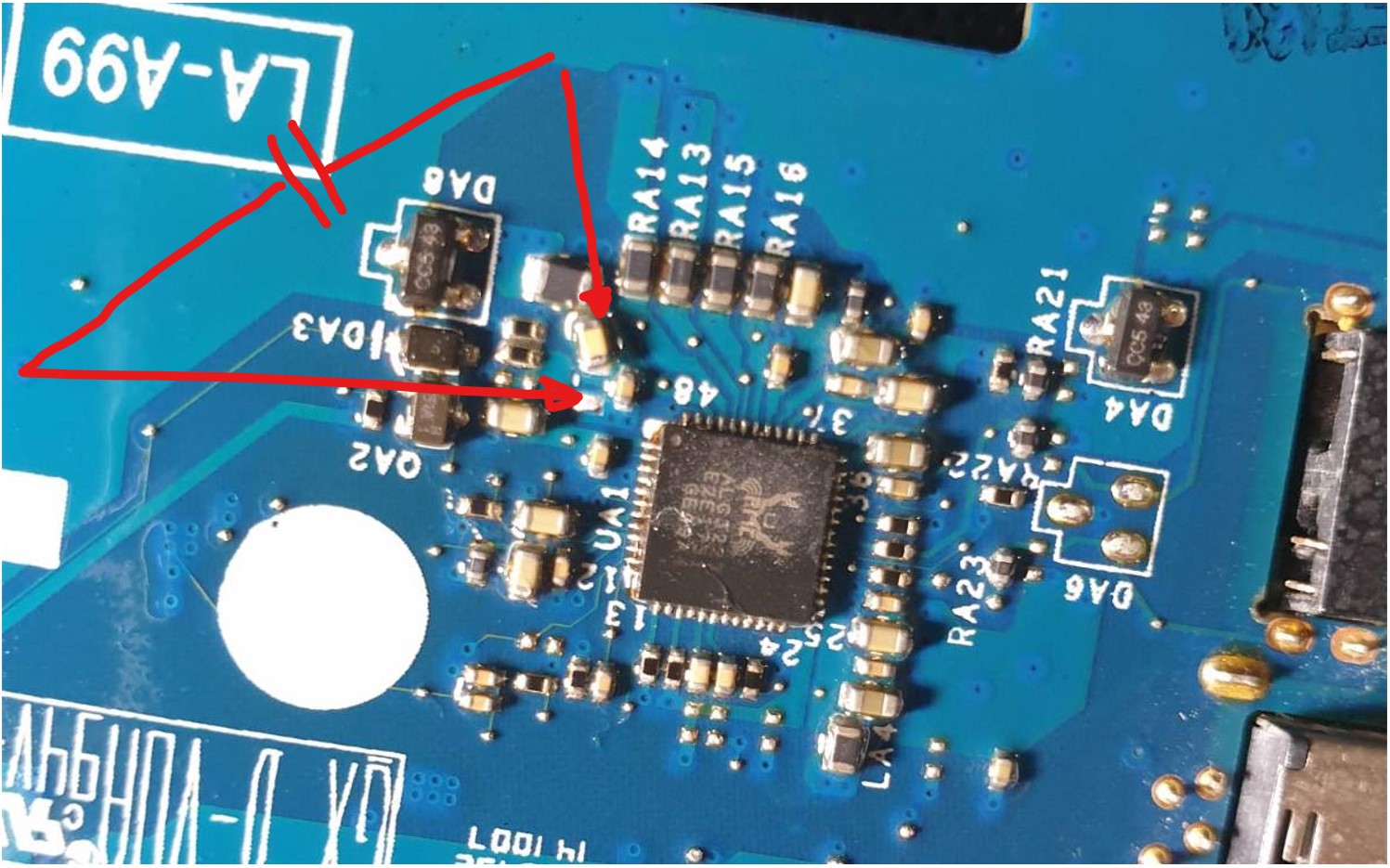

                  Yeah, its factory shorted. Found hot spot using lab voltage supply, 4 ampers near UA1 chip. Finger burnt.
                  • mon2
                    • Dec 2019
                    • 14034
                    UA1 = audio codec ALC3227 ?
                    You can remove it and test again. It is only for sound support.
                      UA1 right. But not that chip, capacitor on picture, just moved cap left him on board. Cap connected on pin 46 of UA1.
                      Uploaded picture of motherboard just to confirm J4 is factory shorted.
                      Laptop is working now !
                      Thx mon2, and AL._.EX appreciate help.
