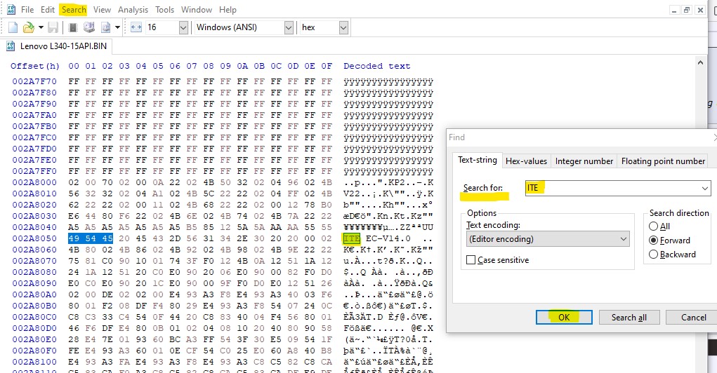

    need nm-c101 kbc dump
    need i/o dump...

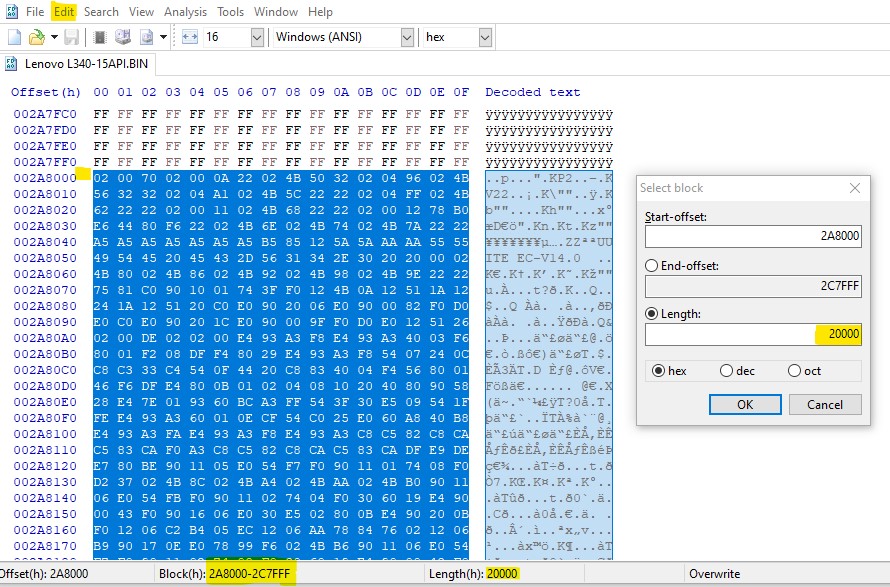

    Copy it from your bios backup using HxD. The first search result isn`t the right one,so press F3 to find the next result.You can see the offsets in the pictures, just put your cursor at the beggining, right click then choose "select block", the first offset will be set where you put your cursor at 2A8000,then enter the length as 20000. Copy and paste into a new file and save. 20000 in hex is 128KB
