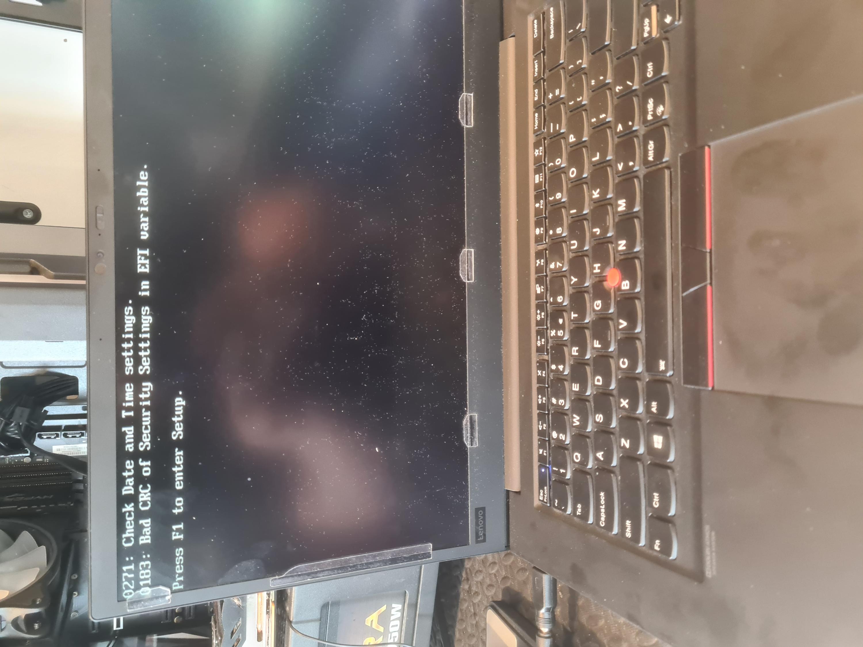

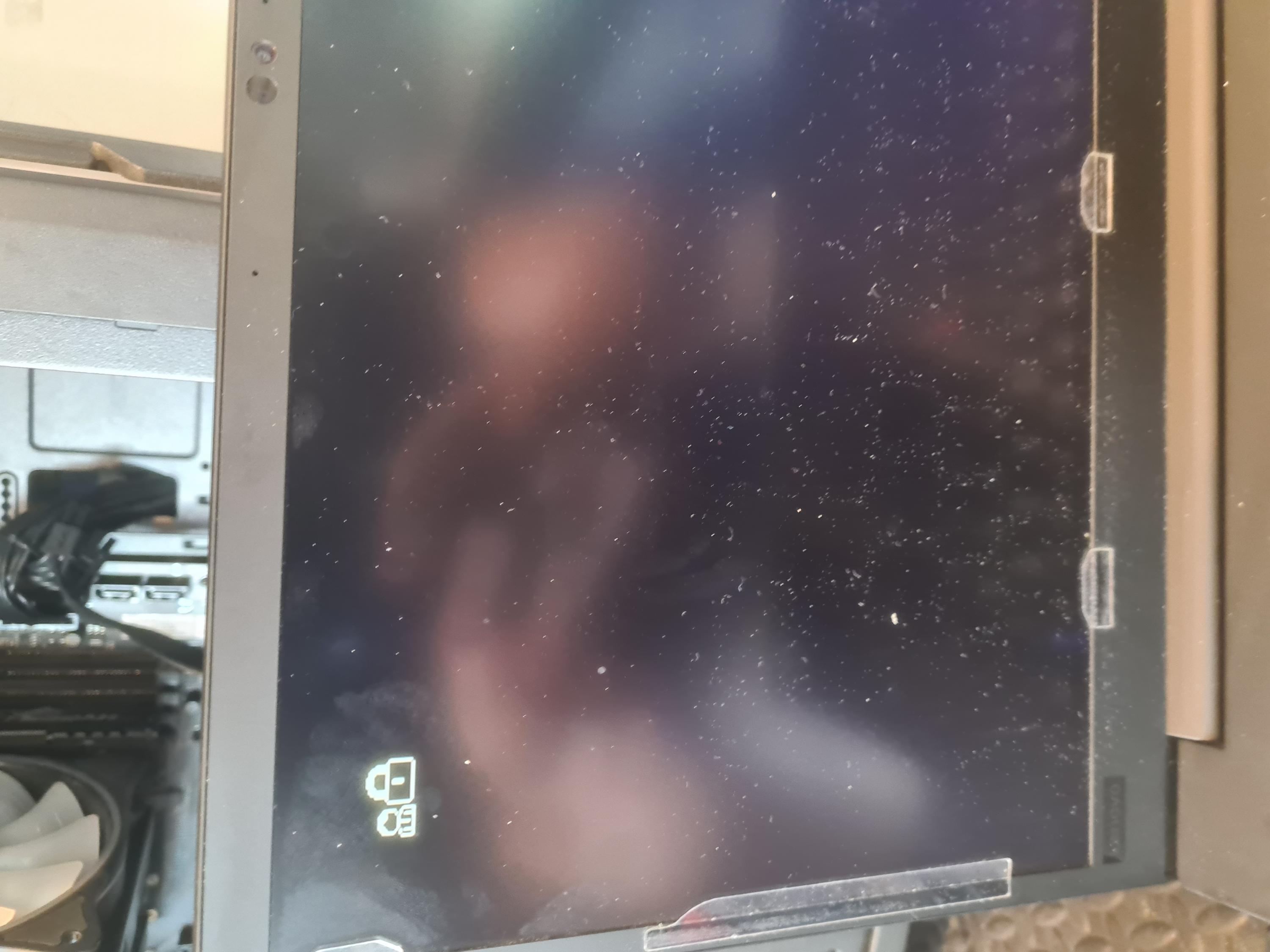

              Re: Bios help please Lenovo X1 Extreme 2nd Gen (Type 20QV, 20QW
              Thanks for assistance,
              This bios the laptop turned on perfectly but came up with this error?
              File Type: rar X1_Extreme 2nd Gen( Type 20QV, 20QW )_N2OET58P.rar
              Ater pressing a button arrived back at padlock
                  https://www.badcaps.net/forum/showthread.php?t=87588
