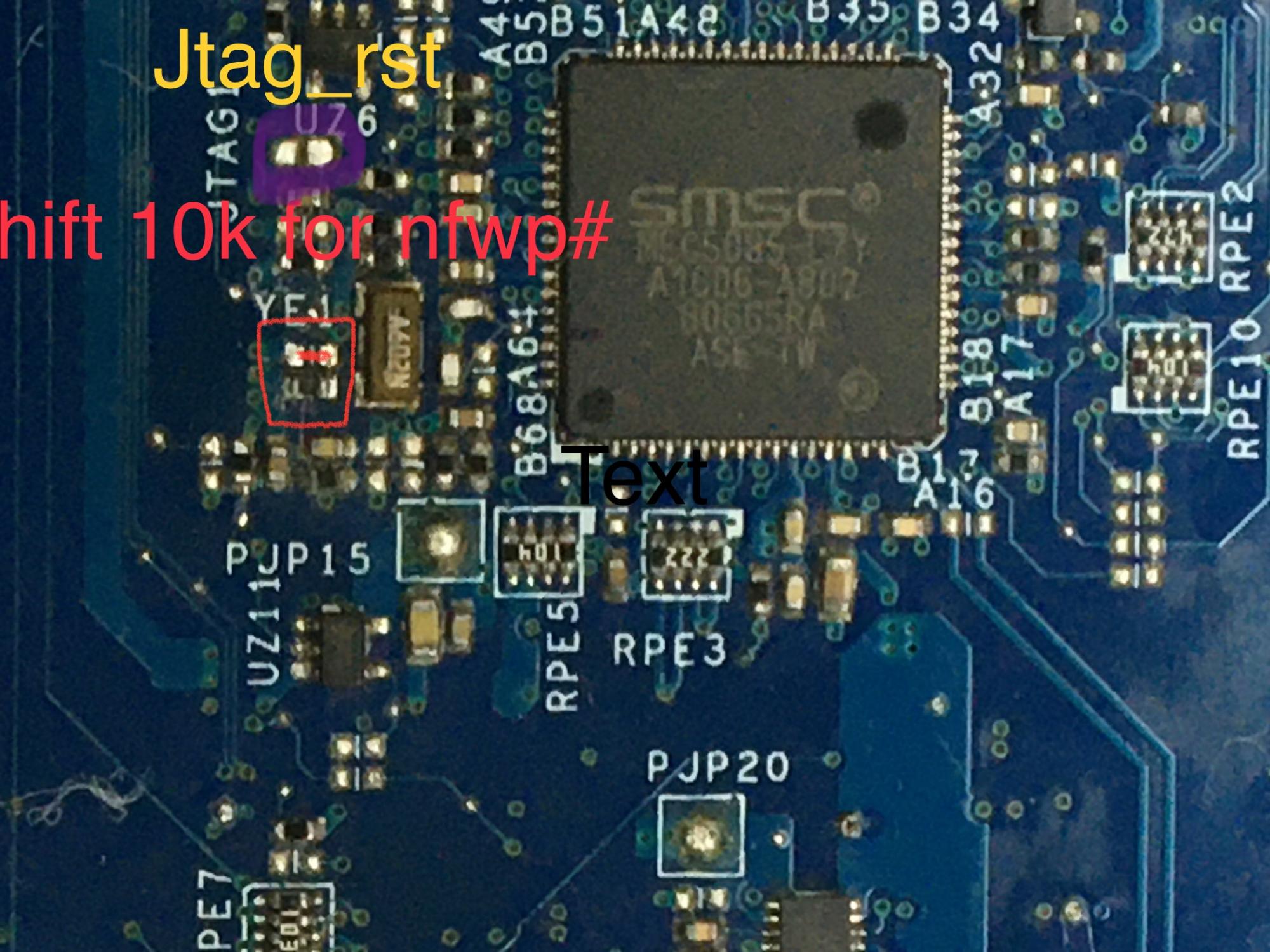

    hello
    I have a laptop dell lat E5550 no power ,but I see the stdby 3.3V 5V and 13.70v all okay.I don't get ddr supply no cpu score nor I get 3.3v and 5v S0 voltage.So basically what I understand my micom MEC5085-lzy could be corrupted as RUN_on and SUS_on control voltage is not there.
    anyone programmed this mec5085 chip with svod programmer.it only reads but for write it gives errors.I tried to short #fwp short to ground .but same error.
    pls if some one know how to program
  • guruji
    • Oct 2012
    • 124
    • India
    Re: dell e5550 La-A911p ZAM80
    Okay finally programmed it will put the bin file for it but for now uploading the resistor that's need to be shifted for nfwp# 10k to ground.also jtag ret is not necessary to solder but I have market the pad for it .
    • guruji
      • Oct 2012
      • 124
      • India
      tested ec working new version
