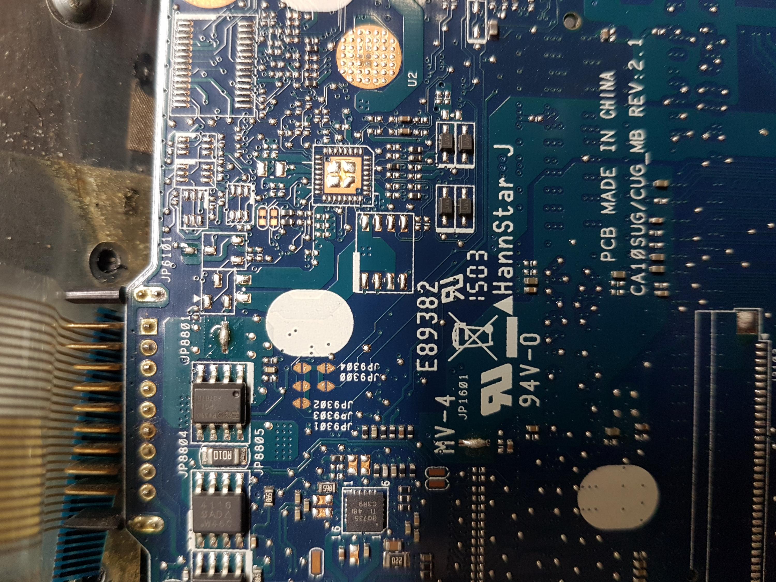

      Look for 2 small triangular shaped pads next to the CMOS battery,or under or right next to the RAM, short the pads while booting up
      https://www.youtube.com/watch?v=C9zrcx0PDhg
      Many consumer laptops have the 2 pads,business laptops have the challenge-response code https://www.badcaps.net/forum/showpo...42&postcount=4

        i tried but it doesn't work

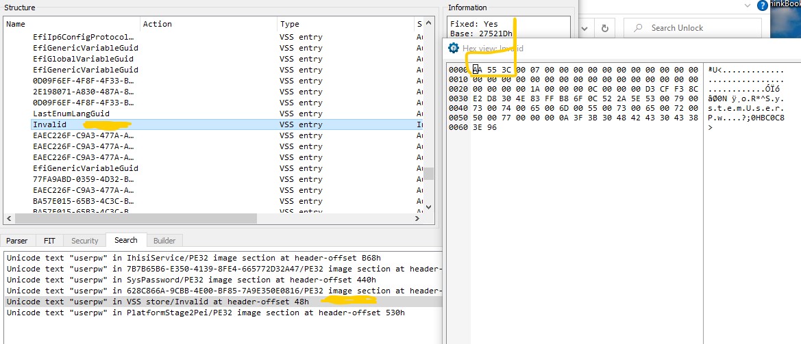

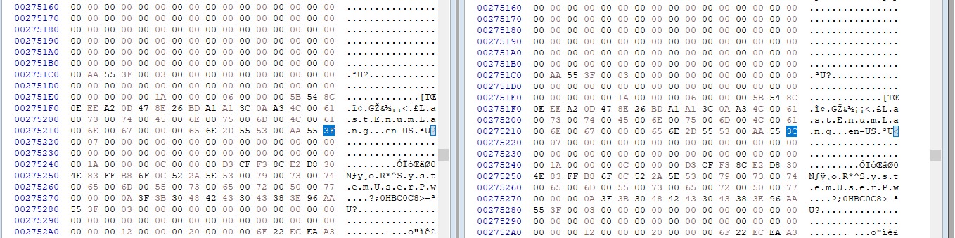

                • 20304
                Re: ca10sug/cug mb rev 2.1 bios toshiba L40-B
                Originally posted by satishkumar
                [ATTACH]281156[/ATTACH]
                Originally posted by bilen
                thank you my friend. this really worked
                Can you tell me how you did it?
                He made one change in the 4MB backup, you can see the difference if you open both bios with a hex editor and compare the files. Changing 3C to 3F to invalide the password.
