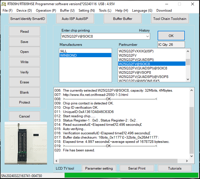

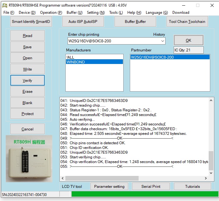

    BIOS Integrated Circuits (2x Winbond), both located on the underneath side of the motherboard, nearby the 3 LED => So needed to completely remove the motherboard:
    1) Winbond W25Q32FVSIQ => a 32MBits (4MB) memory for the main BIOS. SOIC8 SMD chip.
    2) Winbond W25Q16DVSIQ => a 16MBits (2MB) memory for the ME I suppose. SOIC8 SMD chip.
    I have saved a copy of both chips in bin files, it was no problem to read and save the content with my RT809H universal programmer. I have attached some screenshot files here to give an idea of what was the original state (even if it may be corrupt state already), but for any reason, I was not allowed to upload the bin files (I got a pop-up saying I cannot upload files with this extension).

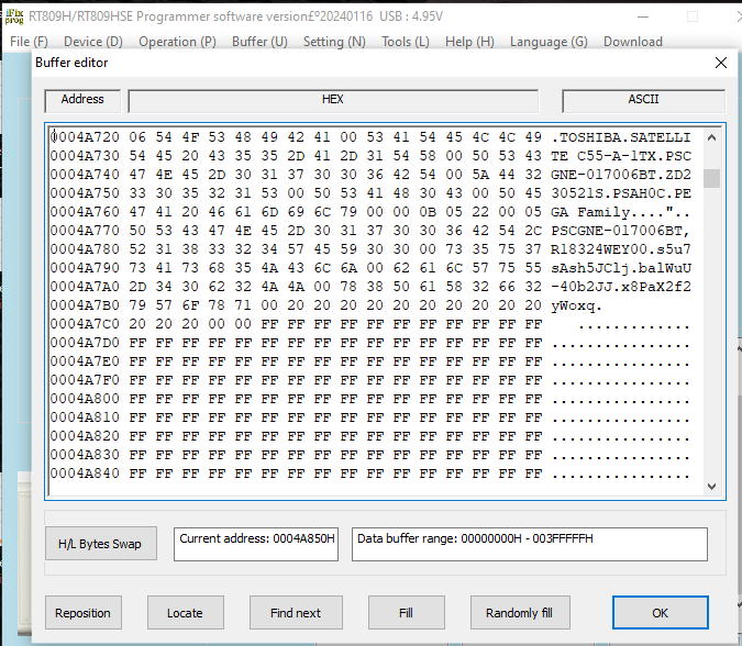

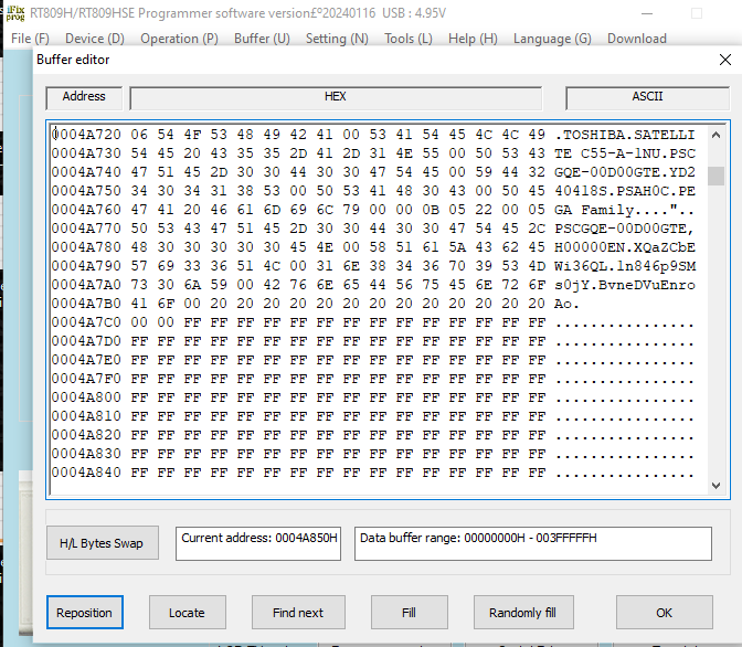

            I have reprogrammed successfully both Chips with the content downloaded following the link indicated in above's comment #4, but I noticed something when analyzing their buffer data.
            So, small clarification needed here before soldering them back on the motherboard... re-assembling my computer and test it.
            Let me explain:
            Inside the Winbond W25Q32FVSIQ => 32MBits (4MBytes) memory, from the location hexadecimal address 0x4A721 to 0x4A7C4, there is a zone where we see in clear text the identification of the laptop, then some less readable data... followed by a bunch of FF indicating original blank zone.
            Of course, these data do not match between my original one and the one I downloaded here to re-flash the chips, as they do not come from the same original laptop => See attached a screenshot of both buffers at these addresses.
            So the question are:
            1) Am I allowed to edit the buffer in the downloaded file to make this address range matching my original information or not?
            2) Or even better ... I suppose when you reflash a computer BIOS using the normal USB or CD boot application, that only some zones are actually overwritten to finally update the BIOS without impacting important local computer identification data an so on. Is it then possible to only overwrite partially the chip with the new content, preserving original laptop data, and others important zones if existing?
            Thank you...
              • 20855
              You can copy the DMI using a hex editor. 4A720 - 4A7CF

                Hi SMDFlea,
                I am back again .... Last thing I hope....
                I have managed to copy the original DMI zone to the new downloaded BIN file to make it match with my original data.
                By the way, I looked for my LAN MAC address of the onboard NIC controller, and I also found it, and replaced it with my own laptop MAC.
                Until here I hope everything fine, for the rest I found a huge number of differences, as I have a V1.1 in my original BIOS and a V1.0 in the new downloaded version, so I suppose somewhere going back with version.
                Anyway, if it boots back, it is the first goal....
                Let me ask a (hopefully final) question => after having modified all these data manually in the downloaded BIN file to make them match my own computer, is there not somewhere a CRC checksum value that I have to adapt to avoid my copy to be declared as "corrupt/wrong", I don't know what?
