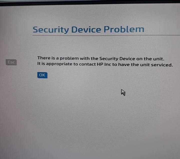

HP Elitebook 745 G5 Security Device problem
  • Robien
    • Mar 2014
    • 25
    after i used rcunlocker to clear password from main bios i got this error
    i tried many bios but same problem

      put back original bin into main bios and use RCUnlocker to the 2nd chipset which should be EC_ROM. At 1st boot reset security settings.

            Did you flash both files I posted ? Try returning the original files.

              i flashed both files that you post , when i return the original got the same message

                same problem after clearing 2nd chip and keep main

                          He's not resetting security at 1st start, this happened to me when I did unlock an HP and missed to enter in bios to reset security and laptop did boot from ssd. I had to put back both original bin files, start the laptop, let it boot, then reflash EC_ROM and reset security settings to default.
                          So, try this: put back original files, power on the laptop and see if security message is displayed. Then modify EC_ROM with RCUnlocker and reset security to defaults, it's at the end of security tab. Remove ssd to be sure laptop is not booting.

                            Clear main bios VSS region and later add SN etc back in bios.
                            thanks to RethoricalCheese
                            problem solved after Clear main bios VSS region
                            mpm unlocked
                            write back data
                            it works
