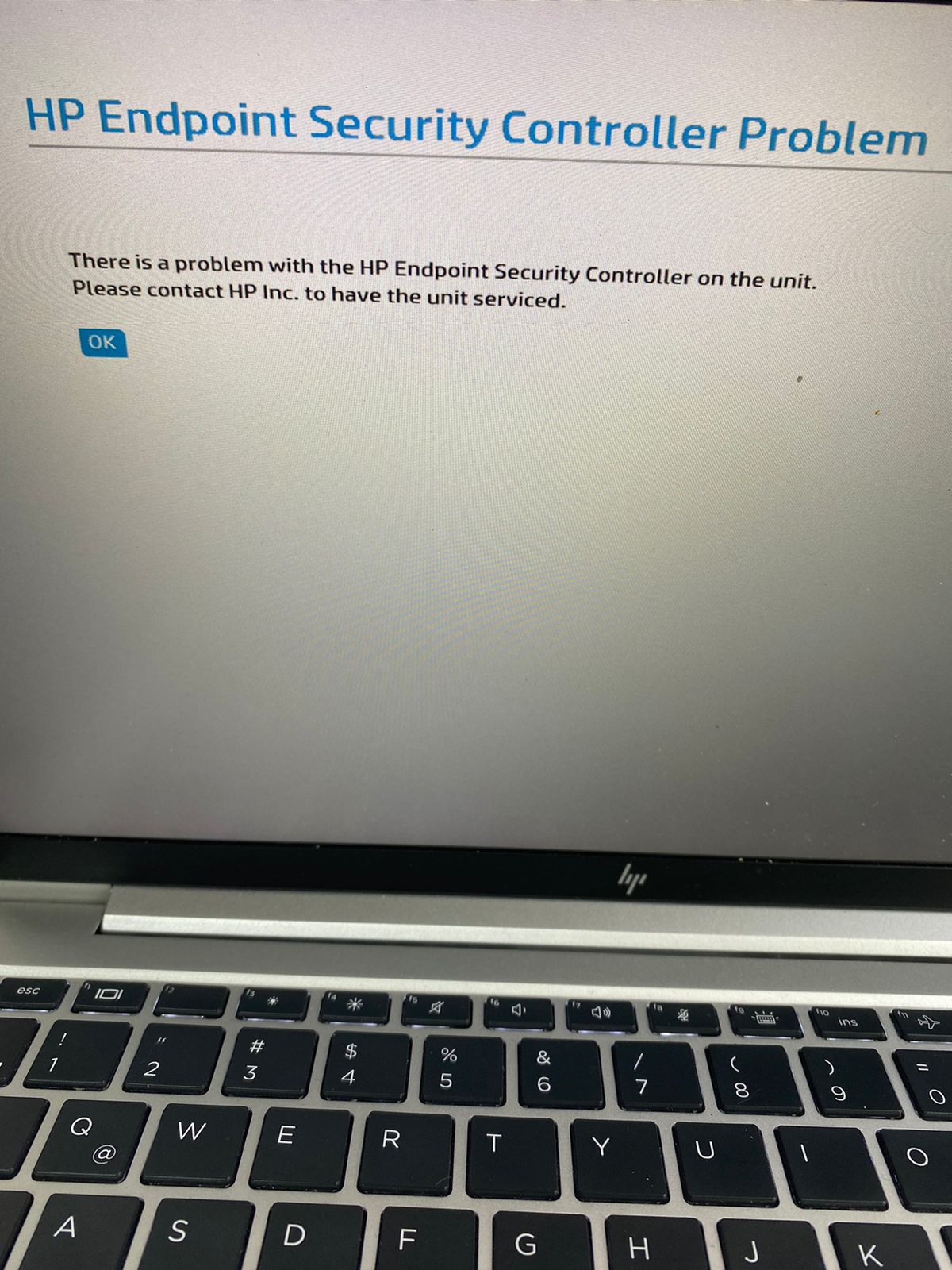

    Hello friends, someone could help me, I managed to remove the password of this computer with rcunlocker with the 16mb chip, but I got the end point security message.

    Re: Hp Elitebook 830 G7 end point mesaje after unlock rcunlocker 16mb
    Post your EC + BIOS file here.
      you should have reset security to factory settings at 1st boot.
          If I did it I always do it but apparently something else happened...
            Clear your VSS region in main bios and re-enter DMI in bios. That should fix the issue.
              it worked bro thank you very much

                hello everyone, i also removed the password from my 830 G7 , only flashing the first bios chip but i got the end controller security problem.
                take
                i am not that geek guy "Clear your VSS region in main bios and re-enter DMI in bios. That should fix the issue." is this supposed to take out the second chip and flash it, edit it and than weld it again on the mainboard or can i just use some options in the bios ?

                  Hello , I used these files and my laptop is finally switching on, unfortunately I get the same endpoint error, i dont know how to clear vss or dmi , i know to dmi inside of windows, could anybody assist with the "fixed" main bios file without the endpoint issue
                    Yes. Post the serial number and bios file you used.
