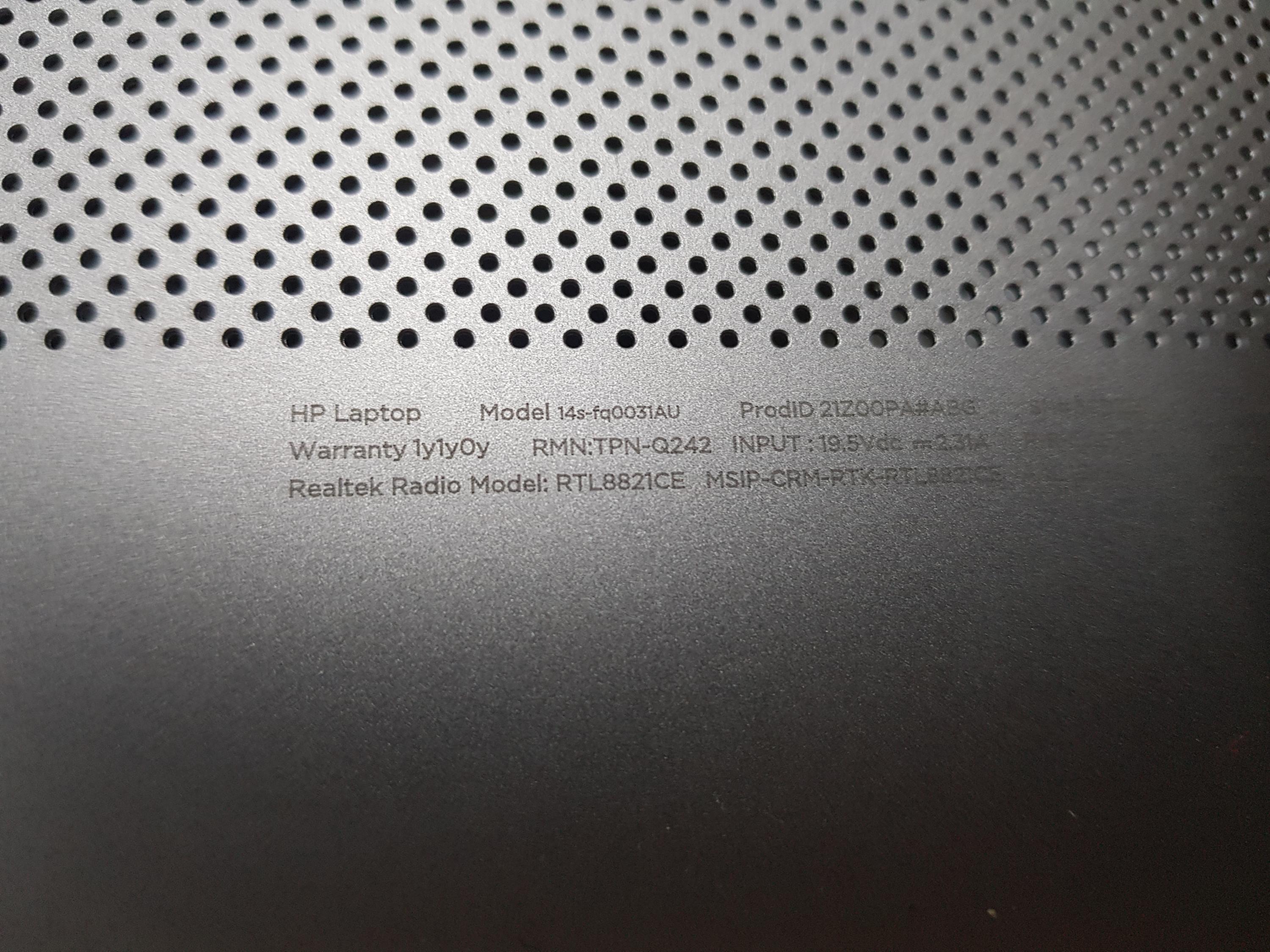

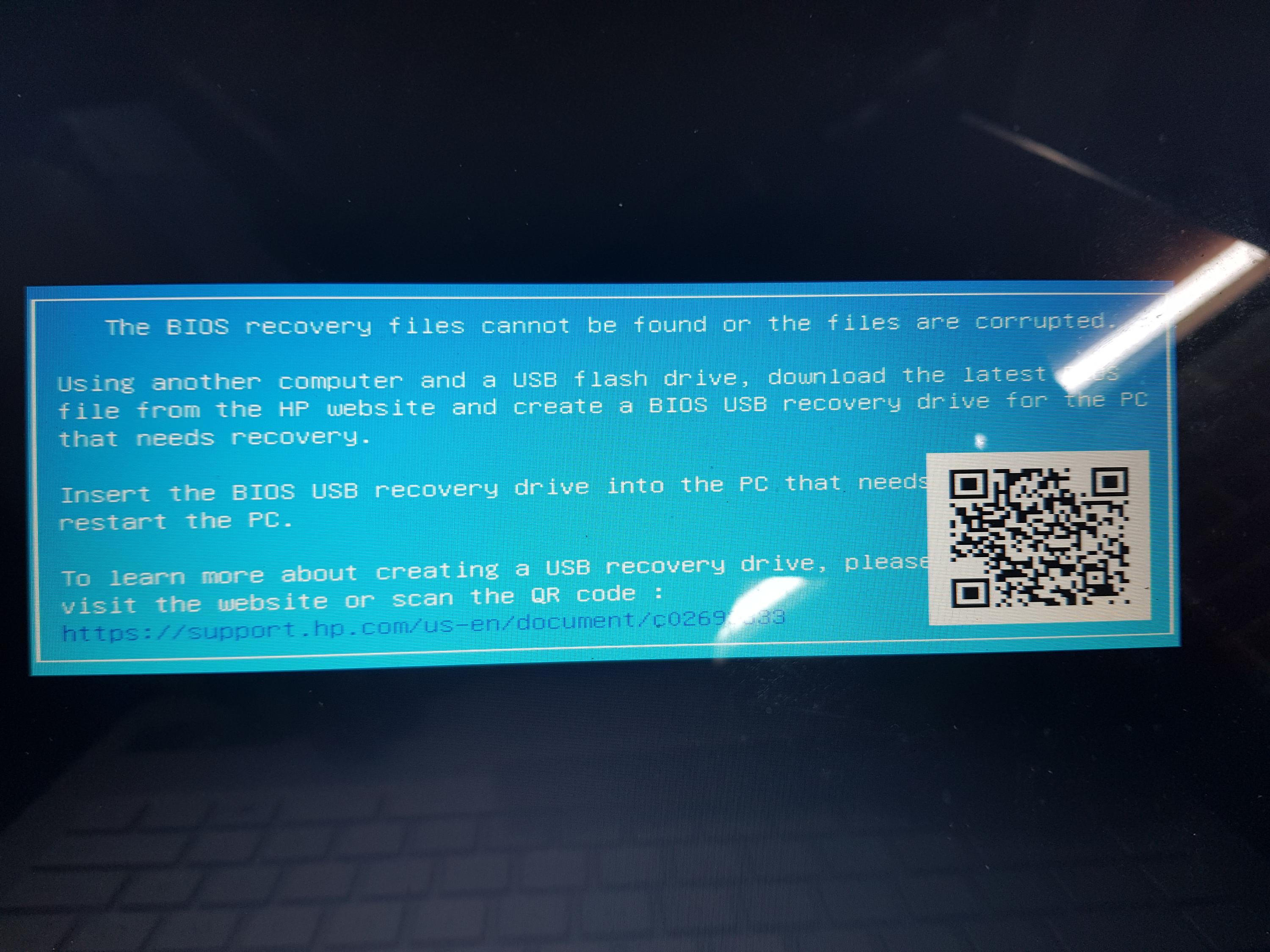

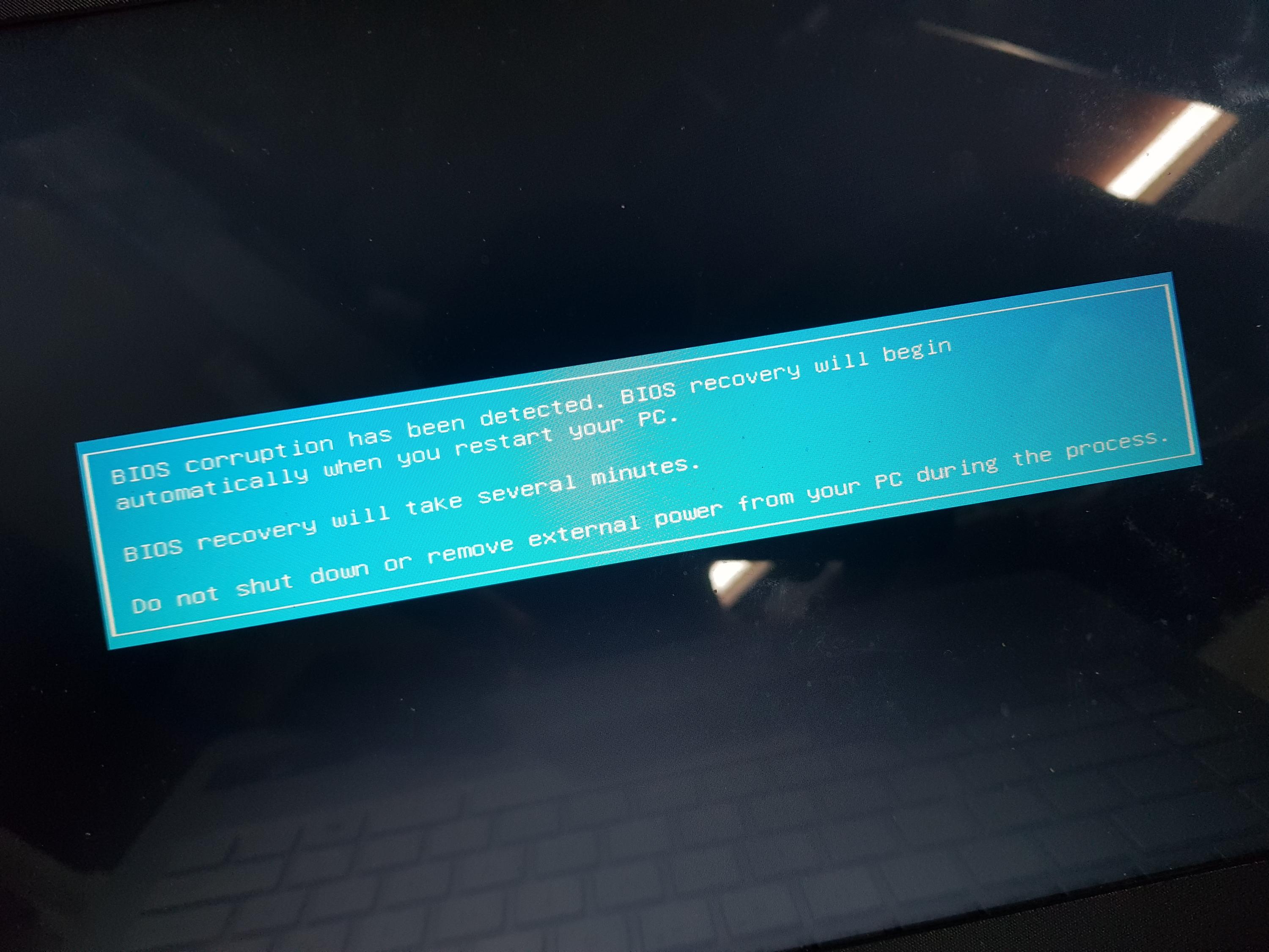

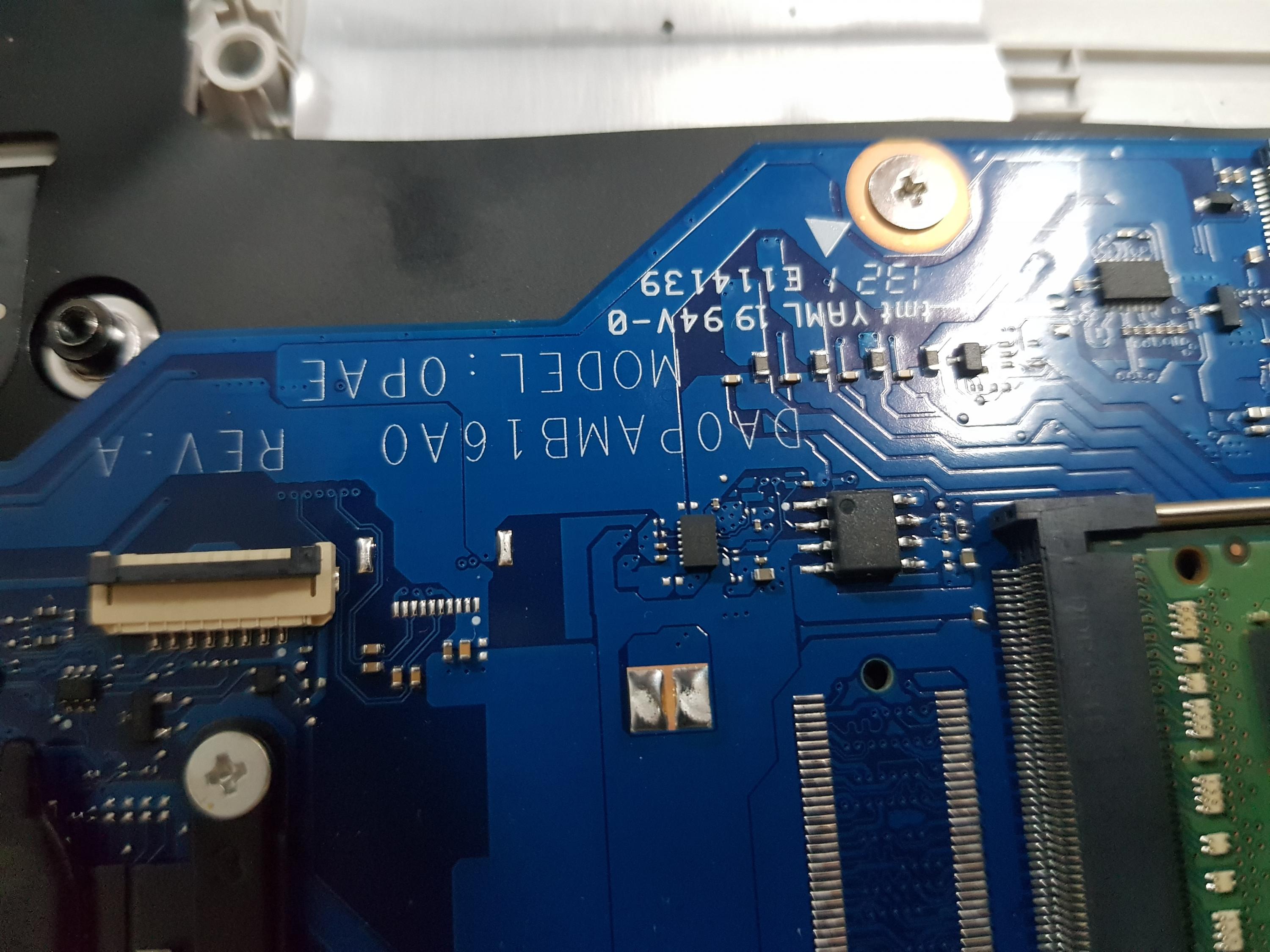

    Anyone who has a bios bin file for hp 14s-fq0031AU, I have attached the current bios and pictures of the errors that it displays
    I have tried the hp USB recovery and it doesn't work so if you can help me clear the error in the .bin file attached or get me a new one I will highly appreciate.

    Re: Need bios bin file for hp14s-fq0031
    Try the file HP Laptop - 14s-fq0031au-087B7 first.
      Thanks but I have tried both of these, it powers on no display. Is there any other way?
        Impossible. ,this is virgin bios.
            Found it from another working laptop by the way. If anyone ever wants it reply on this THREAD I'll upload it
