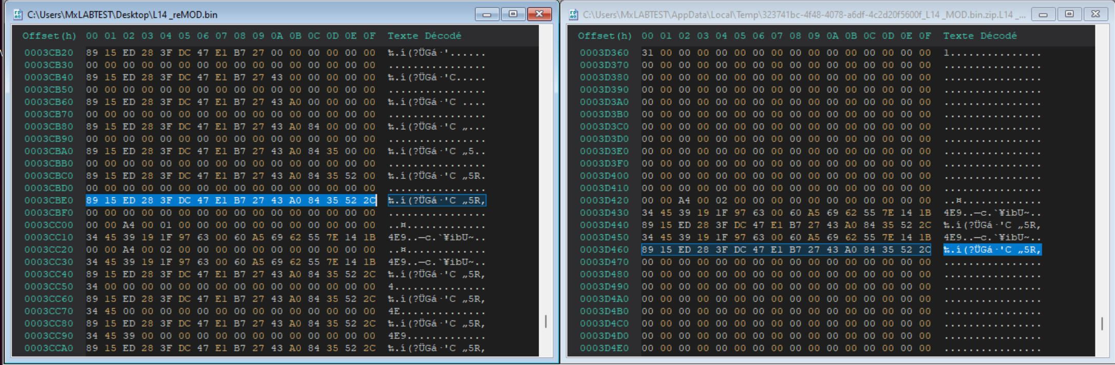

                    hi,
                    i have a locked T14 gen1. Serial number can't be read unfortunately(the sticker is torn) , i don't know what details to give you in such case, except the board is NM-C631.
                    I managed to read the Nuvoton NPCE68 with SVOD4, i attach the file.
                    I tried to remove the password by comparing with the file for SSDD that MAXpower3 gave.
                    Now it gives me "bad SVP data" error and shuts down. I also attach the file i modified.
                    Please help me
                    Later edit: i also modify only the areas that Maxpower mentioned (3C420 to 3C45F and 3D420 to 3D45F) and also, BAD SVP.

                    #31
                    Originally posted by babydoll8867
                    hi,
                    Please help me
                    your serial is in EC dump: PF1T6YFJ
                    try this file

                      #32
                      Volinakis, I got rid of SVP error but it still asks for password (Did the programming with internal and CMOS battery connected and after programming i immediately disconnect both batteries)

                        #33
                        there are bits everywhere in the L series, I don't understand

                          #34
                          you should look at my posts, once I made a file for L14/15, there was an error but he managed to enter the setup and do F9. but I don't know anymore or know

                                      #40
                                      I wrote the file you gave me, still SVP error.... i will look through your posts now
