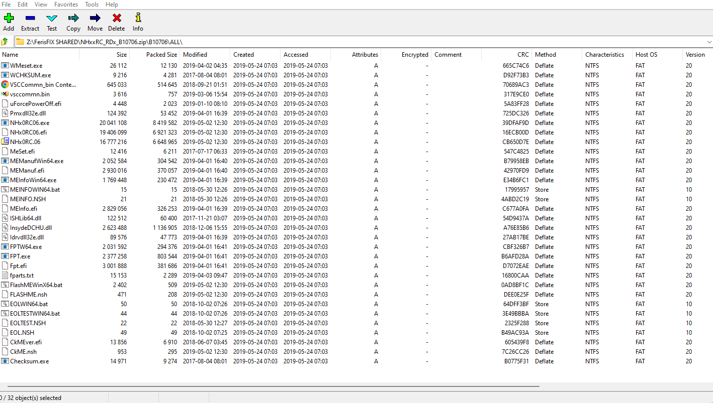

          I downloaded NHxxRC_RDx_B10706.zip as I assuming its for my laptop.
          It's a zip so please have a look what's inside (attached) and let me know how to deal with it. Thank you in advance.

            Download and extract this one
            Bios https://repo.palkeo.com/clevo-mirror...RDx_B10716.zip
            The bios is named NHx0RC.16
            The EC is this one i think,i couldnt see a newer one
            EC https://repo.palkeo.com/clevo-mirror...Dx_EC10703.zip

              Thank you. The 26.6MB zip I downloaded from your link also contains no bin file I would be able to use. It has got lot of files. Can you find out where to get the bin file for me please?
                The bios is named NHx0RC.16 ,if your programmer won`t recognise it because of the .16 file extension just rename it to .bin , NHx0RC.16 rename to NHx0RC.bin

                  Ah, I missed a line while reading. I tried flash the bios but still the same. Laptop is power cycling and not booting, no screen. I didn't flash EC cause never done it. Can this be an issue?

                    Forget the EC for now,it would need programming with a dedicated IO programmer through the keyboard connector.Its probably got some other hardware issue.If you want some help with it and youve got a multimeter and a bit of patience you can start a new thread in the laptop forum https://www.badcaps.net/forum/forumdisplay.php?f=23 .The service manual/schematic is this one https://repo.palkeo.com/clevo-mirror...NH58RCQ_SM.zip ,you can post it as an attachment to your new thread or post it seperately in the Schematic requests section as a new thread and link to it from your repair thread
