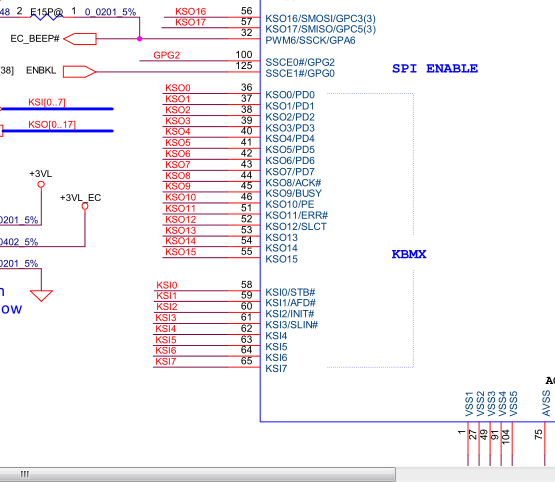

    please i need help to reprogram ITE8227E-192
    MB: NM-D711
    i am using SVOD3
    I can't find the MB connection file in the programmer and I can't find the schematics
    Motherboard KB socket has 34 pins
    can any one help me ?
    thanks

    IT8227E kb pinouts
    IT8227E=NM-C871
    https://www.badcaps.net/forum/showpo...86&postcount=8

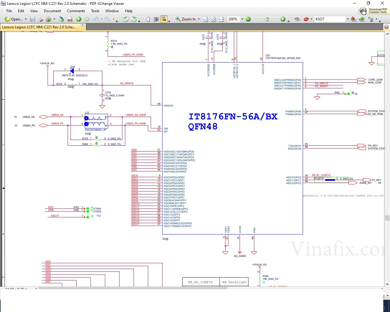

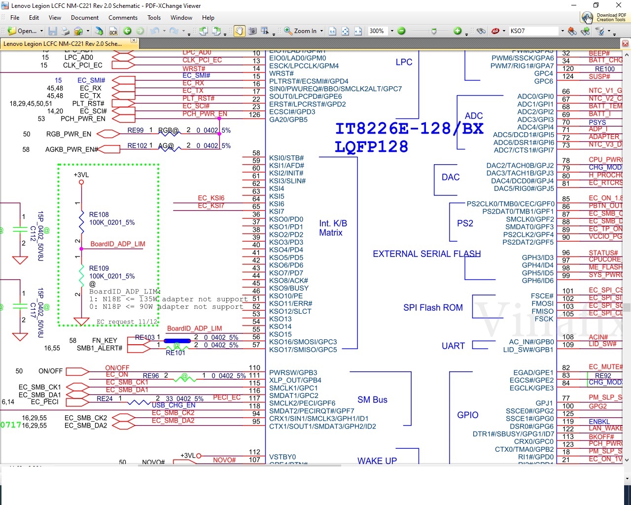

      Re: ite8227-192 reprogramming help needed
      thanks friend
      i will try but in My case keyboard does not connect directly to SIO but is connected through IT8176FN (eg NM-C221)
        The problem was solved with the help of NM-D562 schematics
        MOD Edit: Schematic posted to new thread -> https://www.badcaps.net/forum/showthread.php?t=121081
