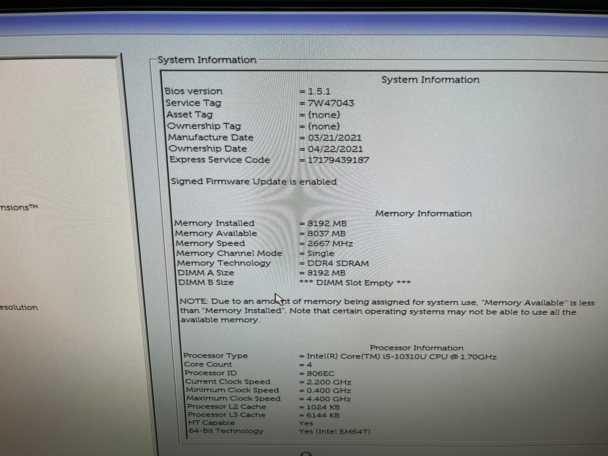

    DELL Latitude 5410 bios not work
    Please help
    Bios of dell latitude 5410 is corrupted
    I test with another Laptop work fine but serial number is incorrect
    thank you for re-entering the correct serial number and the windows key please
    Original Serial :4VBTP73
    THANKS

        Re: DELL Latitude 5410 bios not work
        Not good , bad serial and locked bios
        I explained myself badly in the post above.
        My original bios is corrupted, I put another one for testing and the PC works now.
        but the numbers are not good.
        I need to put this number back to 4VBTP73
          please can someone help me
          try this one
            Originally posted by SMDFlea
            try this one
            PERFECT, ALWAYS A GREAT JOB
            Thank SMDFLEA
