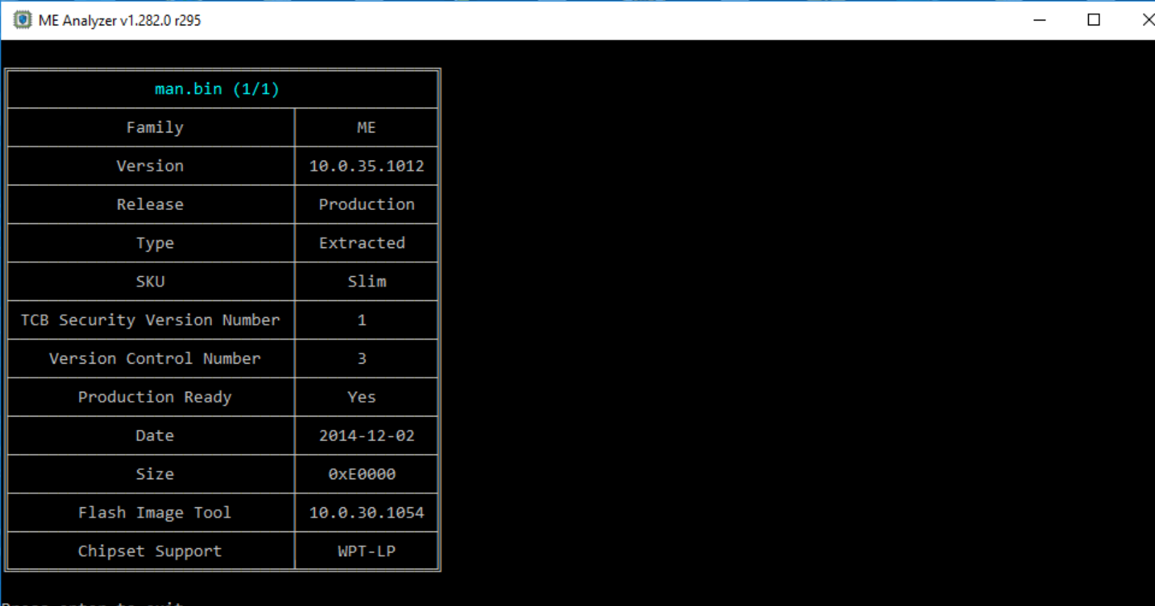

    macbook air A1466 820-00165-a bios
    I am working on a Apple MacBook Air A1466 820-00165-A logic board. The BIOS got corrupted or shorted because I have fan spin and all voltages are there, no chime or boot.
    The BIOS probably needs ME cleanup and serial change to FVFYQ6F2J1WK. Please help
    and attached version number and corrupted BIN file

    Re: macbook air A1466 820-00165-a bios
    Just cleared ME for you and the serial number is same as per your request, but I think that this will not solve your problem, I think that the bios itself is corrupted, not the ME region, but here you go, try and post results.
    I don't provide help for people using CH341A and a clip.
      sir u are true !!!!!! nothing has been changed same issue , green light and 2 Secound go to orange and keep working on and fan spin and all voltages are there but not able to boot , and on mouse side only flashing light and mouse stop flashing and all SPI resistor are fine
      any advice what should i check now
        i have changed the bios also same result
