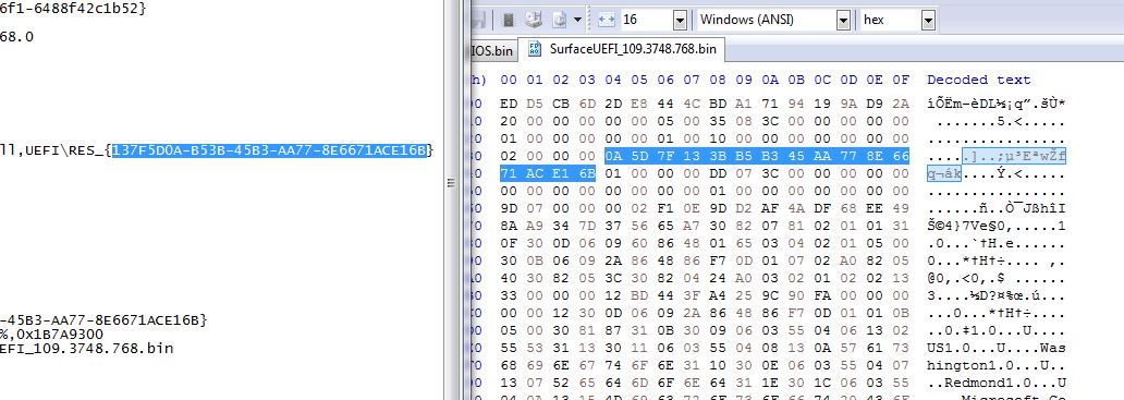

    Microsoft Surface Pro 4
    UEFI\RES_{137F5D0A-B53B-45B3-AA77-8E6671ACE16B}

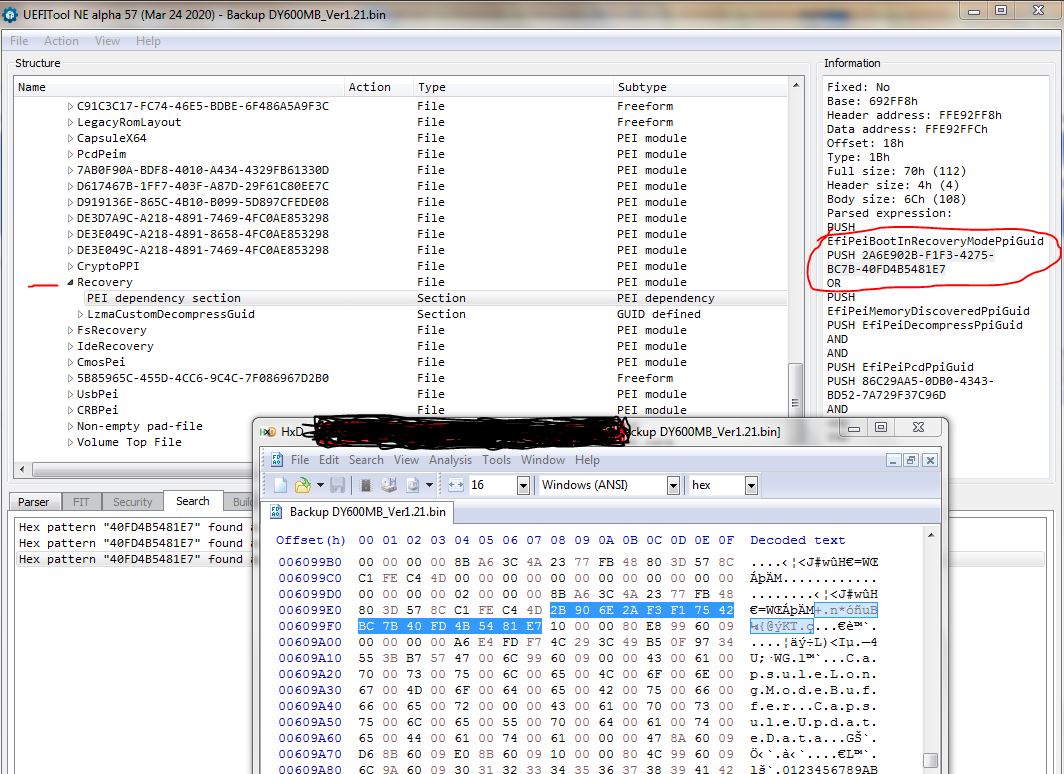

          Here's for example, i got cheap laptop from china. No brand no sticker on the case. The only code that i found on the board is DY600MB_VER1.21, i already try some methode from github. Maybe you can help find some info from the backup

            Sorry but nothing was found.
