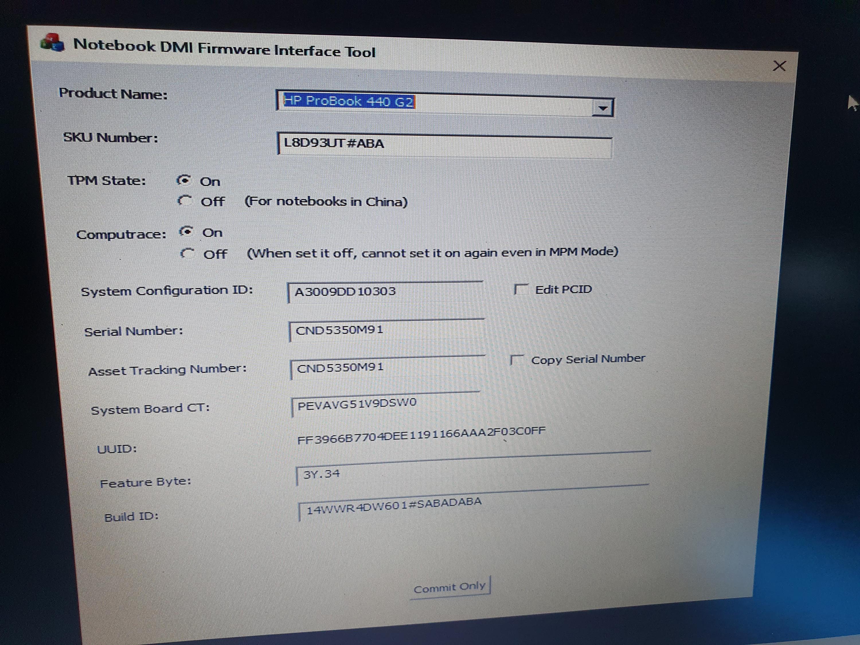

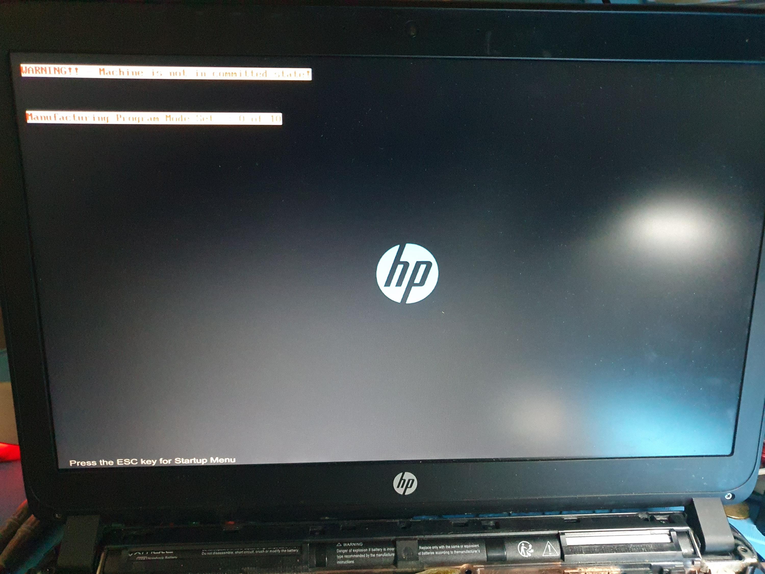

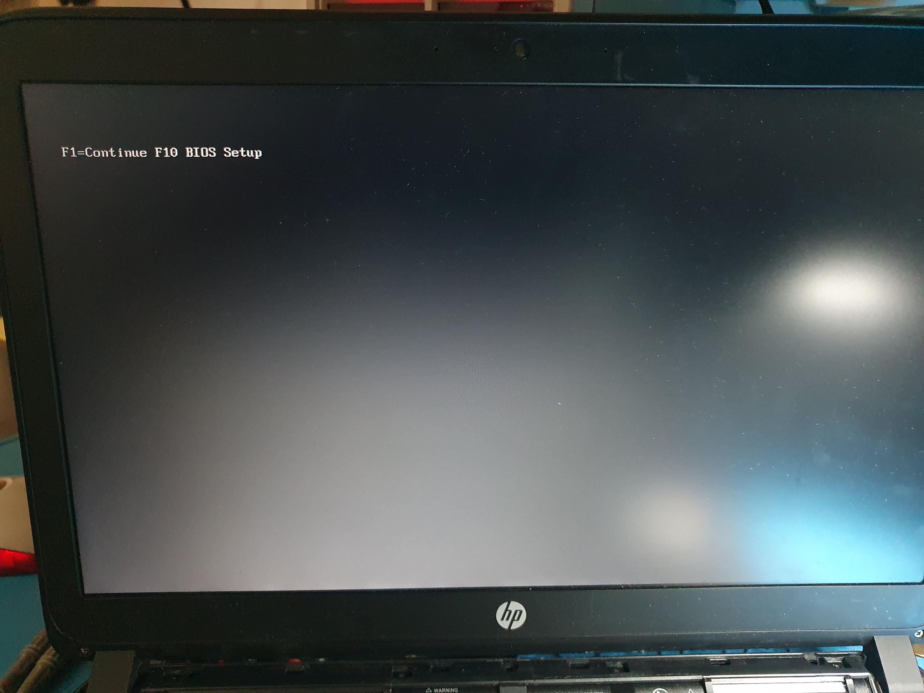

              • Fabyj
                • Feb 2014
                • 16
                • Italy
                Re: HP 450 G2 & 470 G2 Bios dump CLEAN ME ( 4th & 5th gen Intel)
                Originally posted by alfredposadas09
                clean me + bios region
                Hi Alfred, thanks for your replay. Bios is working but it show advice at startup. In any way I skipped it and boot in windows, so I edited DMI using WNDMIFIT tool (I don't know because Feature Byte change when I close and reopen this tool). Also I can't edit UUID.
                In any way pictures attached.
                How can I remove this advice on start up?
                Regards,
                Fab
