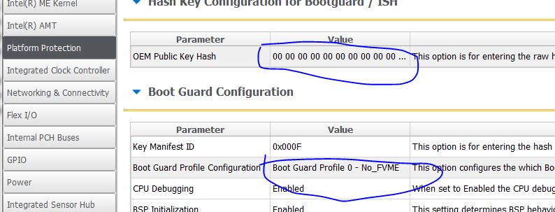

                        Rescued from what board model. If its not from a dell with bootguard 5 then disabling bootguard in the original dell bios should work.That can be done by changing the FIT settings while cleaning the ME firmware
                        • exerion5000
                          • Aug 2014
                          • 83
                          • Argentina

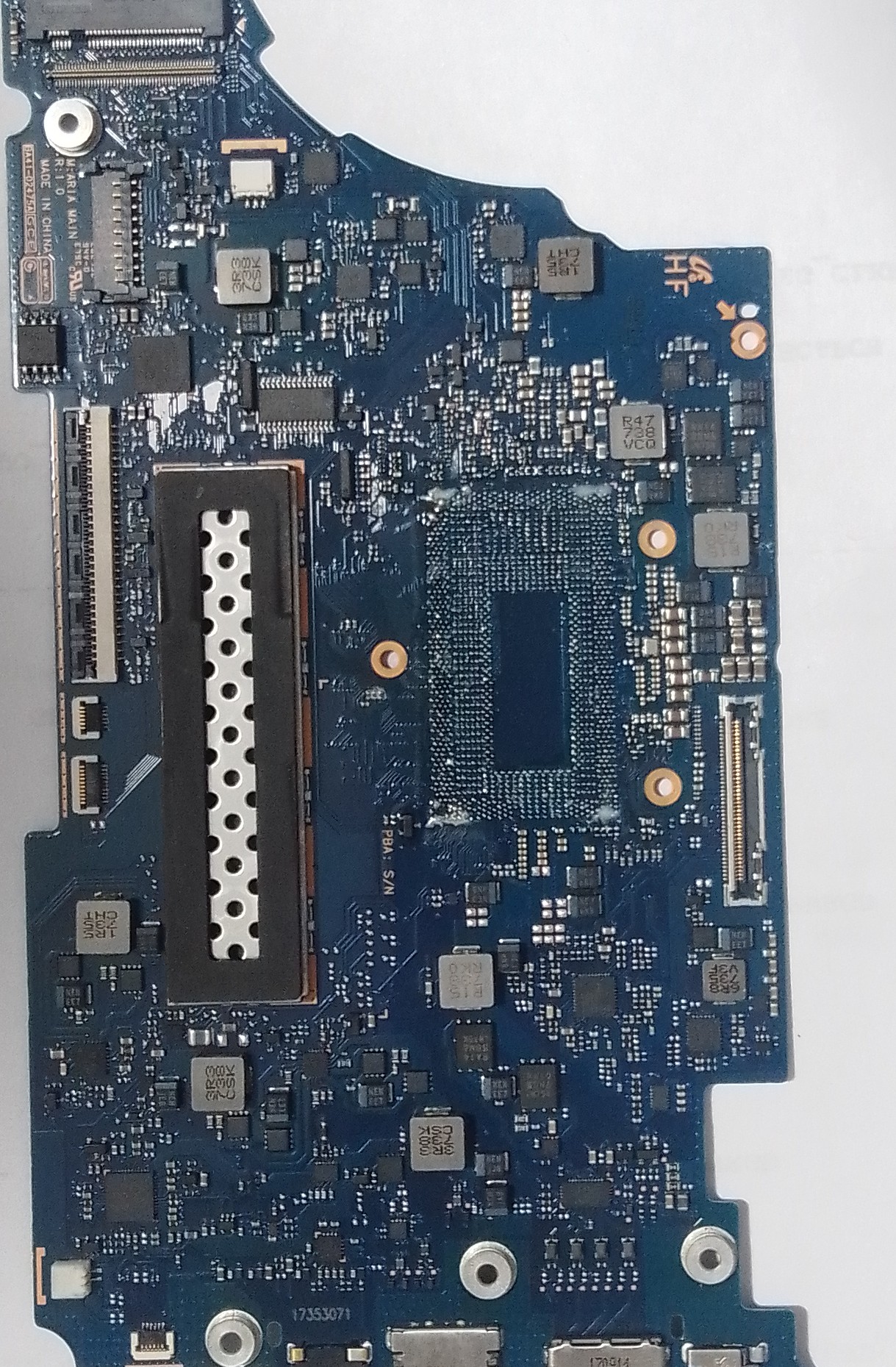

                          Re: Inspiron 15 5566 BAL60 LA_D871p bios clear me
                          Pulled from Samsung laptop board with i7-6500u
                          I try clean with 2 files generated by MEinject software but no work
                          CF25Q128AS@SOIC8_dell i3 + ME 11.8.70.3626 - 11.8.70.3626_CON_LP_C_NPDM_PRD_RGN

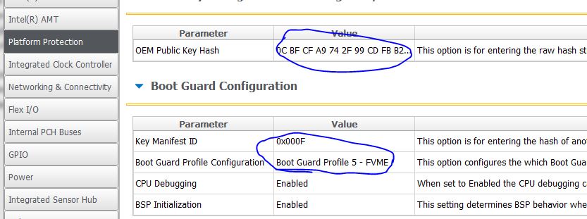

                            • 22292
                            CF25Q128AS@SOIC8_dell i3 + ME 11.8.70.3626 - 11.8.70.3626_SLM_LP_C_NPDM_PRD_EXTR
                            In fact, one of the 2 files created does not generate an image
                            Its not recommended to use MEinject, at least not with anything above version 7 ME firmware.
                            https://www.badcaps.net/forum/showpo...41&postcount=3
                            Try the attached bios. EDIT: Do NOT use this bios if you have the original dell CPU/PCH
                              Hello. After the third reboot the system starts perfectly thanks to the Magic that you did, I have a lot of skill in electronics and hardware repair but I am very lazy with the software, tell me how much I owe you for your precious time, best regards.
                                • 22292
                                I`m glad its working,you don`t owe anything,all help is given for free.Site donations are welcome but entirely optional.
                                All i did was clean the ME firmware using the guide,but i changed the bootguard profile from 5 to 0 ,and changed the OEM public key to zero`s .
