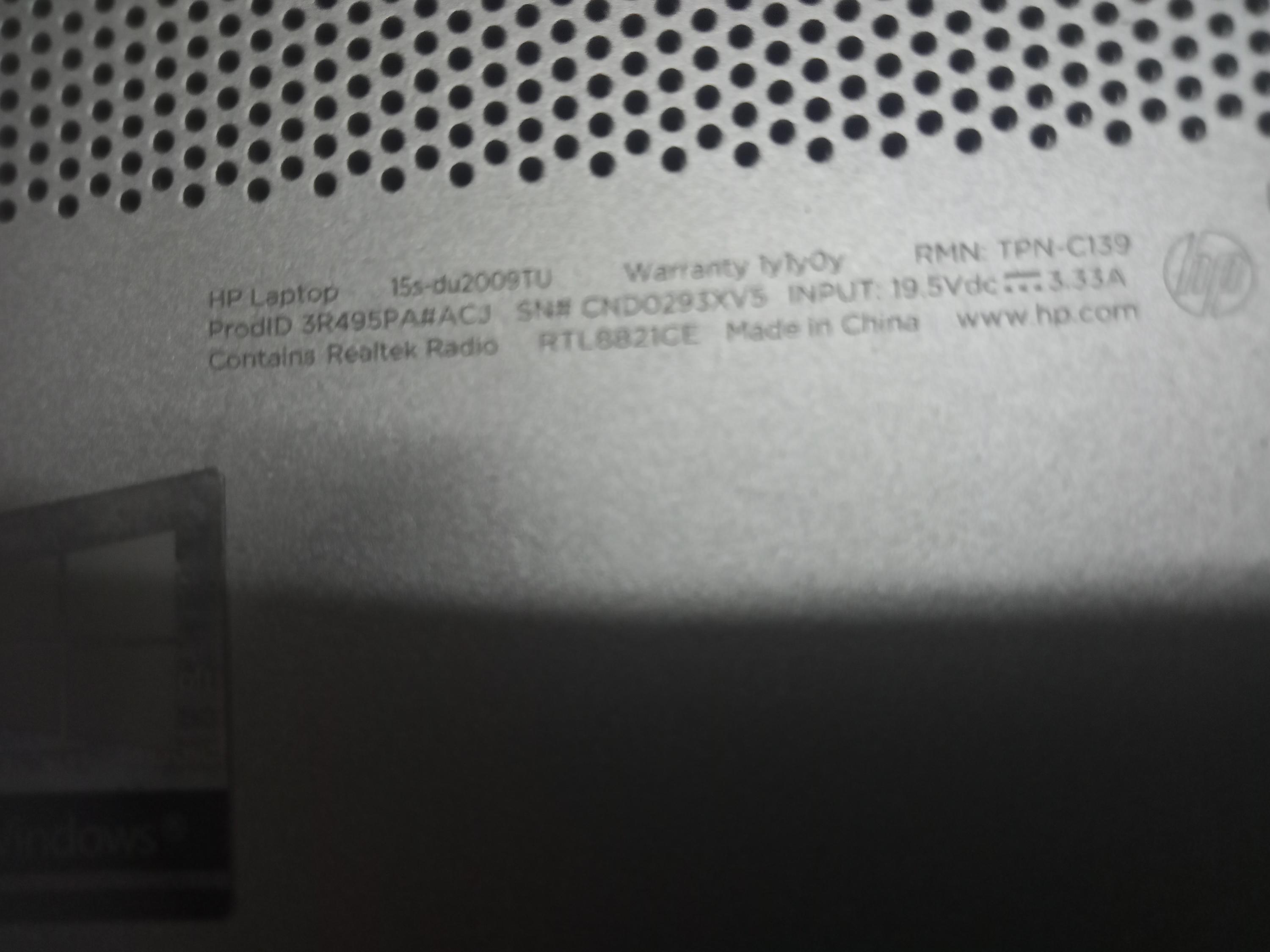

    Post the full laptop model number,service tag or serial,and your bios backup .

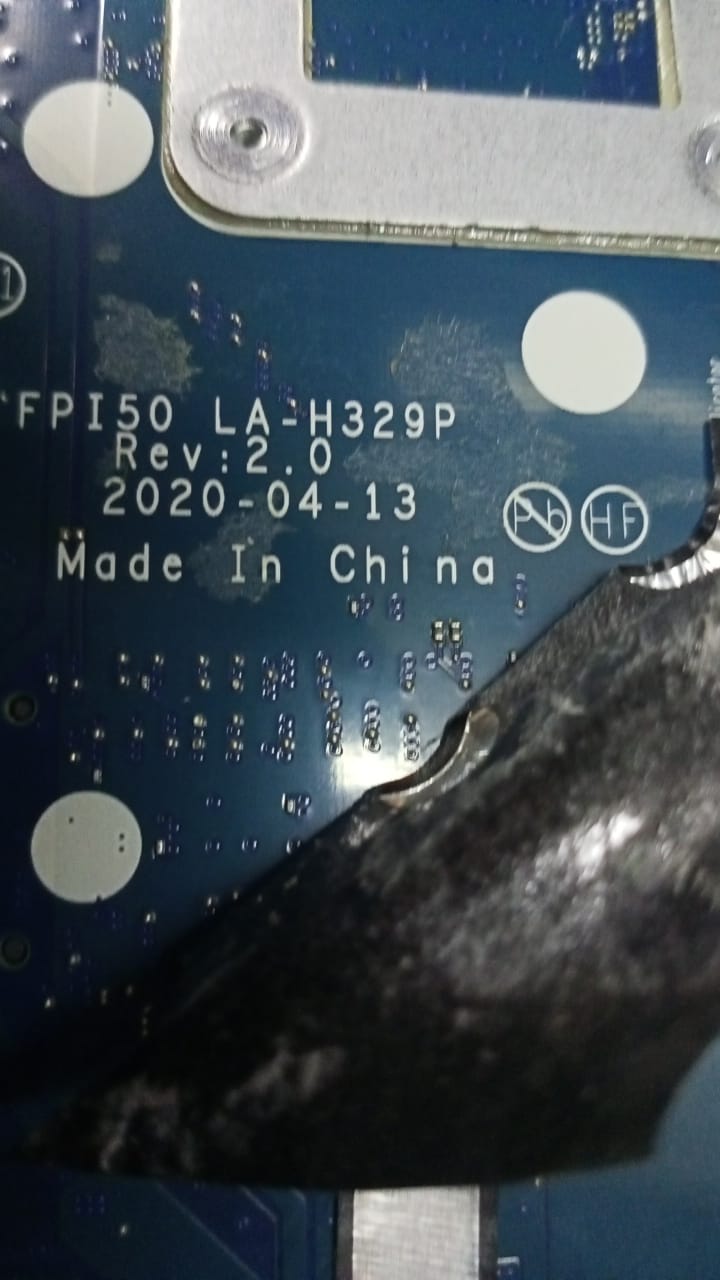

      Re: Dell fpi50 la-h329p bios dump needed help!
      I have attached the photo of mother bord and model and sorry it is hp laptop

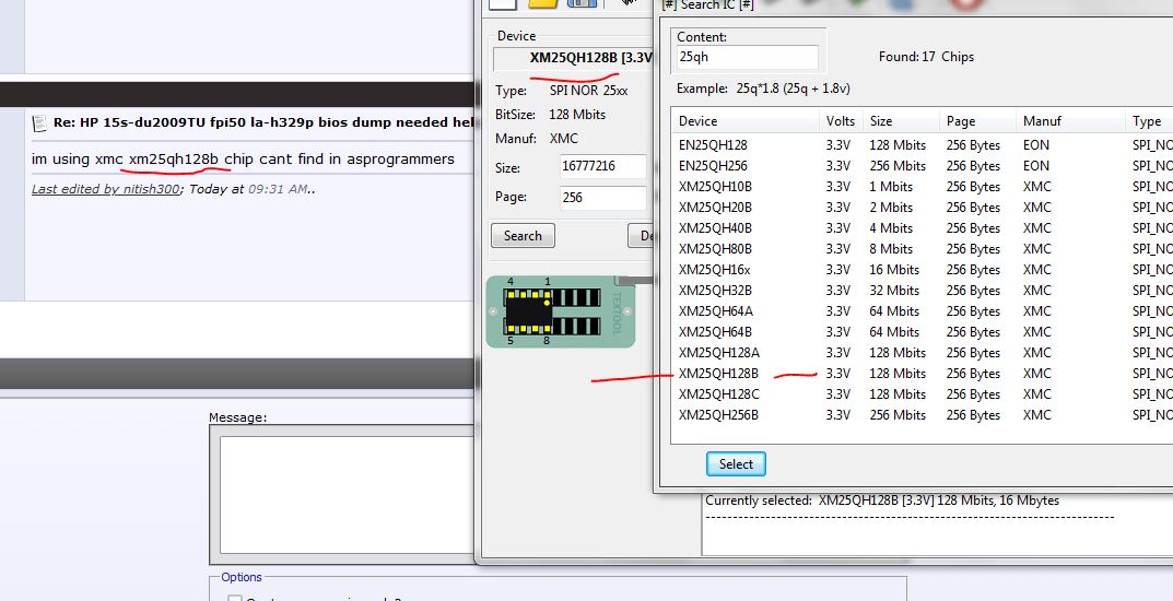

                        Re: HP 15s-du2009TU fpi50 la-h329p bios dump needed help!
                        im using xmc xm25qh128b chip cant find in asprogrammers

                          • 21836
                          Try NeoProgrammer. https://www.badcaps.net/forum/showpo...2&postcount=26 Also if you have a powered USB hub use that,or attach the charger to the laptop after attaching the clip,this will give the ch341a a bit more amperage.
                          If you have the black PCB version there`s a voltage mod you can do as well to make the programmer a bit more stable
                          https://www.badcaps.net/forum/showthread.php?t=103526
                          Quote:
                          If you have a black PCB, it is very likely that it needs to be modified for 3V operation instead of 5V. Failing to do so could damage the ROM IC.
                          Watch the instructions there:
                          https://www.youtube.com/watch?v=-ln3VIZKKaE
                          https://www.youtube.com/watch?v=HwnzzF645hA
                            I did the mod and it's working fine now but i can't find another dump of hp 15s-du2009tu fpi50 la-h329p to program bios. i used neoprogrammer it has xmc spi-nor
