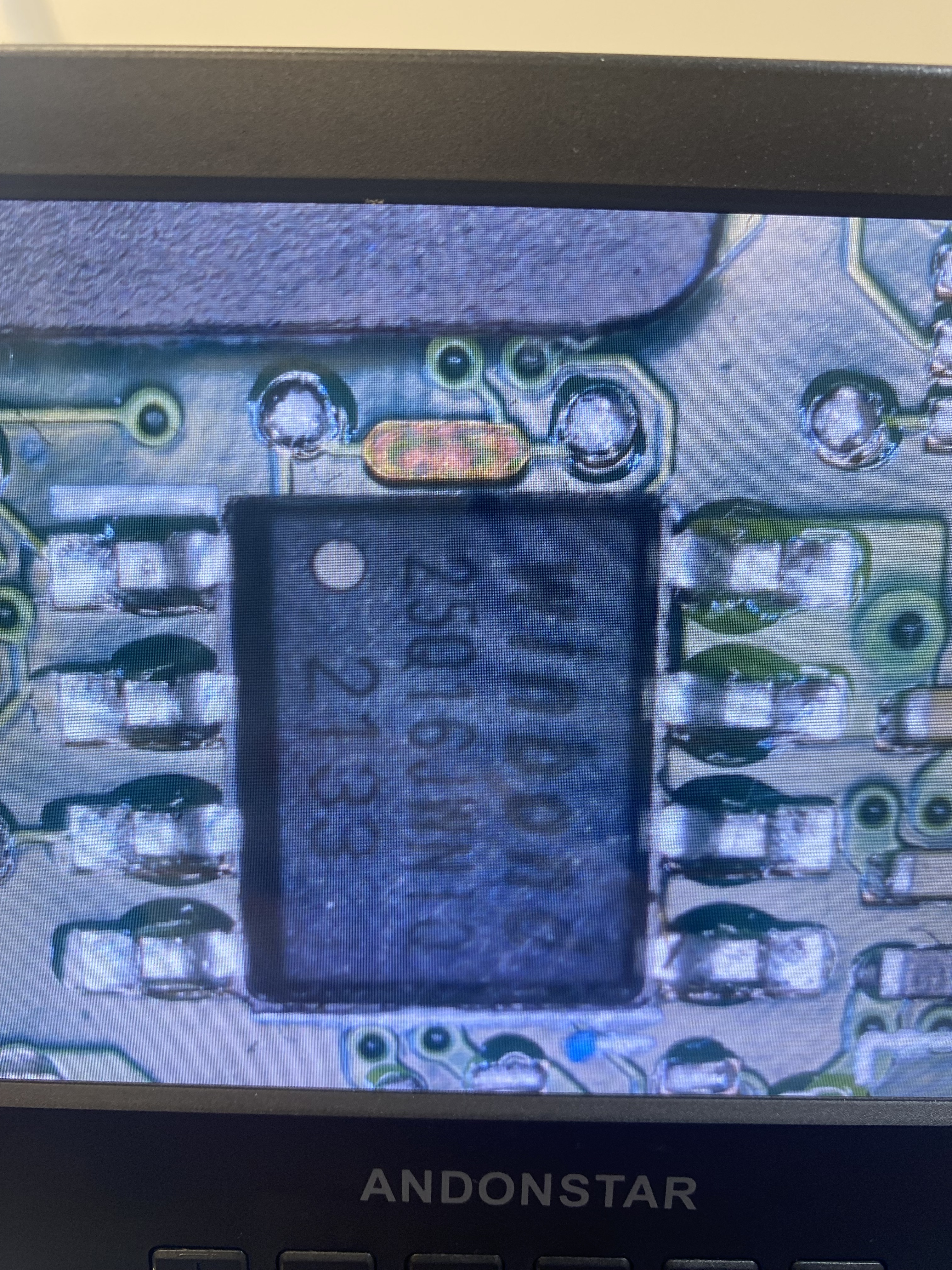

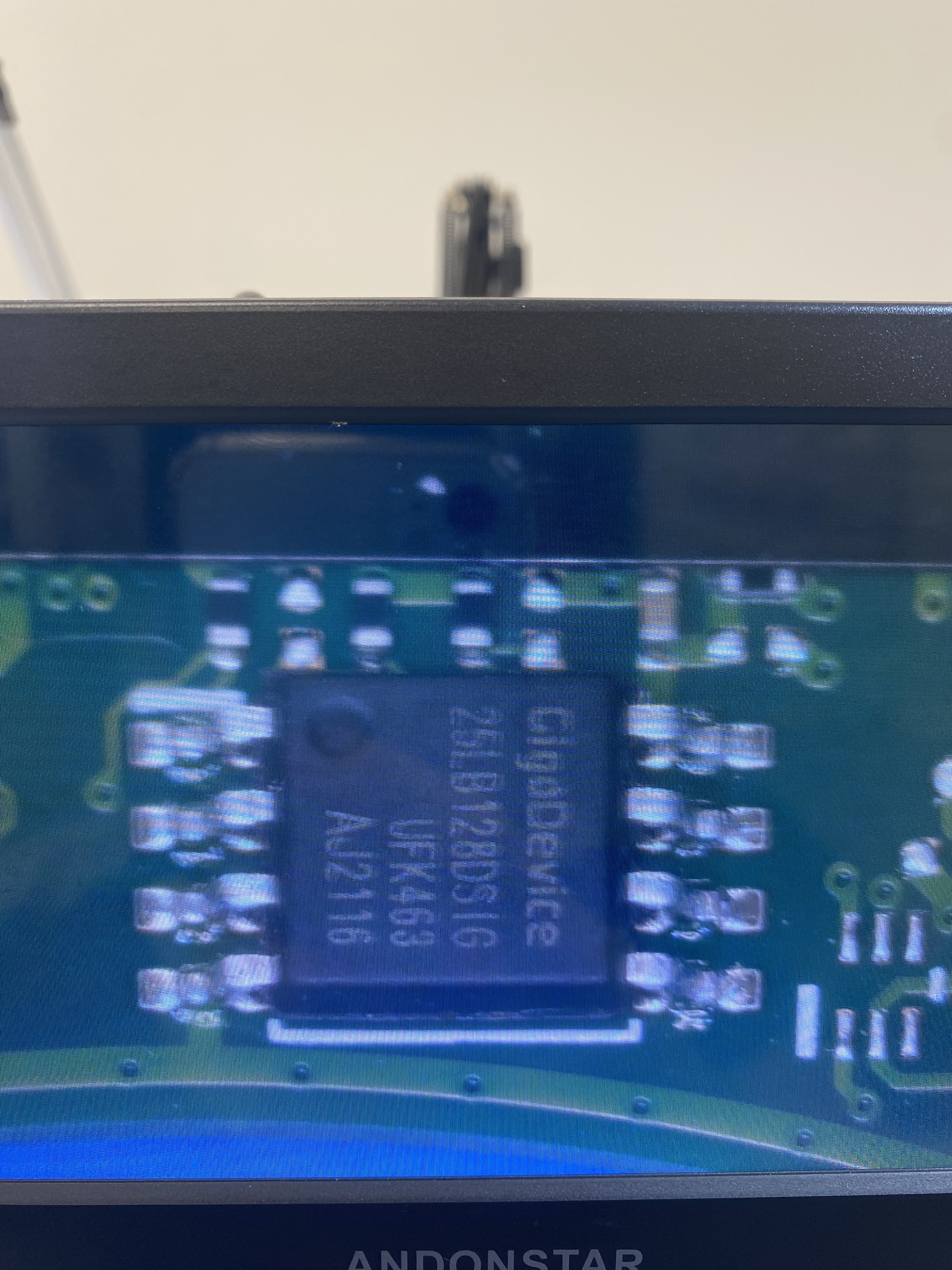

            Hey guys! Which one of these is the bios chip I need to reprogram exactly ?
            from my experience it’s usually the winbond one. But I wanna make sure.
            also, I need the correct bin file for this model.

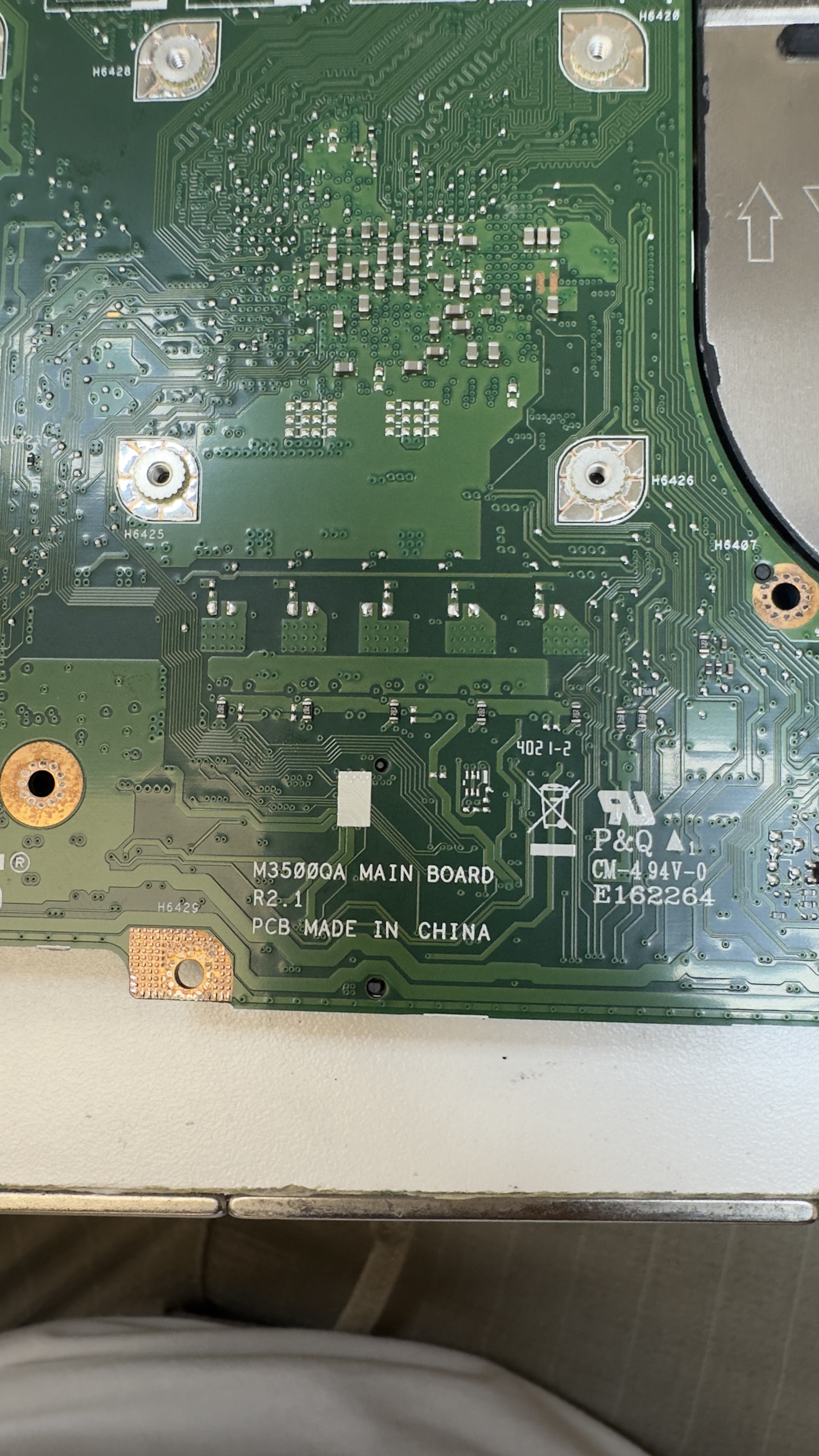

            Ryzen 5
            Board model is: M3500QA R2.1
            serial number is: MAN0CX099389417

              25LB128DSIG
              • Mehmet Korhan
                • May 2024
                • 31
                Originally posted by hoaca388
                25LB128DSIG
                Thank you! I connected it to
                my reader and it says it’s empty.
                anyone got the bin file for this?

                  Hey, so i took off the GigaDevice one you told me to remove and its an 8 MB one but the dumps on here are 16 MB. Is it the winbond chip instead?
                  attached my dump i saved.
                  • Mehmet Korhan
                    • May 2024
                    • 31
                    #29
                    WONT LET ME EDIT Sorry for the multiple posts: So I read again, it's a 1.8v chip. Had to use an adapter. Tried reading and then erasing then writing. Gives an error when verifying. I am using EZP2023+. Do I need to get another programmer? This one supports up to GD25LQ128(1.8v).The chip I have is GD25LB128DSIG.
                    Please help. I need to reprogram this asap.​

                      Does anyone have a working bios for this? Tried all the ones in the post but im not getting an image and the fans aren't spinning.
                      Charger light is on and battery light blinks every 5 secs.
                      Please help. I can't figure it out!
                      Ryzen 5
                      serial number is: MAN0CX099389417​

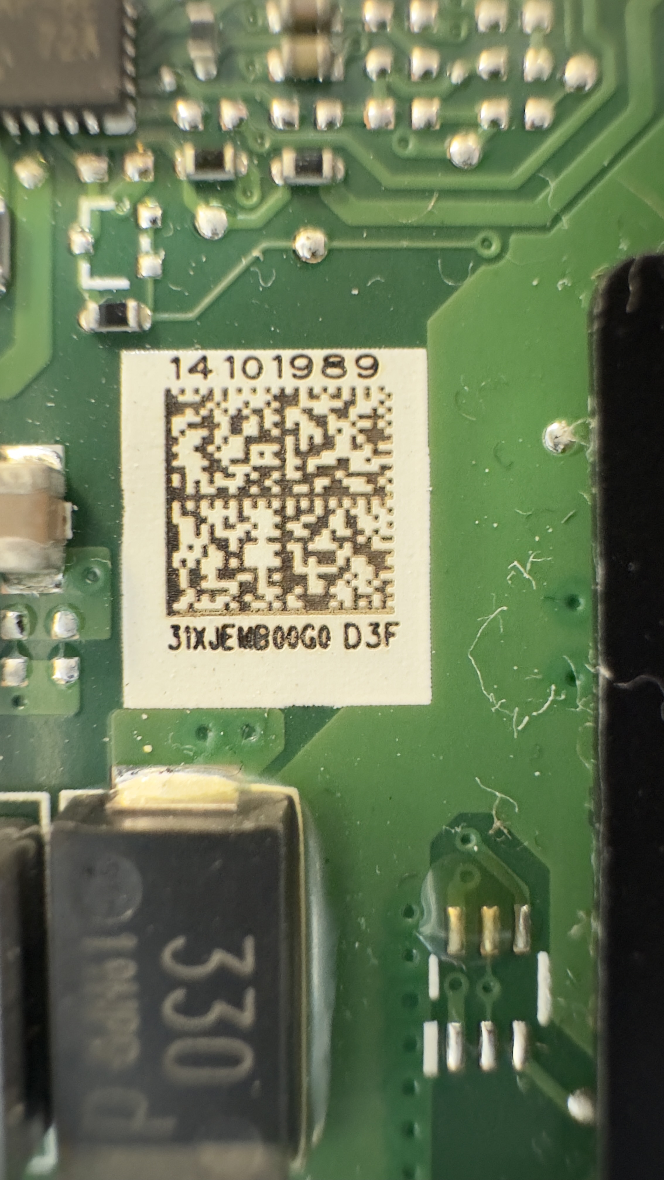

                                    Hello, I'm piggybacking on this topic
                                    I have a M3500QA R2.1 board
                                    SN MBN0CX24K511462
                                    Qrcode subtitles
                                    141100148
                                    31XJEMB0560 D3A
                                    I need a working BIOS dump, preferably with BIOS version 311
                                    I don't know why, but older versions don't work for him. One went in but the BIOS crashed later and it's still the same, I'm sending an old backup, maybe it'll be helpful.​

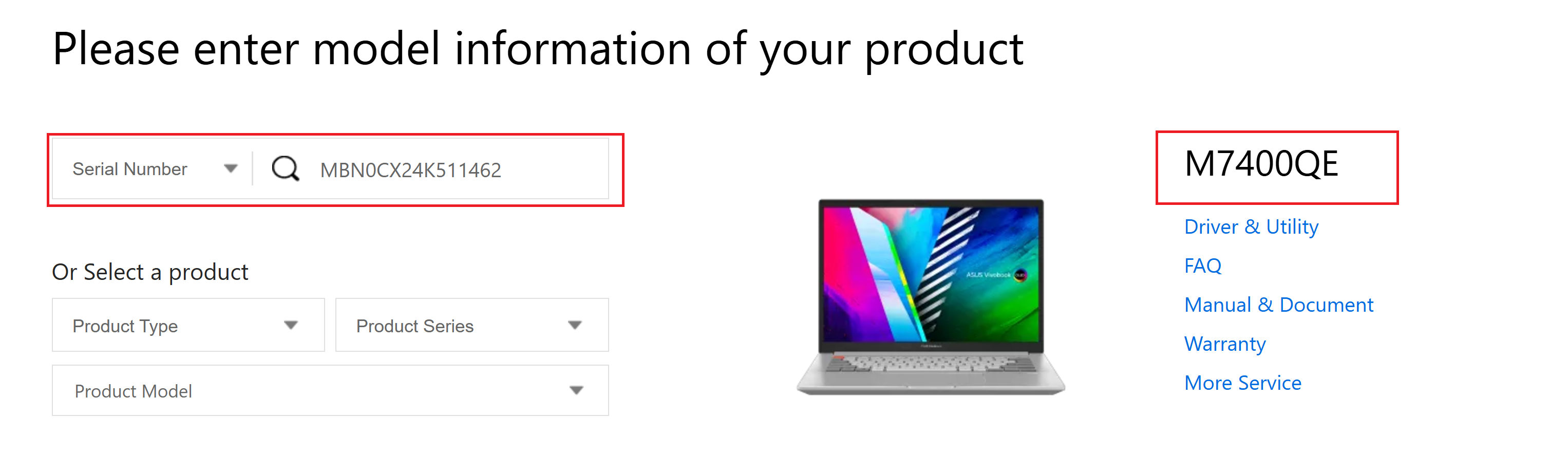

                                      I searched by serial number and got the result

                                        This is exactly the model you found in the photo on the Asus website. But the motherboard has the markings I wrote above. It turns out that it was installed in several vivobook models.

                                          ASUS Vivobook Pro 14X OLED (M7400, Dòng AMD Ryzen 5000)
