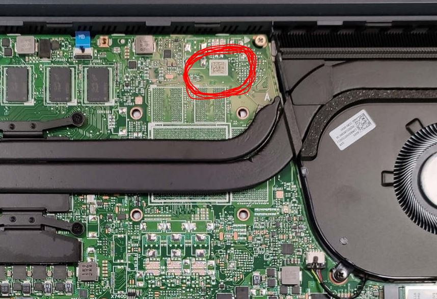

                        hallo, i have old bios asus M3500Q rev2.1 not display, can help me rebuild my old bios.
                        MODEL : M3500Q
                        SN: N3N0CX23A578128
                        • qayyum786
                          • Aug 2018
                          • 1933
                          • INDIA
                          MODEL : M3500Q
                          SN: N3N0CX23A578128
                          Try
                          • notrespond
                            • Apr 2024
                            • 66
                            • ID
                            Originally posted by qayyum786
                            Try
                            this work, buat SN: N/A
                              • 21180
                              DMI 21000 - 30FFF .Copy from your backup using a hex editor.

                                Hello i need help for a working bios for Asus vivobook 14. attached extracted bios from the board.
                                Details:
                                CPU : Ryzen 7 5800H GPU : RTX3050
                                Model: M3401QC-KP069W
                                SN: N7N0CXCZR04J28E
                                Motherboard model : M3500QA R2.1
                                Problem: Black screen whit white led on power and white led blinking on battery, also fan spin normal and cpu heated.
                                Thank you!​
                                  SMDFlea commented
                                  Editing a comment
                                  thread merged
                                • 21180
                                Details:
                                SN: N7N0CXCZR04J28E
                                Thank you!​
                                Bios + DMI
                                • AtelierRepa
