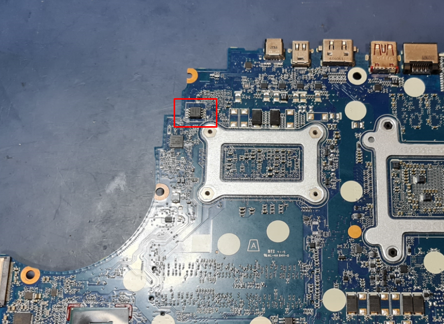

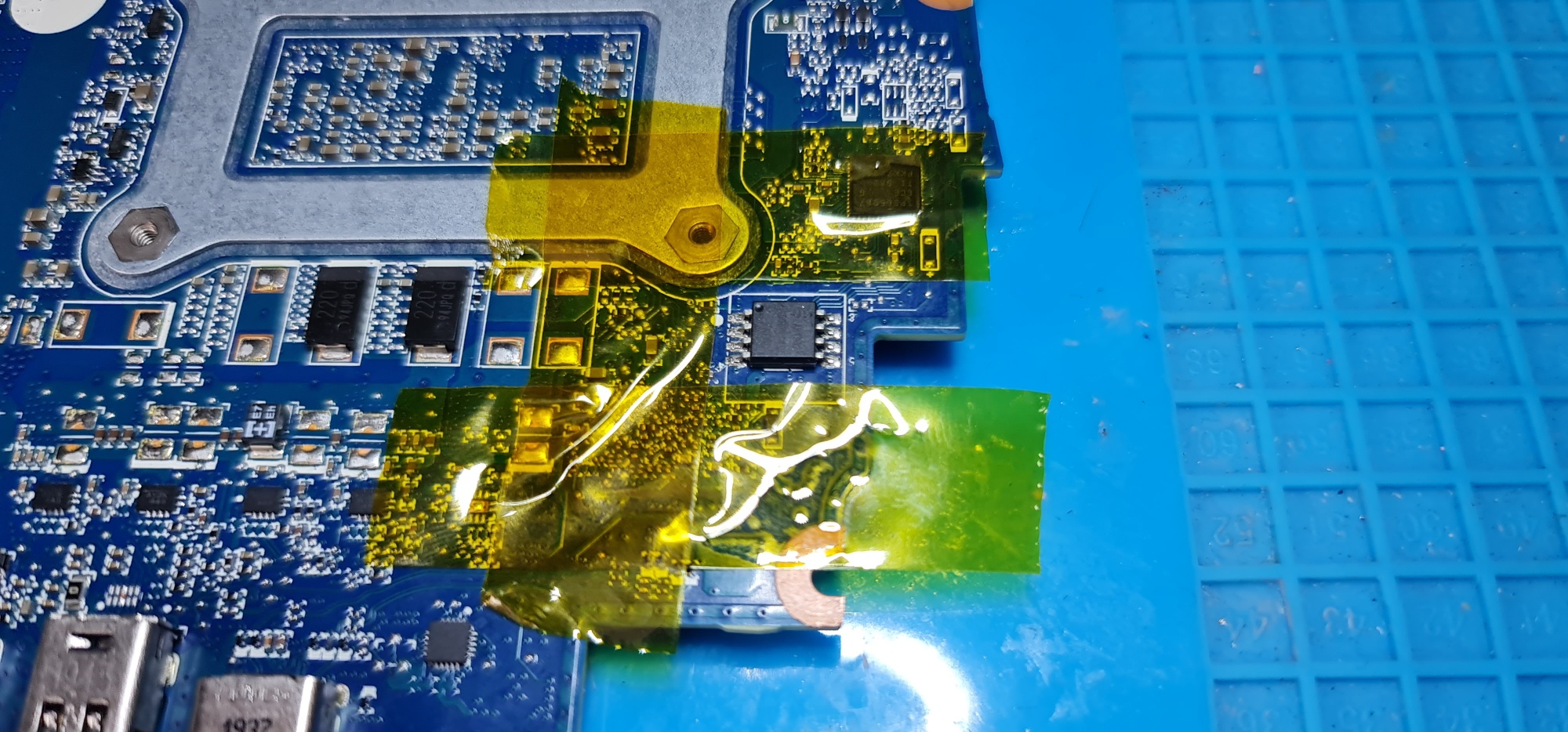

          Re: HP omen 15-do1023na Bios needed
          Post the picture of 2 sides of the motherboard (high resolution)

            • Mike23
              • Oct 2019
              • 9
              • united
              Done, as good as possible.

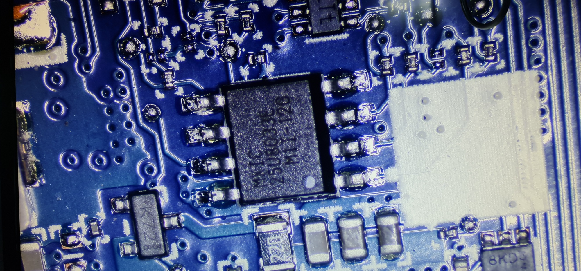

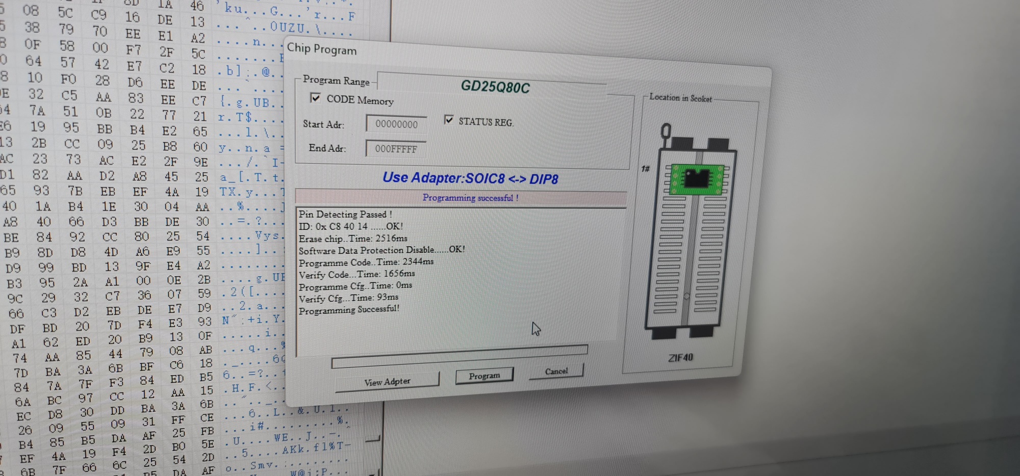

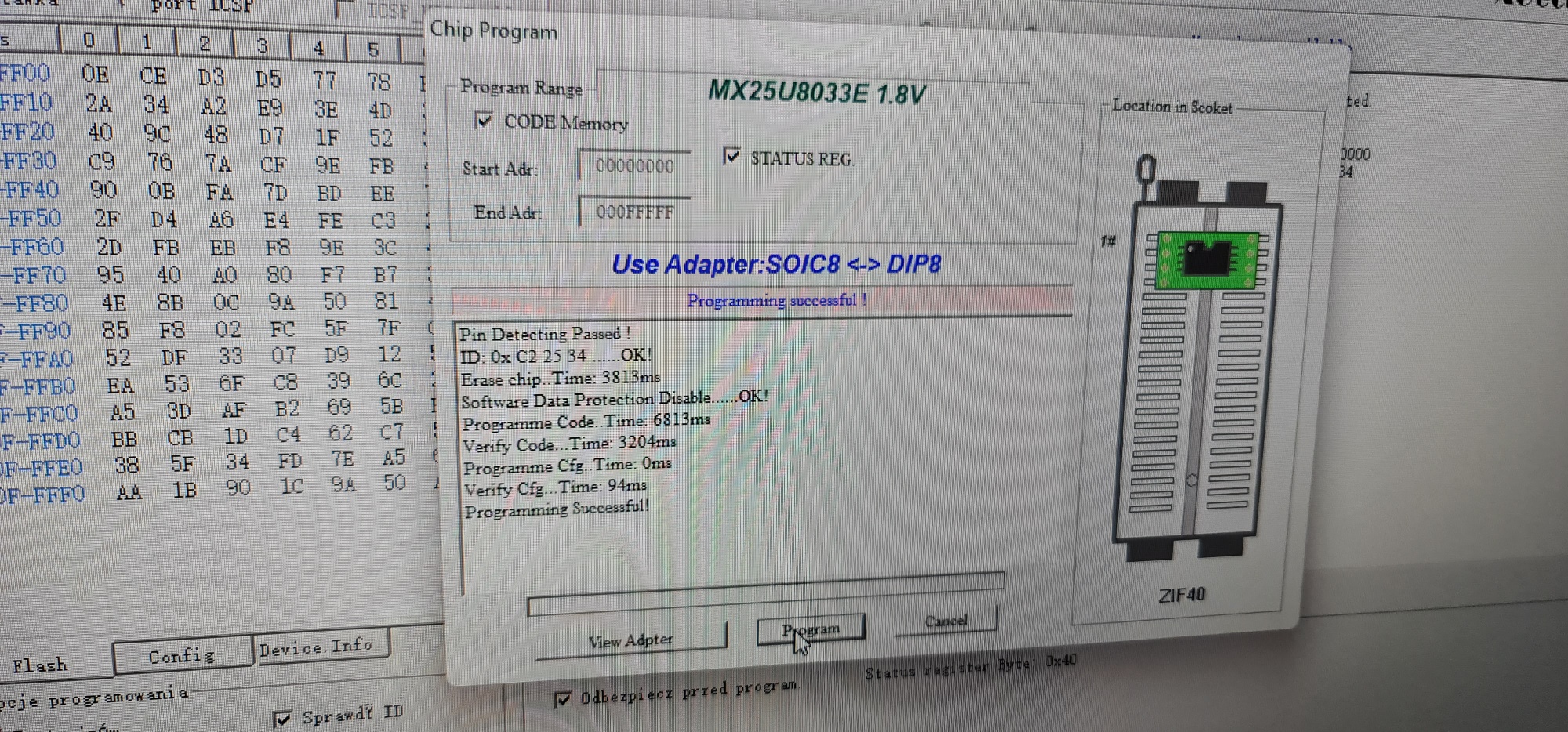

                      Re: HP omen 15-do1023na DAG3DCMBCC0 Bios needed
                      Originally posted by DanielDacko
                      So far no luck.
                      I reprogrammed MXIC to original data.
                      Then programmed giga Bios chip, however i noticed that both chips are 1mb chips, looks quite bizzare...
                      same story and again caps lock flashing 5long and 3short
                      any help appreciated

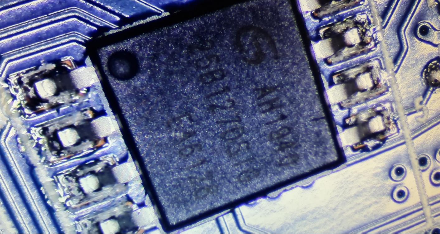

                          • 21679
                          You are very confused and probably using crappy ch341 programmer.
                          The screenshot is a TL866 programmer software. The 1MB chip is firmware for something.
                          Keep looking for another chip,it might be a WSON8 type, with no legs.Post your backup once youve found it,your backup will have your DMI info,it can be copied to a new bios easily with a hex editor,it will save having to use HP`s crappy DMI tools.

                                • Mike23
                                  • Oct 2019
                                  • 9
                                  • united
                                  This is his screenshot, he found the chip already.
                                  Thats correct, finaly i found a BIOS chip! 16384KB
                                  reprogrammed with bios from HP website and unfortunately no change. caps lock still flashing.
