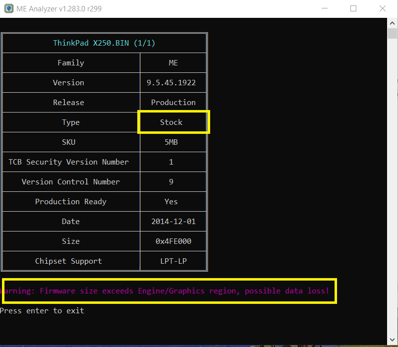

        help !!lenova x250 bios
        can you help with bios
        VİUX1 NM-A091
        REV:1.0
        ID NO:59F0C7
        MODEL NO:CS13XBL-84D0
        PART NO:0C43994
        FRU NO: 04X0189

          Re: Bios NM-A091 rev 1.0
          thank you fridens
          but it doesn't work
          • hoaca388
            Badcaps
            • Jan 2022
            • 11736
            Originally posted by sezsizada
            thank you fridens
            but it doesn't work
            You deleted ME with the wrong method.
            • sezsizada
              • Aug 2015
              • 35
              • turkey
              thank yuo hoaca
              but black screen :ah:
              • hoaca388
                Badcaps
                • Jan 2022
                • 11736
                thank yuo hoaca
                Try bios file at #2.
                • sezsizada
                  • Aug 2015
                  • 35
                  • turkey
                  I've tried
                  black screen
