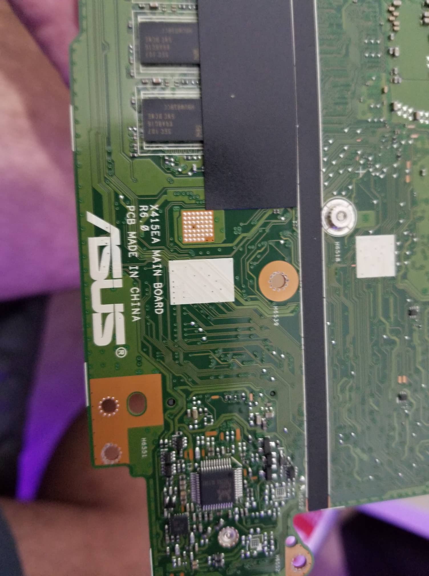

    Hi, Please help me with my laptop, I have this ASUS X515 that has BIOS password. I try to flash with BIOS X415EA Rev 2.0 but the keyboard wont work.
    Then I try to flash with X515EA , the keyboard works but SSD wont detect
    Is there any correct bios file for my unit? The Model is Asus X515EA on the sticker and X415EA R6.0 printed on the motherboard.. please see the attached image
    The attached Bios bin was the original BIOS but has a Password..
    Thank you

    Re: ASUS X515EA - X415EA Rev 6.0 Bios Bin
    https://www.badcaps.net/forum/showpo...73&postcount=5
      i already tried this.. but SSD wont work its not detecting any SSD / M.2
        Try
          • 21137
          The part number on the QR code is X515EA ,thats the bios version you need .
          • Exclikers
            • Mar 2016
            • 8
            • philippines
            Originally posted by hoaca388
            Try
            sheeesh.. this one works.... Thanks Man ...
                      got one with bios password also.. i attached my backup...
                      btw, i tried the file posted by "hoaca388" and it works but the M.2 SSD can't be detected when reinstalling OS.
                        Here's your Unlocked BIOS, give it a try.
                            with your file, no more password on bios but the M.2 SSD still can't be detected when reinstalling Windows OS (win10 and win11) but the M.2 SSD is detected at bios setup. i tried already updating the bios version to 310.. and when the M.2 SSD is being transferred to another unit i can install both OS version.
                              This might be helpful:
                              Originally posted by Intel
                              Intel® RST storage driver supporting Intel 11th generation platforms and later is not yet available inbox with the operating system. Due to this, the driver must be installed during the installation process to recognize drives that are being managed by Intel® RST on the affected platforms.
                              [Notebook/AIO] Troubleshooting - How to fix the problem that cannot find drives when installing Windows 11/10

                              • salawayon
                                • Nov 2012
                                • 575
                                • philippines
                                thank you so much. it does really help. i'm now installing win11 OS..
