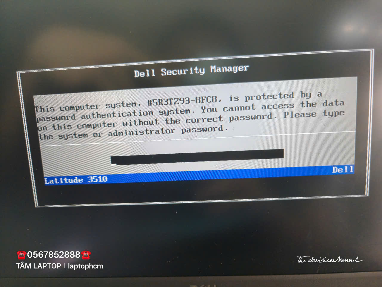

                                      #158
                                      Hello admin, please help me with the password
                                      Dell latitude 3510 :ST 5R3TZ93
                                      MAIN CODE: 19746-1 thank admin

                                        #159
                                        3.4. Dell
                                        Dell laptops store the password in EC. However, some generators exist depending on the code suffix.
                                        See: https://beta.bios-pw.org/ .If the website is offline try: https://web.archive.org/web/*/https://bios-pw.org/
                                        Note: All passwords must be entered with a US QWERTY Keyboard,you can use a USB one.
                                        Note: The 6FF1 suffix has a bug,use your service tag with the 1F5A or BF97 suffix instead,Example: 1234ABC-BF97 .
                                        Note: The list of examples does not include some other suffix codes that do work,such as E7A8 .
                                        Note: If the BF97 suffix does not work try it with the E7A8 suffix instead.
                                        Note: There is no publicly available 8FC8 generator available at the moment.
                                        The CTRL-ENTER-ENTER keystroke after the password only applied to laptops with a suffix (xxxxxxx-8FC8 for example), until Dell also required it in some laptops using System Disable 16-Hex algorithm, on which only the Password+ENTER was needed at first and then in some models you needed the CTRL-ENTER-ENTER to properly delete the system passwords, otherwise the password would remain SET upon the automatic system reboot if just doing Password+ENTER until the proper CTRL-ENTER-ENTER keystroke was performed in certain models.
                                        8FC8 Patcher software: https://www.badcaps.net/forum/troubl...l-8fc8-patcher
