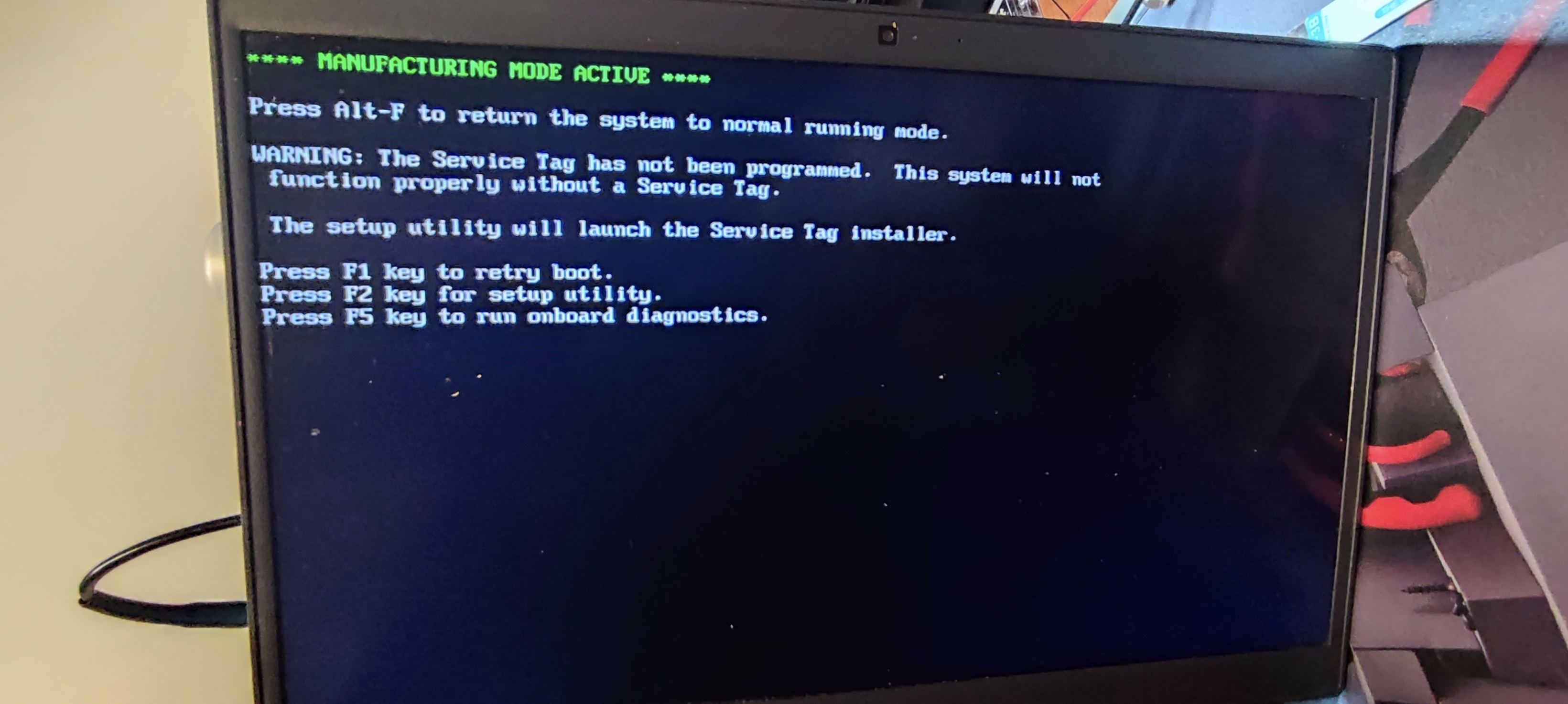

                    #129
                    Hi there!
                    My dell latitude 3510 died, burnt chipset, so i bought a new mainboard, the laptop seems to works ok with the new mainboard but the problem that im facing is: the manufacturing mode active press ALT+F , the warning message is The service tag has not been programmed, so i tried to add the original tag of my laptop in the new mainboard throught the bios setup with no luck.
                    Click image for larger version  Name:	1743223433311.jpg Views:	0 Size:	968.8 KB ID:	3603500

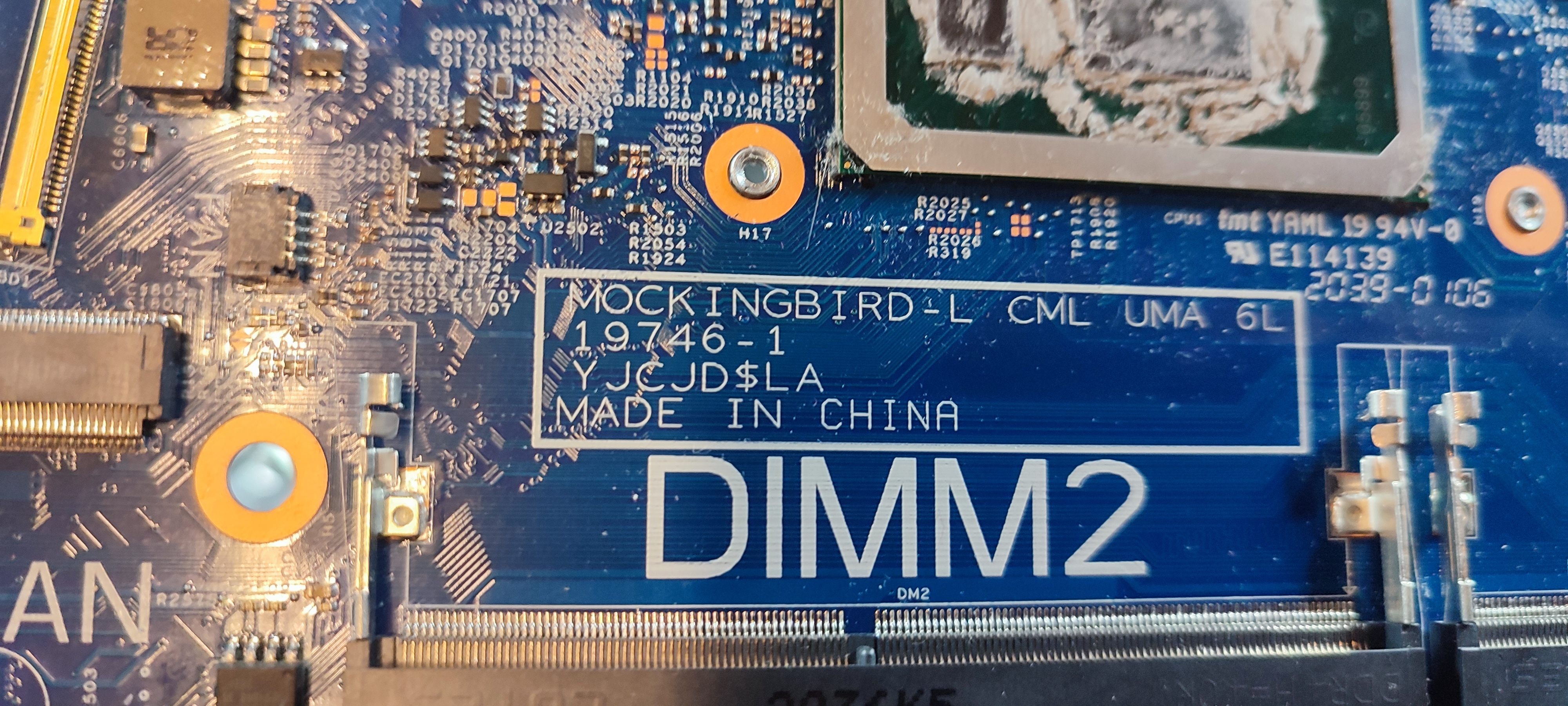

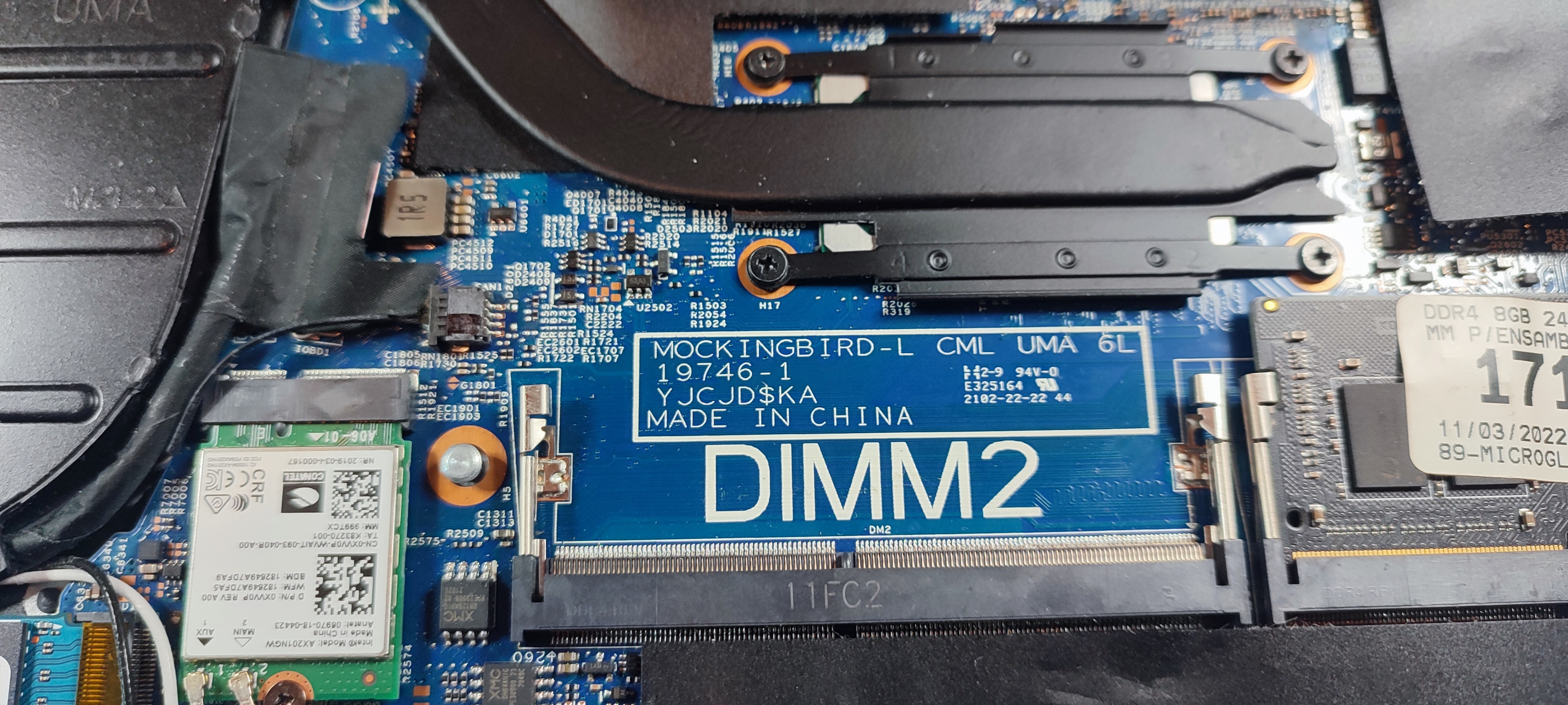

                    OLD (burnt) mainboard data:
                    MOCKINGBIRD-L CML UMA 6L
                    19746-1
                    YJCJD$LA
                    NEW Mainboard data:
                    19746-1
                    YJCJD$KA
                    The Service Tag of my laptop is 633B863, the Service Tag of the new mainboard is unknown.
                    I was thinking to dump the original bios on the new mainboard, but i think it could be a bad idea.
                    I dumped both bios bin files from the old burnt mainbard and from the new one, if anyone could help me with this will be most apreciated
