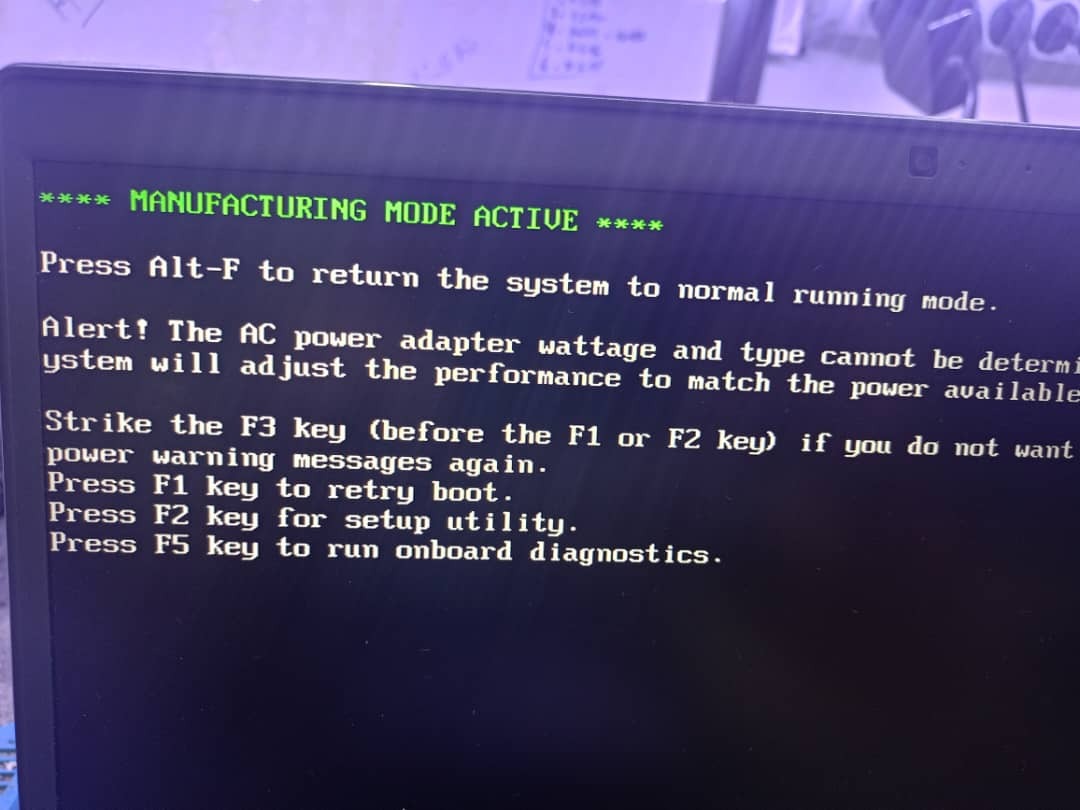

            dell latitude3510
            ST: HDPT963
            plz halp me this broblem
            clear me not work
            service tag press alt-f not work​

              Originally posted by CornholioGSM
              Re: Dell latitude 3510 (Mockingbird-L 19746-1) bios needed
              i have still problem of two same laptops - still no service tag manufacturing mode.
              ...tested 1st boot - bios setup, disabled absolute, stag filled , saved reboot.
              ...2nd boot alt+f doesnt not work because because stag is again missing
              What now?
              Will be possible to write service tag manually in hexedit?
              Thank You
              Hello everyone
              I use this dump to flash both 16mb and 8mb bios for laptop that have no display ... now it is ok and working but in manufacture mode,
              I tried to enter the service tag in bios but it's not saved !!!!
              the problem is that I deleted the original bios dump
              any help or suggestion please? can inject the service tag in the working dump here?
              Dell latitude 3510
              ST/1H1R4B3
              MKB-L14 CML UMA
              19746-2
              YJCJD$JB​

                  try

                      thank you work for me

                        Originally posted by danito
                        try
                        Thank you its work and now accept to add the ST
                          try
                          working Thanks
