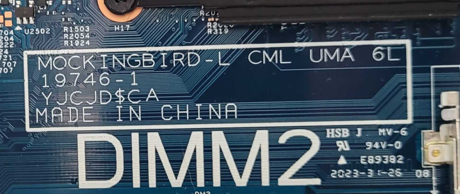

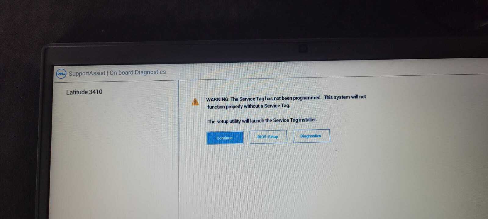

    Hello
    Thanks for help me guys, but not work. The same error persists when trying to save the service tag.
    Originally posted by farouk_1994
    mothrboard number ??
    I upload some pics, it is the number?

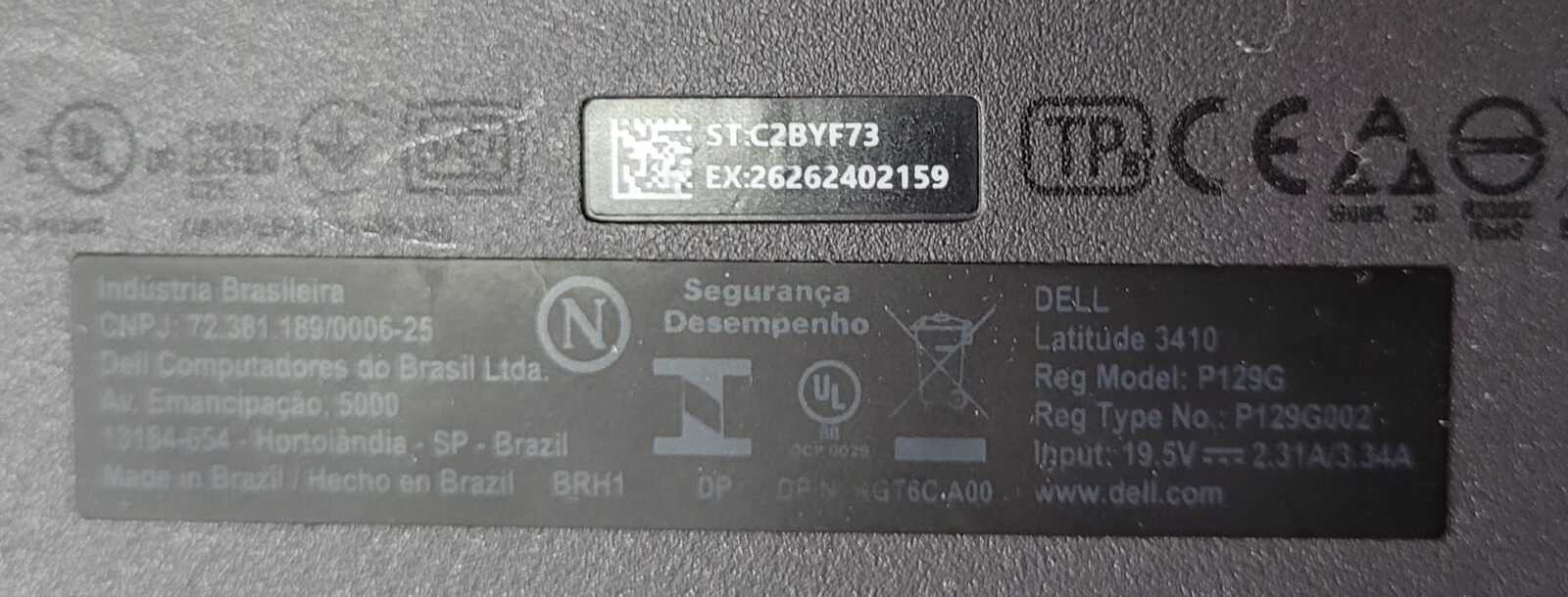

      #42
      Originally posted by robertopastel
      Hello
      Add Service Tag Manually From Maintenance Tab
      Try a new one as per your Service Tag: C2BYF73 as per your BIOS VIRSION 1.3.0
      • robertopastel
        • May 2022
        • 8
        • Brazil
        #43
        OMG, it's work 100%. 🤗 Many thanks qayyum786 and the others guys who helped me. If you know any tutorial how about edit hex like this problem, I appreciate.

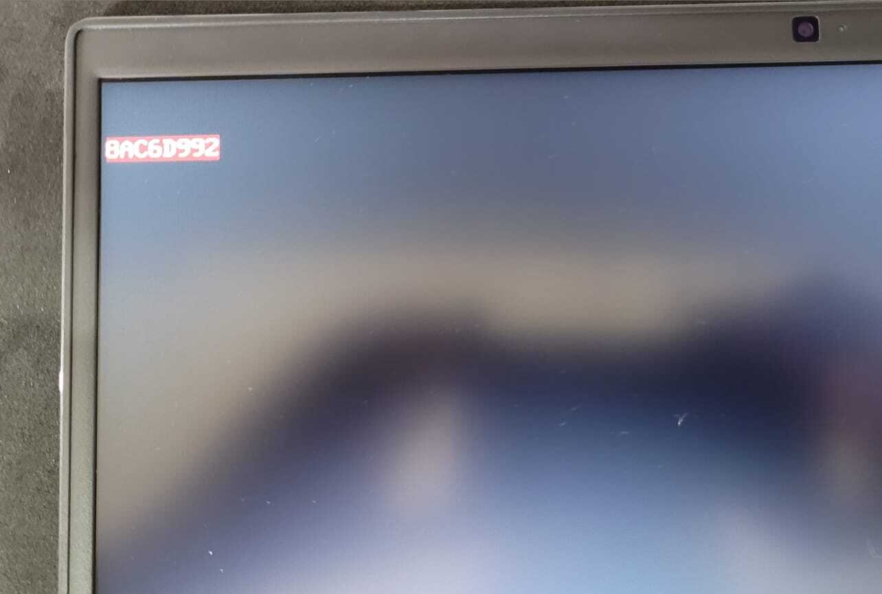

            I have a Dell 3510 with admin password blocking boot sequence. Hopefully, I copied the bios on both chips correctly and if someone here can help me remove the password it will be very much appreciated by my son who needs a laptop for school.
            thanks.
            ST: 9JZ1Q93
            • qayyum786
              • Aug 2018
              • 1958
              • INDIA
              #46
              try
              • minhdigital
                • Nov 2022
                • 764
                • Vietnam
                #47
                thanks.
                ST: 9JZ1Q93
                Send to you
