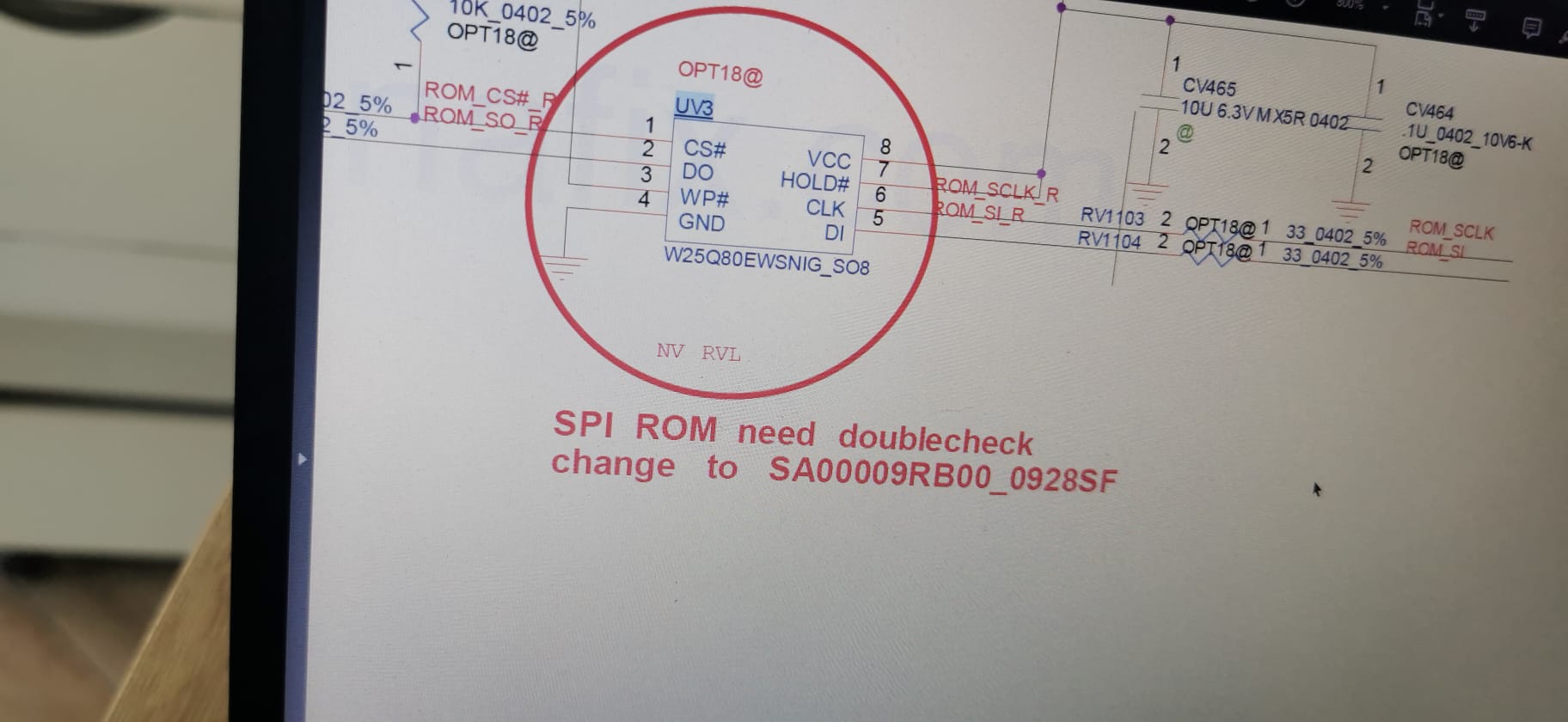

          Hi!
          Can somebody help me reading content of SPI ROM chip for my laptop?
          The technician told me, that the bios is good, but in meantime we lost the original content of Super IO chip witch is in the other side of motherBoard.
          He told me, that it would help, if I could get the same version of my laptop from somebody and read the content of that chip, but I found no one in my region.
          The laptop powers on, but does not boot, power button blinks.
          Lenovo IdeaPad L340-17IRH Gaming
          Model Name: 81LL
          SN: PF1TB56 MTM: 81LL00CYGE
          Mfg Date 2020/10/17 Factory ID. JVHFC1
          MO: PE9XB0A17136
          MotherBoard: NM-C361 rev 1.0
          Thanks!

            you have everything you need at post #6...
