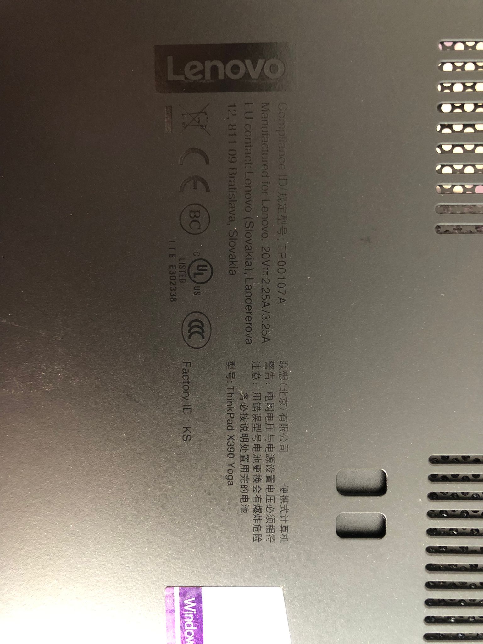

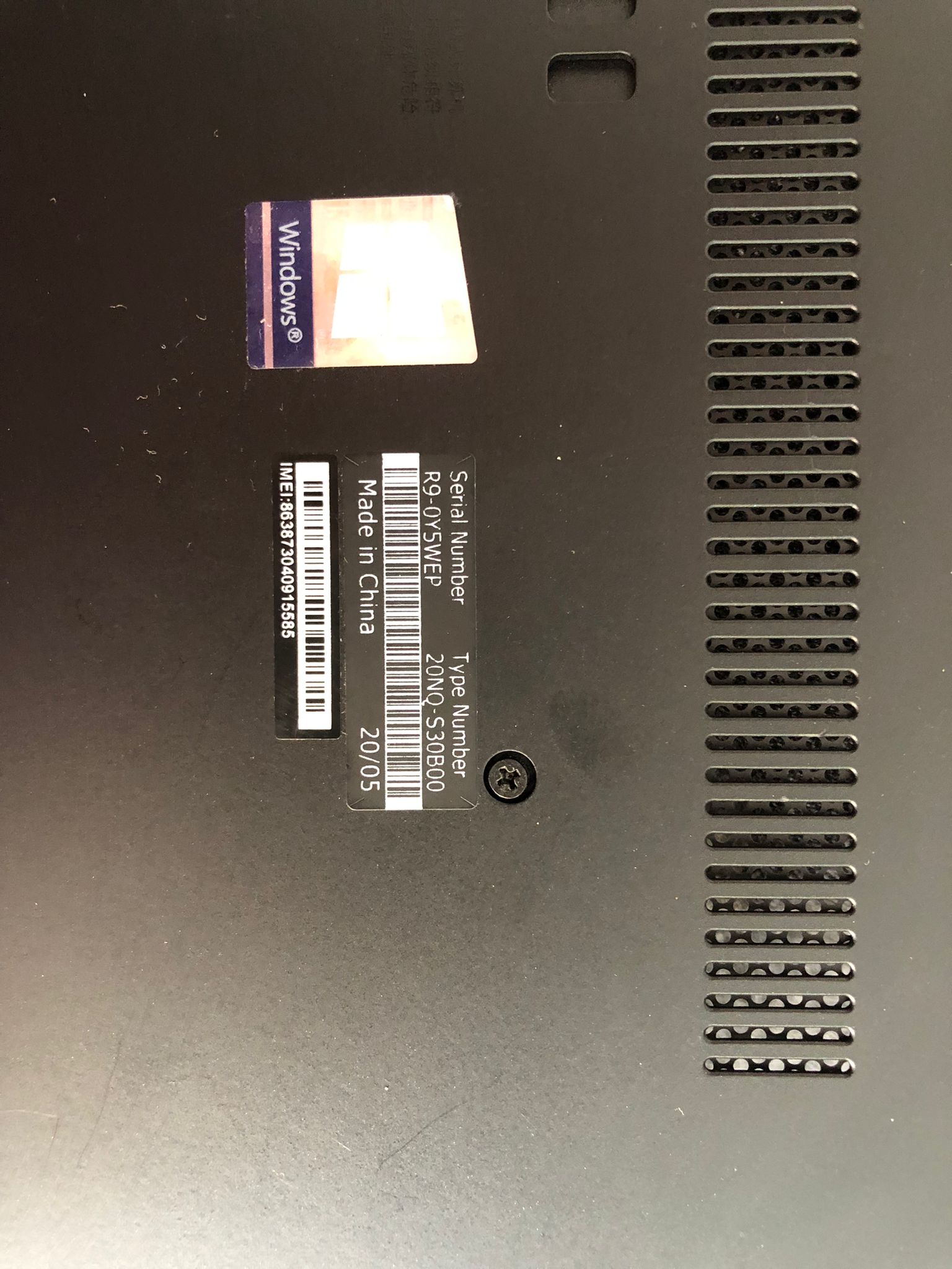

      This is the original bios I red with vertyanov programmer. The laptop is Lenovo thinkpad x390 yoga TP00107A, with a NUVOTON embeded controller, NPCE388.

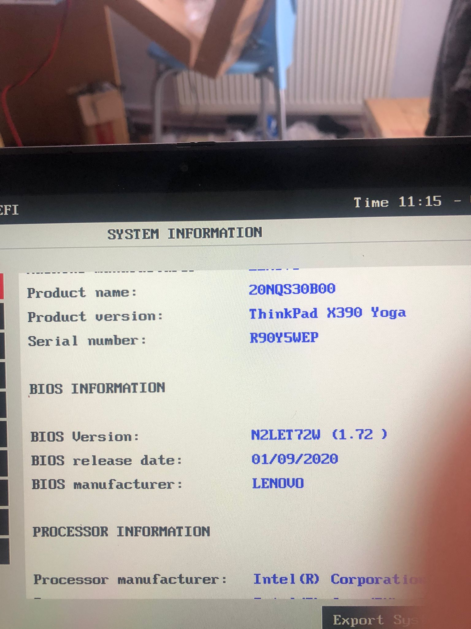

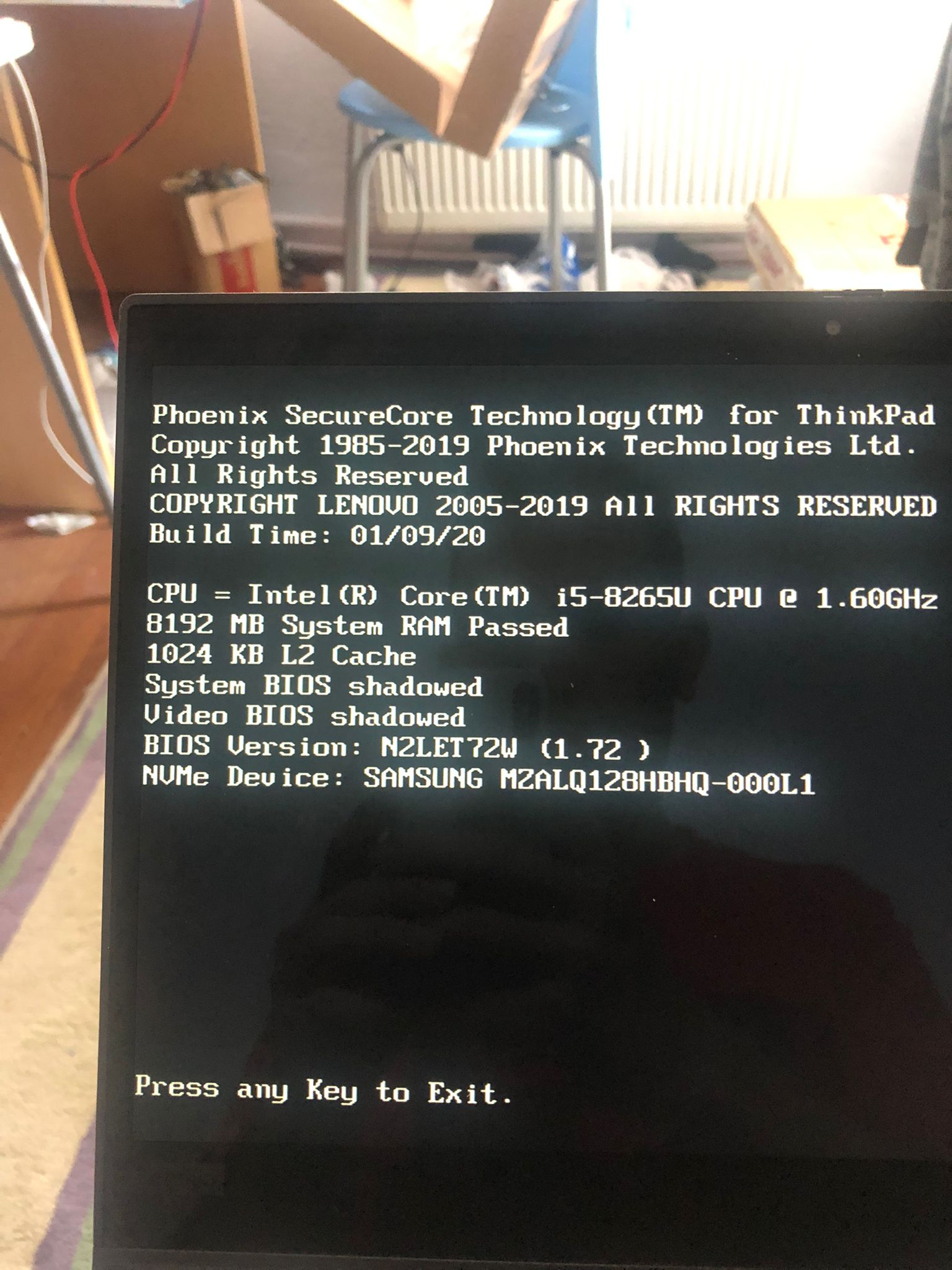

            thinkpad x390 yoga please unlock password
            LENOVO THİNKPAD X390 İ5/8GEN
            can someone please remove the bios password for me?
            I added working bios + ec.

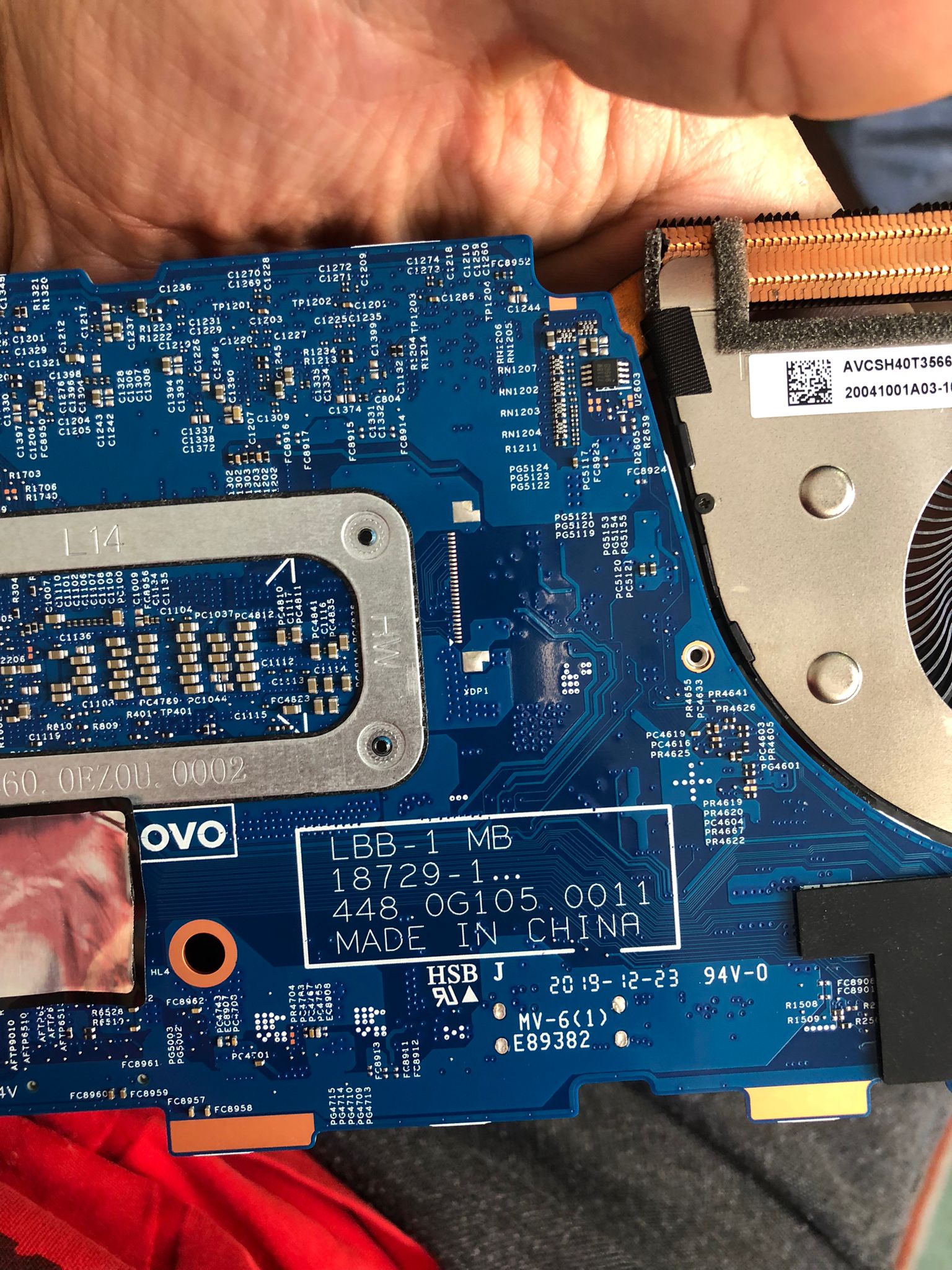

                  https://www.badcaps.net/forum/showth...ighlight=LBB-1

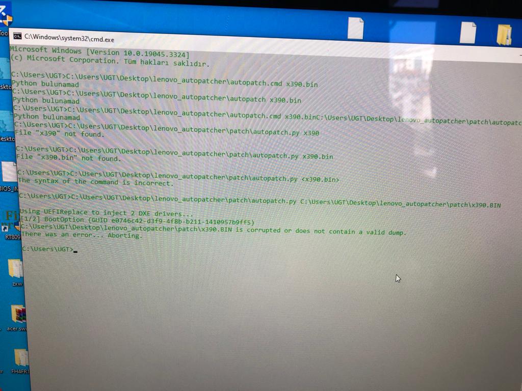

                                  I have this Lenovo ThinkPad X390, Tried Lenovo autopatches few times, after writing Patched File, the Laptop starts Self healing Bios set up even I keep the bottom tamper button pressed.
                                  Could anyone please remove the password for me.
