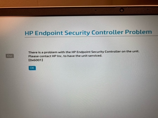

            #47
            I NEED FIX HP ENDPOINT
            MODEL HP 830 G5
            SN: 5CG8345YBW
            BOARD SERIAL 6050A2930901-MB-A01(A1)

                #49
                MODEL HP 830 G5
                SN: 5CG8345YBW
                PLEASE REMOVE "HP endpoint security controller problem"

                  #50
                  MODEL HP 830 G5
                  SN: 5CG8345YBW
                  hi try

                    #51
                    Originally posted by shiyab
                    hi try
                    tks bro
