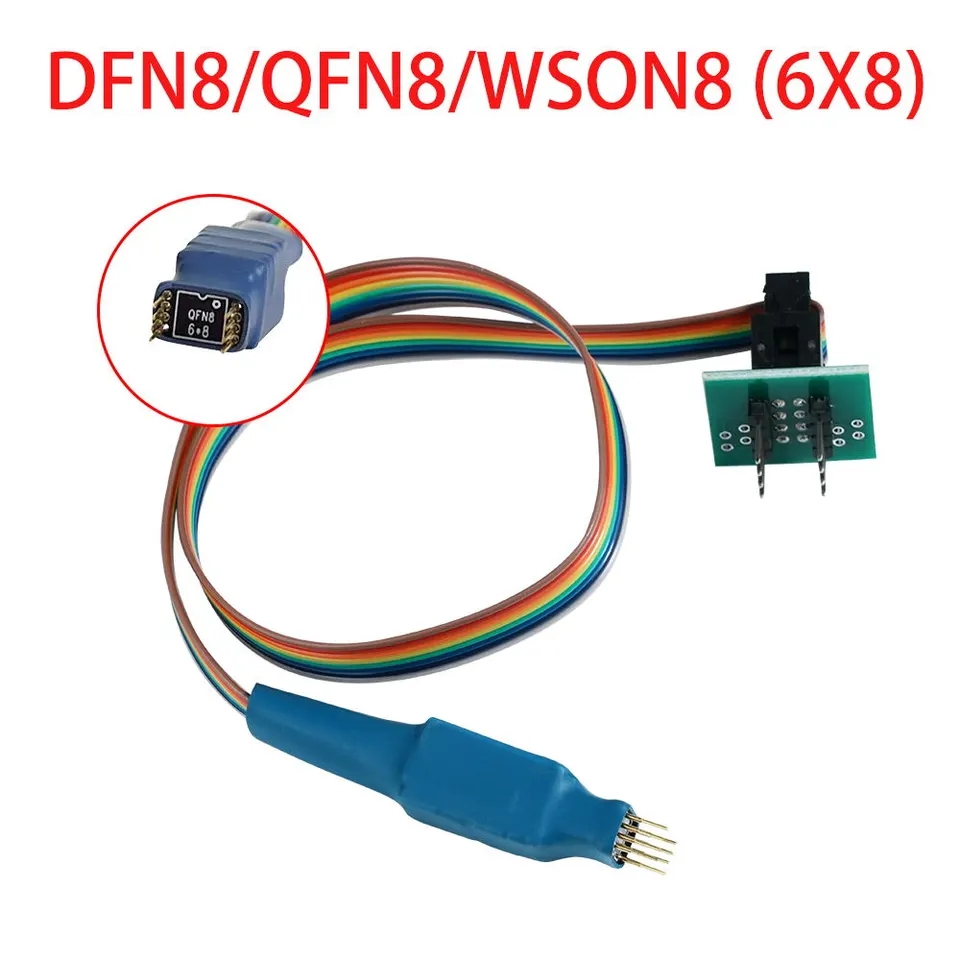

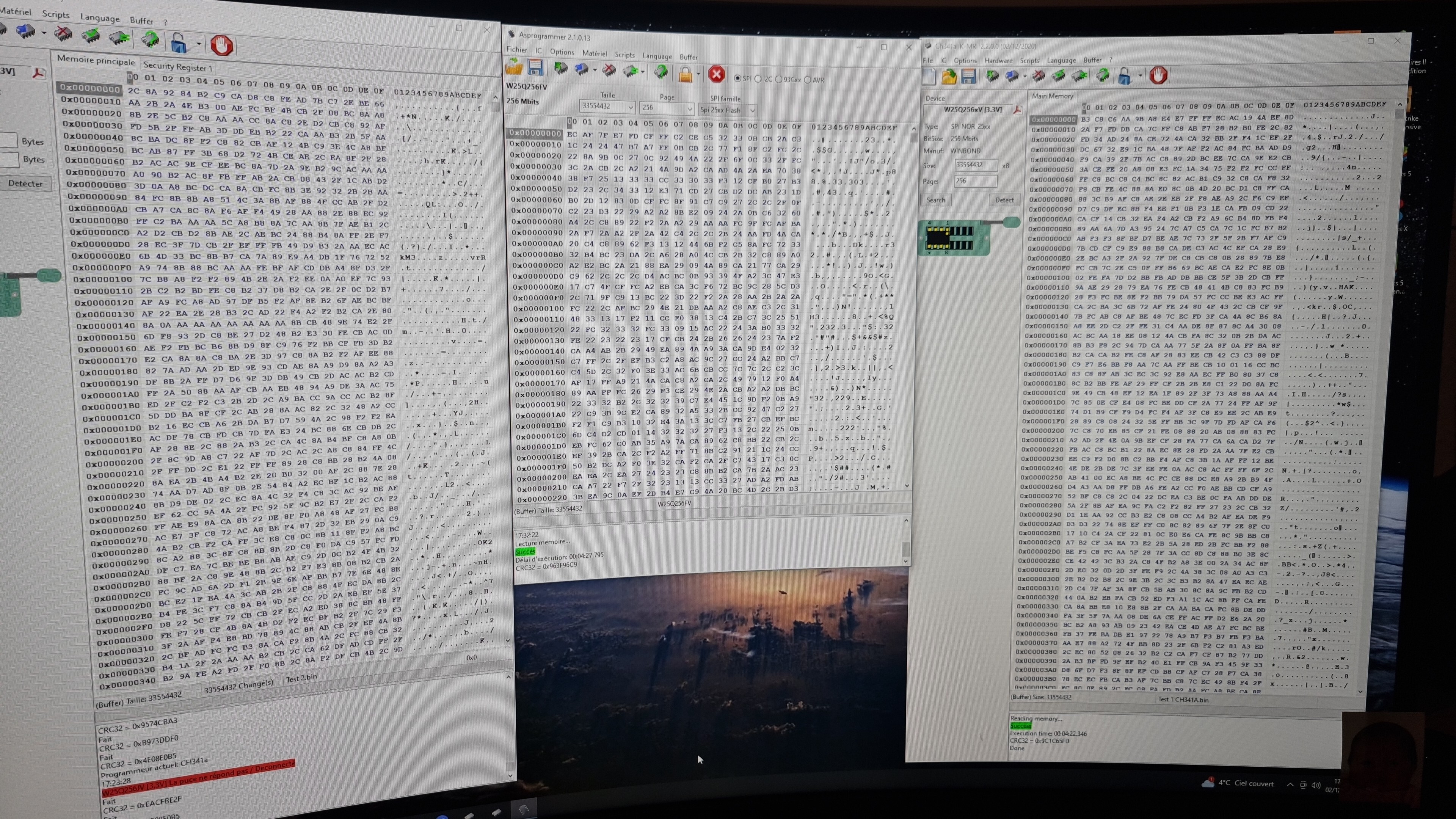

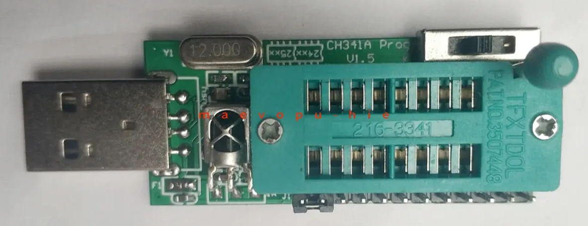

Re: HP EliteBook x360 830 G7 bios password
SAME corrupt DUMP
HP EliteBook x360 830 G7 bios password
Re: HP EliteBook x360 830 G7 bios password
sorry hereAttached FilesLeave a comment:
Re: HP EliteBook x360 830 G7 bios password
sorry i'm new to flashing bios,i use neo programmer and a ch341
how do you dump it in 16mb ?Leave a comment:
Re: HP EliteBook x360 830 G7 bios password
thisAttached FilesLeave a comment:
Re: HP EliteBook x360 830 G7 bios password
hereAttached FilesLeave a comment:
Re: HP EliteBook x360 830 G7 bios password
Hi, I can't remove the bios password for this hp laptop, I tried hpunlocker but nothing works, it asks me for the bios password..I need help please attach my bios thanks in advance
sn 5CG1240X18Attached FilesLeave a comment:
Re: HP EliteBook x360 830 G7 bios password
Originally posted by anhbanxoiVery nice tool. Thank you
During the first boot, it is important to reset the BIOS to factory defaults, then add the product information, MPM exactly as provided above.
Important, when typing, do not leave any blank spaces between characters.Last edited by SMDFlea; 11-08-2022, 06:07 AM.Leave a comment:
Re: HP EliteBook x360 830 G7 bios password
HP EliteBook x36_830 G7 learning unlock
Shit, but can not find :Feature Byte, Build Id, SKU Number and Product Family in bios file.Attached FilesLast edited by hoaca388; 04-01-2022, 12:38 AM.Leave a comment:
Re: HP EliteBook x360 830 G7 bios password
@anhbanxoi
There are two ways to unlock your laptop, although the above format is more labor intensive involving entering the parameters after unlocking, it is still my preference. The other way would be through the Embedded Controller (EC) located on the top of the board.Last edited by onizzbox; 04-01-2022, 12:07 AM.Leave a comment:
Re: HP EliteBook x360 830 G7 bios password
AgainAttached FilesLeave a comment:
Re: HP EliteBook x360 830 G7 bios password
TryAttached FilesLeave a comment:
Re: HP EliteBook x360 830 G7 bios password
is that also 16mb bios chip on boardLeave a comment:
Re: HP EliteBook x360 830 G7 bios password
try and feedbackAttached FilesLeave a comment:
by tlindiSublect line continuation: ... Jaguar IDS PC aka Panasonic
>Read BIOS guides, methods, resources and tools
Ack
>Try the method at BIOS guides, methods, resources and tools before requesting help
Ack
>Explain you were not able to succeed with the methods at BIOS guides, methods, resources and tools
python ./main.py "/mnt/c/temp/205605f9e1b60403a41787efeffe9cad-flas_maybe5.BIN" --output-dir "/mnt/c/temp/205605f9e1b60403a41787efeffe9cad-flas_maybe5.txt"
Channel: BIOS Requests ONLY!
This specification for the HP EliteBook x360 EliteBook x360 1030 G2 (ENERGY STAR) Hybrid (2-in-1) can be useful for upgrading or repairing a laptop that is not working. As a community we are working through our specifications to add valuable data like the EliteBook x360 1030 G2 (ENERGY STAR) boardview and EliteBook x360 1030 G2 (ENERGY STAR) schematic. Our users have donated over 1 million documents which are being added to the site. This page will be updated soon with additional information. Alternatively you can request additional help from our users directly on the relevant badcaps forum. Please...09-06-2024, 06:40 AM
This specification for the HP EliteBook x360 EliteBook x360 1020 G2 Notebook can be useful for upgrading or repairing a laptop that is not working. As a community we are working through our specifications to add valuable data like the EliteBook x360 1020 G2 boardview and EliteBook x360 1020 G2 schematic. Our users have donated over 1 million documents which are being added to the site. This page will be updated soon with additional information. Alternatively you can request additional help from our users directly on the relevant badcaps forum. Please note that we offer no warranties that any specification,...09-06-2024, 06:10 AM
This specification for the HP EliteBook x360 EliteBook x360 1030 G2 (ENERGY STAR) Hybrid (2-in-1) can be useful for upgrading or repairing a laptop that is not working. As a community we are working through our specifications to add valuable data like the EliteBook x360 1030 G2 (ENERGY STAR) boardview and EliteBook x360 1030 G2 (ENERGY STAR) schematic. Our users have donated over 1 million documents which are being added to the site. This page will be updated soon with additional information. Alternatively you can request additional help from our users directly on the relevant badcaps forum. Please...09-06-2024, 05:33 AM
This specification for the HP EliteBook x360 EliteBook x360 1030 G2 (ENERGY STAR) Hybrid (2-in-1) can be useful for upgrading or repairing a laptop that is not working. As a community we are working through our specifications to add valuable data like the EliteBook x360 1030 G2 (ENERGY STAR) boardview and EliteBook x360 1030 G2 (ENERGY STAR) schematic. Our users have donated over 1 million documents which are being added to the site. This page will be updated soon with additional information. Alternatively you can request additional help from our users directly on the relevant badcaps forum. Please...09-06-2024, 05:33 AM
- Loading...
- No more items.
Leave a comment:
