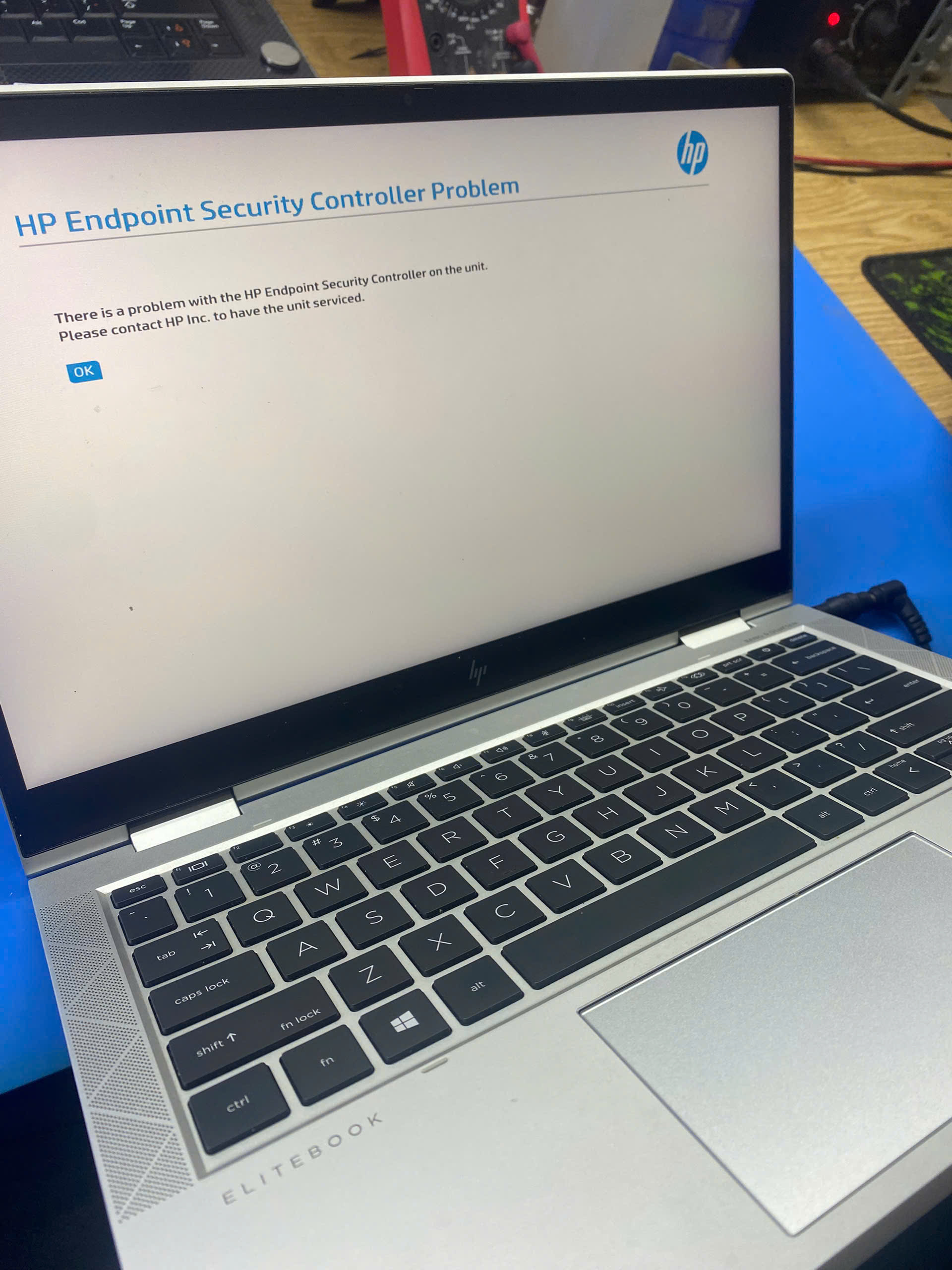

HP EliteBook x360 830 G7 bios password
Hi all i need bios administrator password for my Hp elitbook x360 830 g7 laptop
sn 5CG12231KY
size off dump file is 32mb main bios
and tHe second cip bios is 16 mb
emergency
yoursLeave a comment:
wHere i can found tHe scond cHip i found only tHat one witH 32mb size any picturs for 16mb bios cHipLeave a comment:
Hi all i need bios administrator password for my Hp elitbook x360 830 g7 laptop
sn 5CG12231KY
size off dump file is 32mb
emergency
yours
Leave a comment:
hi try and feedbackAttached FilesLeave a comment:
HP EliteBook x360 830 G7
6050a3142001-mb-a01
Pls help me to BUILD this Elitebook 830 G7 NO POWERAttached FilesLeave a comment:
sorry I overlooked it,
here are the team details
Model: Elitebook x360 830 G7
Serial: 5CG1102SPL
could you help me, a bios update was being carried out and the device was turned off by battery and did not have a charger inserted (that was what the client indicated)
Therefore the device only presents a black screen.
Could you help me by cleaning the file?
thank you very much in advanceLeave a comment:
sorry I overlooked it,
here are the team details
Model: Elitebook x360 830 G7
Serial: 5CG1102SPL
could you help me, a bios update was being carried out and the device was turned off by battery and did not have a charger inserted (that was what the client indicated)
Therefore the device only presents a black screen.
Could you help me by cleaning the file?
thank you very much in advanceLeave a comment:
Good afternoon, could you help me, a bios update was being carried out and the device was turned off by battery and did not have a charger inserted (that was what the client indicated)
Therefore the device only presents a black screen.
Could you help me by cleaning the file?
thank you very much in advanceLeave a comment:
Good afternoon, could you help me, a bios update was being carried out and the device was turned off by battery and did not have a charger inserted (that was what the client indicated)
Therefore the device only presents a black screen.
Could you help me by cleaning the file?
thank you very much in advanceAttached FilesLeave a comment:
first boot press f10 apply factory defaults and restart, 2nd boot reset security settings to defaults and exit.
use BCU. you can permanently disable Absolute lock in BCU.
here's your dmi:
Serial Number: 5CG1222YJZ
Product #/SKU: 1D3F0UT#ABA
CT Number: PJRVN00WBF902T
Description: HP EliteBook x360 830 G7 Not
BuildID: 20WWOLDT601#SABA#DABA
Feature Byte: 3X476J6S6b7B7H7M7R7W7maBapaqauawb8bVbhcAdUdpdqfPguhKhWhkj4jhk8mEnV.A5
Leave a comment:
by tlindiSublect line continuation: ... Jaguar IDS PC aka Panasonic
>Read BIOS guides, methods, resources and tools
Ack
>Try the method at BIOS guides, methods, resources and tools before requesting help
Ack
>Explain you were not able to succeed with the methods at BIOS guides, methods, resources and tools
python ./main.py "/mnt/c/temp/205605f9e1b60403a41787efeffe9cad-flas_maybe5.BIN" --output-dir "/mnt/c/temp/205605f9e1b60403a41787efeffe9cad-flas_maybe5.txt"
Channel: BIOS Requests ONLY!
This specification for the HP EliteBook x360 EliteBook x360 1030 G2 (ENERGY STAR) Hybrid (2-in-1) can be useful for upgrading or repairing a laptop that is not working. As a community we are working through our specifications to add valuable data like the EliteBook x360 1030 G2 (ENERGY STAR) boardview and EliteBook x360 1030 G2 (ENERGY STAR) schematic. Our users have donated over 1 million documents which are being added to the site. This page will be updated soon with additional information. Alternatively you can request additional help from our users directly on the relevant badcaps forum. Please...09-06-2024, 06:40 AM
This specification for the HP EliteBook x360 EliteBook x360 1020 G2 Notebook can be useful for upgrading or repairing a laptop that is not working. As a community we are working through our specifications to add valuable data like the EliteBook x360 1020 G2 boardview and EliteBook x360 1020 G2 schematic. Our users have donated over 1 million documents which are being added to the site. This page will be updated soon with additional information. Alternatively you can request additional help from our users directly on the relevant badcaps forum. Please note that we offer no warranties that any specification,...09-06-2024, 06:10 AM
This specification for the HP EliteBook x360 EliteBook x360 1030 G2 (ENERGY STAR) Hybrid (2-in-1) can be useful for upgrading or repairing a laptop that is not working. As a community we are working through our specifications to add valuable data like the EliteBook x360 1030 G2 (ENERGY STAR) boardview and EliteBook x360 1030 G2 (ENERGY STAR) schematic. Our users have donated over 1 million documents which are being added to the site. This page will be updated soon with additional information. Alternatively you can request additional help from our users directly on the relevant badcaps forum. Please...09-06-2024, 05:33 AM
This specification for the HP EliteBook x360 EliteBook x360 1030 G2 (ENERGY STAR) Hybrid (2-in-1) can be useful for upgrading or repairing a laptop that is not working. As a community we are working through our specifications to add valuable data like the EliteBook x360 1030 G2 (ENERGY STAR) boardview and EliteBook x360 1030 G2 (ENERGY STAR) schematic. Our users have donated over 1 million documents which are being added to the site. This page will be updated soon with additional information. Alternatively you can request additional help from our users directly on the relevant badcaps forum. Please...09-06-2024, 05:33 AM
- Loading...
- No more items.
Leave a comment:
