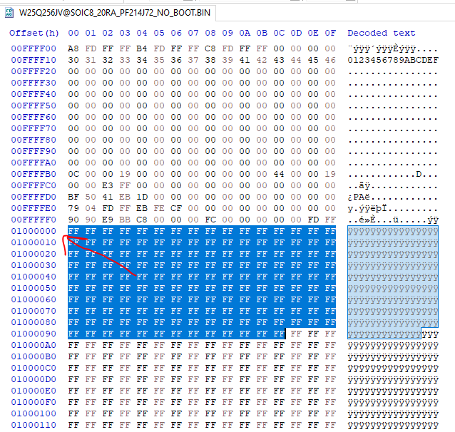

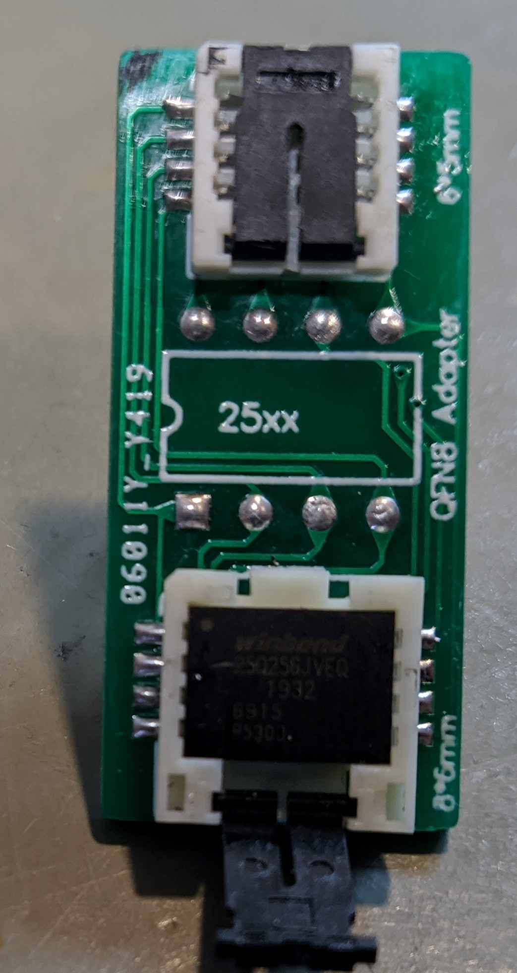

                                Re: Lenovo ThinkPad E14 Bios
                                Hello
                                Machine dosent boot after ME update, just hangs on boot.
                                SN:PF214J72
                                MTM:20RA001LMX
                                Cant clear ME.
                                • hardware1
                                  • Sep 2021
                                  • 2927
                                  • N/A
                                  Originally posted by Salmus666
                                  Hello
                                  SN:PF214J72
                                  MTM:20RA001LMX
                                  Cant clear ME.
                                  Are you sure that your BIOS Chip size is 32MB (256Mbit) not 16MB (128Mbit)?

                                  • Salmus666
                                    • Jan 2023
                                    • 16
                                    • Eesti
                                    looks like it.
                                    • hardware1
                                      • Sep 2021
                                      • 2927
                                      • N/A
                                      looks like it.
                                      Your Backup file is 32MB but I can see the end of the BIOS is at Offset (1000000h) and after that the file is empty, so that mean your file should be 16MB.
                                      Also (VSCC Table) for your file only shows 16MB (128Mbit) Chips not 32MB.
                                      Maybe this Chip is programmed before with a wrong BIOS file.
                                      all donations are welcome,
                                      • Salmus666
                                        • Jan 2023
                                        • 16
                                        • Eesti
