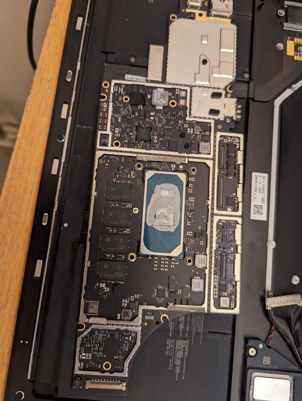

                      #70
                      Re: Surface Laptop 3 Model 1868 Bios password
                      Hey @peste - reckon I could use your attached .bin BIOS file with a CH341A programmer to flash my surface laptop?

                          • thatguycalledrob
                            • Jan 2023
                            • 7
                            • United Kingdom
                            #73

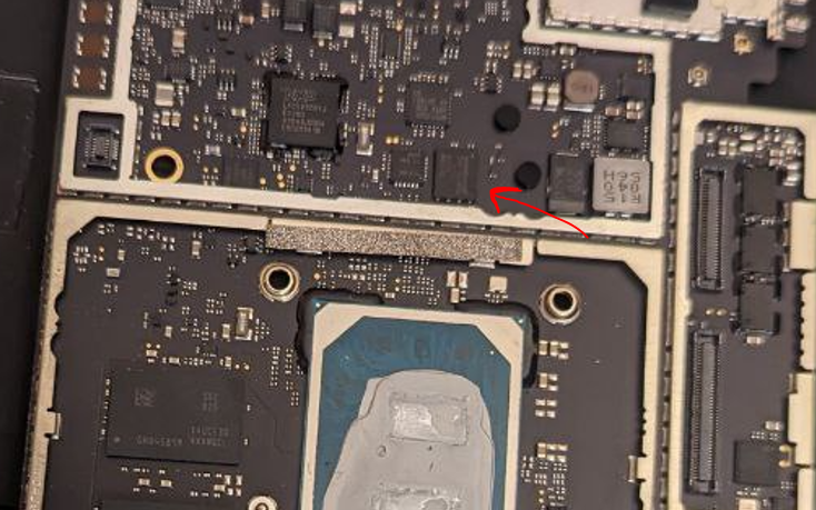

                            Anyone know where the BIOS chip is on the surface pro board?
                            Good to know other people have their laptops in pieces too @Moh.Jr.Boudali !
                            • hardware1
                              • Sep 2021
                              • 2949
                              • N/A
                              #74
                              Upload a clear image for this WSON chip.

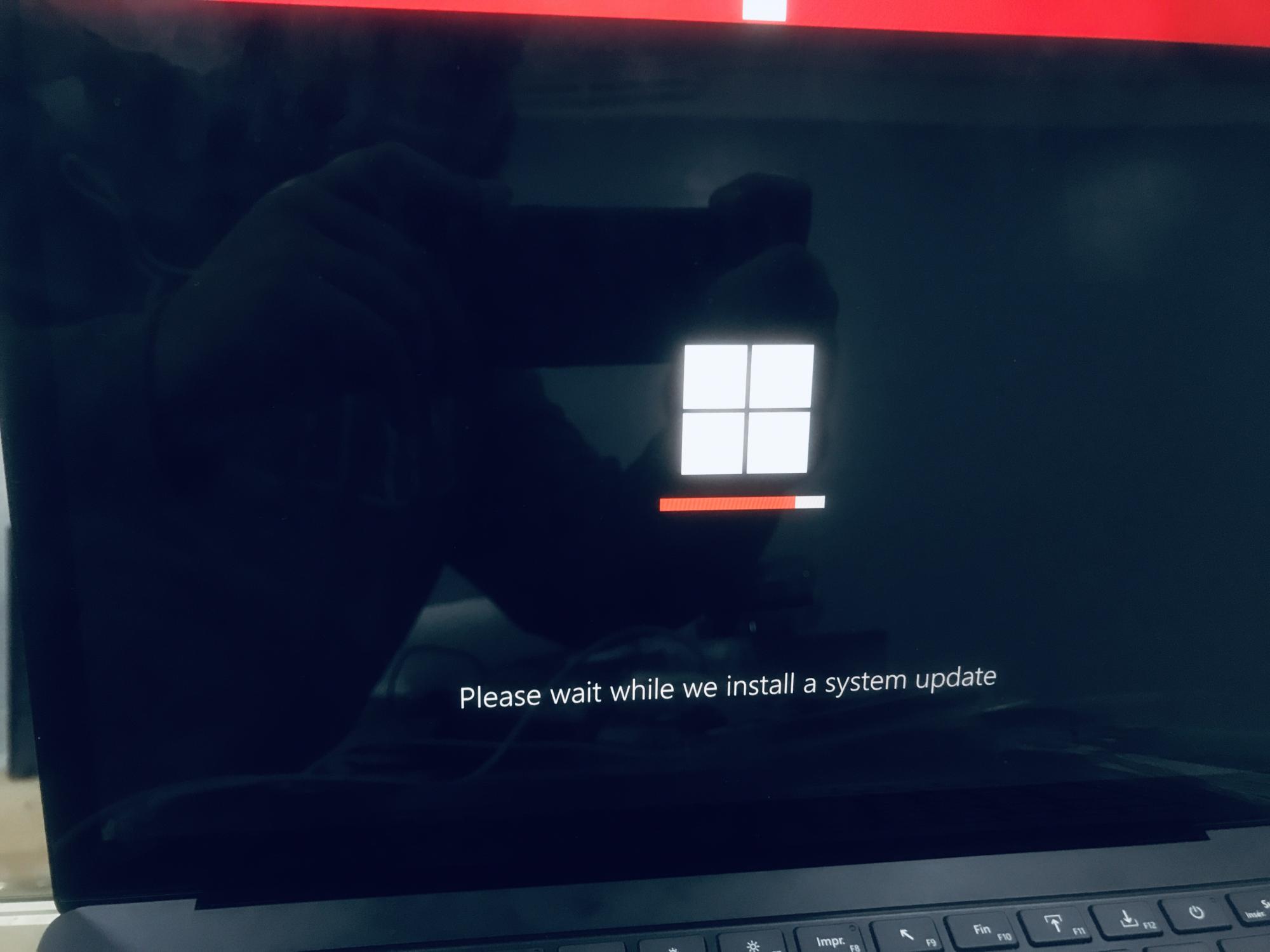

                                #75
                                Originally posted by peste
                                try..
                                hello , sorry for the delay to responce, i flashed the spi rom and it work , thank you to give me your time for help. @peste
                                first boot laptop reboot 3 times then make update like it show in pic, and i enter bios password gone and all setup option shows in menu, juste the information like model and systeme uuid and serial number changes. can i fix that information and how to do it.
                                thank's again

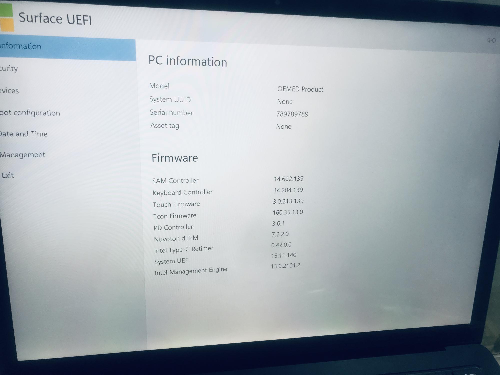

                                  #76
                                  hello, i still need help for:
                                  problem / BIOS PASSWORD /
                                  laptop / MICROSOFT SURFACE LAPTOP 3 13.5" / 1868 /
                                  cpu / INTEL 10TH GEN /
                                  motherboard / M1098028-008 /
                                  spi chip / WINBOND 16MB@WSON8 / W25R128JWPQ /
                                  @peste give me help and it work no password and admin access to bios restored , but lost all machine info like model and system uuid and serial number and windows license key
                                  i need help for another try without loosin all this info, thanks.

                                    #77
                                    try..
                                    hello @peste, thank you for help, but i still need help for recover dmi info (model and system uuid and serial number and windows license key), i stuck with this situation i was able to boot into usb flash drive reinstall winos but for the drivers pack from microsoft can't install it because of an error not reconise the surface laptop 3 hardware. please @peste or anyone give me help
                                    thank's
