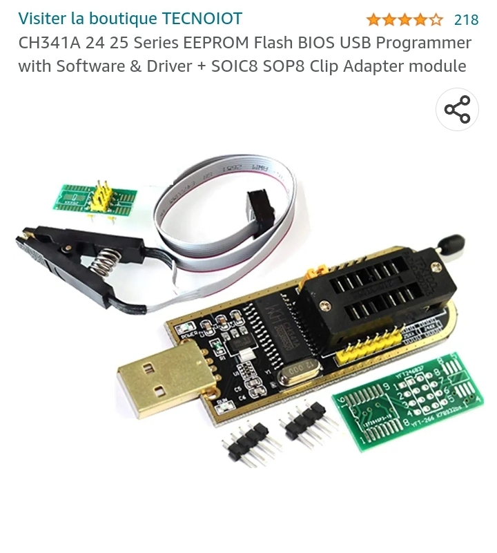

                  Re: Surface Laptop 3 Model 1868 Bios password
                  Originally posted by Vesko356
                  Why don't you read the thread from the beginning? Many of the questions are already answered.
                  There is information about your question at post #74 & #75 , regarding the ways to unsolder the chip, you can use hot air station, or WSON8 pogo pin adapter, or solder wires from the programmers adapter board to the chip legs, or wires soldered to surrounding parts connected to the traces.
                  i buy this?
                    Originally posted by Gsa_rider67
                    i buy this?
                    The most unreliable and problematic programmer possible, but it is also dirt cheap. A matter of luck, some units work, others (most of them ) are problematic.
                      I wouldn't have any use for it after having solved my problem, hence my economic choice.
                      What is the risk ?
                        What is the risk ?
                        We are starting to get slightly off topic, you already have all the information you need, I don't think anything needs to be added.
                                  i buy this?
                                  Don't bother, I am also a n00b and got as far as finding the chip [2 hour teardown]. This unit won't clip on & you will need to de-solder and probably do something horrible to connect it up for the flashing procedure.
                                  I ended up removing the harddrive, cloning another laptop's OS onto it then plugging it back in. Not ideal, but will get the laptop up & running again (given that's all you want to do).
