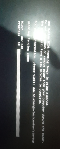

                    Re: HP Pavilion Gaming DA0G3hmb8d0 rev d G3HA
                    I use the bios above but it happens clearing pending image
                    Board : DA0G3HMB8D0 Rev D G3HA
                    AMd ryzen 5 3550
                      • 20304
                      #30
                      AMd ryzen 5 3550
                      [ATTACH]311732[/ATTACH]
                      Serial number,backup etc etc -> https://www.badcaps.net/forum/showthread.php?t=103570

                              #34
                              Originally posted by hoaca388
                              HP Pavilion Gaming - 15-ec0001ax
                              the result remains the same Click image for larger version
                              after the screen turns off it doesn't turn back on and the fan spins fast sometimes slows down
                              • hoaca388
                                Badcaps
                                • Jan 2022
                                • 11191
                                • Viet Nam
                                #35
                                the result remains the same [ATTACH]311745[/ATTACH]
                                You should look for hardware solutions because the file I gave is the original file from HP.
