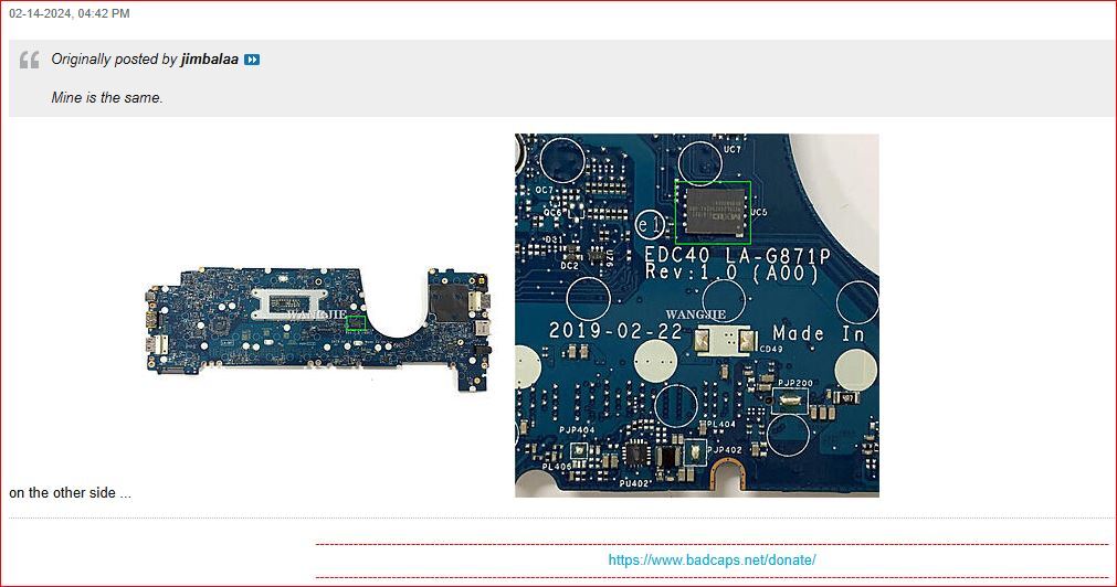

                        #251
                        Someone can point me to the propper chip to read?
                        I can see:
                        - UC6 25Q128JVSQ
                        - UT5 25Q80CSIG
                        - UT2 25Q80DVS1G
                        First one is a 16Mbytes flash SPI, and I can see people here having a 32Mb SPI for the Latitude 7400 LA-G871P
                        If I read UC6 and try to apply REX98 8FC8 patcher, I receive the error :
                        wa nakit-an ang intel signature
                        Pinduta bisan unsang key para ma exit...​
                        I've read using a clip and also desoldering the chip and reading directly connected to the CH341 Black, and the file is always the same.
                        Thanks.

                          #252
                          I can see:
                          - UC6 25Q128JVSQ
                          - UT5 25Q80CSIG
                          - UT2 25Q80DVS1G
                          Thanks.
                          pass on UT5
                            SMDFlea commented
                            Editing a comment
                            Its UC5 ??
                        • mmalagelada
                          • Apr 2017
                          • 4
                          • SPAIN
                          #253

                                    Finally got time to do it. SUCCESS!
                                    1: Protect the PCB with aluminium tape. I had no availability for kapton. Nobody wants nearby capacitors flying away.
                                    2: hot blower at 360ºCelsus.
                                    3: Preheat the zone.
                                    4: Attack the SPI Chip that in my case it ws a 25Q64JVIQ in WSON8 Capsule. 30 seconds was enough.
                                    5: Clean the chip and attach the WSON to DIL adapter. Read with the CH347 Black edition reader. Software used: NeoProgrammer V2.2.0.10
                                    6: save the file (8Mb for the 25Q64JV)
                                    7: execute the Badcaps 8fc8 patcher.
                                    8: Flash the patched file to the chip
                                    9: Read and compare to make sure the write was successful.
                                    10: Cure the PCB with the solder, flux, and wick. Drop some solder paste, I used 170ºC fusion point tin-lead paste.
                                    11: Preheat, heat, solder..
                                    12: Clean
                                    13: reassemble and Start the computer
                                    14: Wait 2 to 3 minutes. it will start in Factory Mode.
                                    15: Write the service tag when prompted.
                                    16: Once restarted press Alt+F to exit factory mode.
                                    Password was removed. Donation was made.
