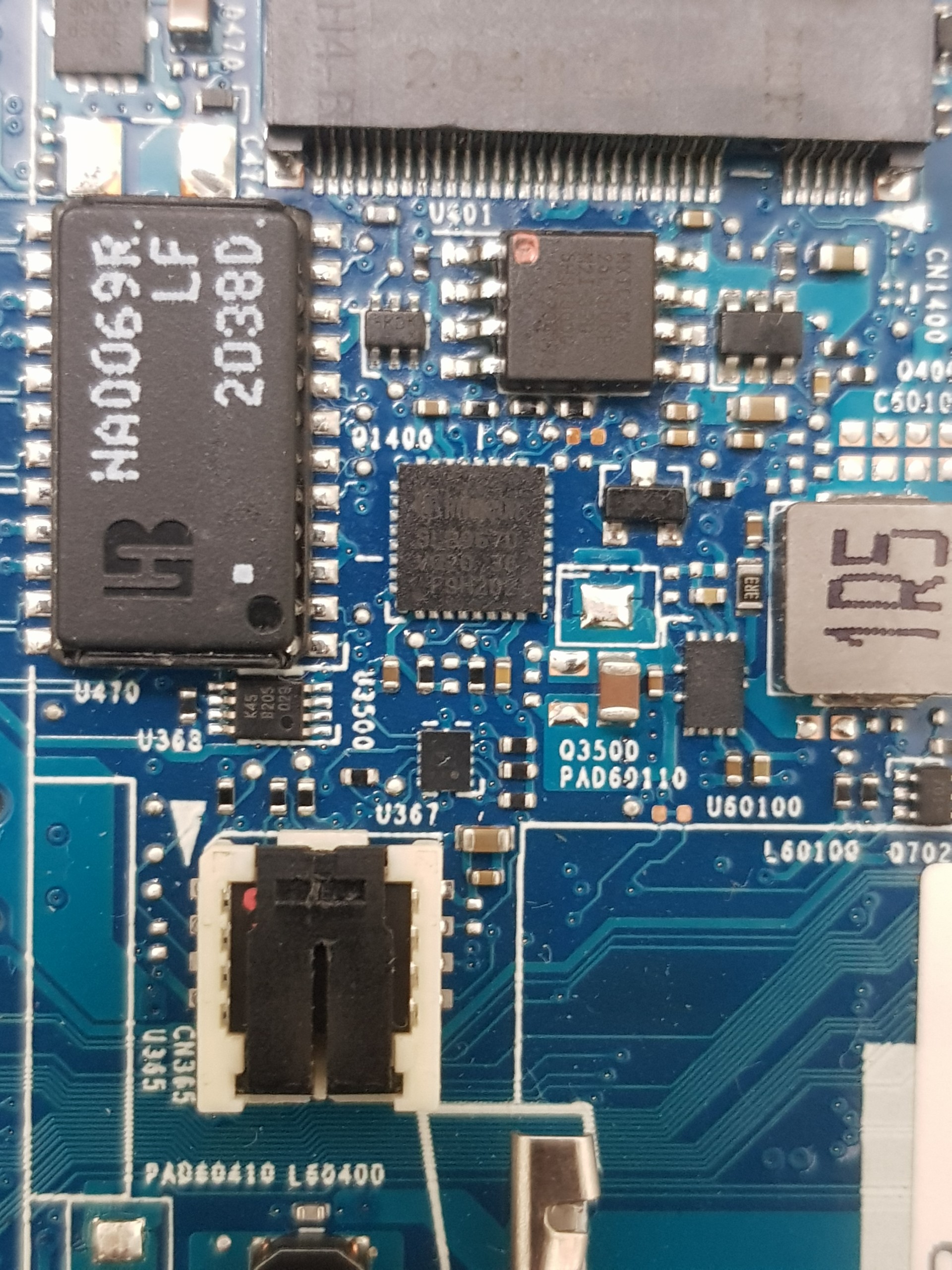

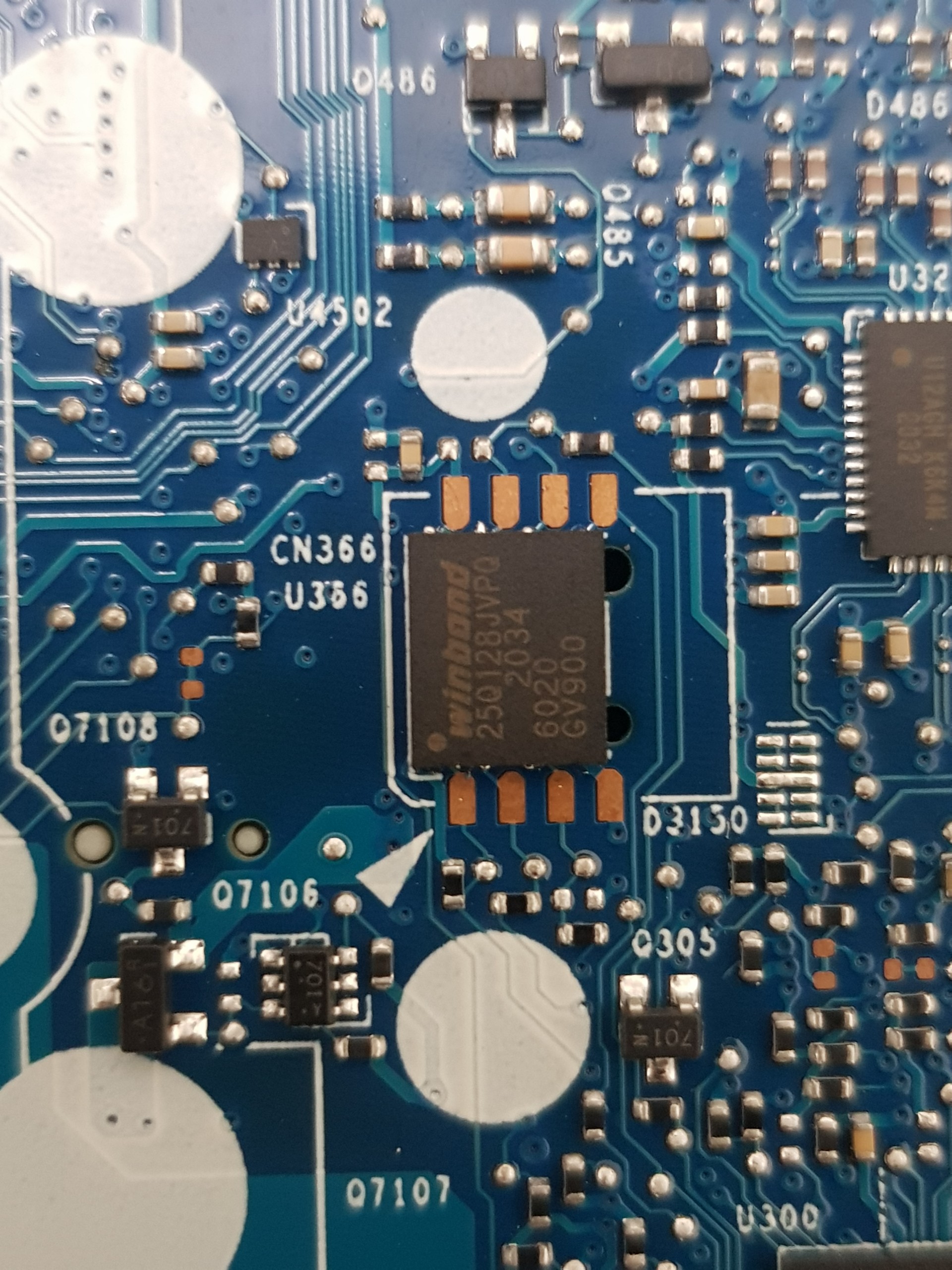

                                      Elitebook 840 G6.
                                      It has two bios chips. Would anyone know if I need to clean both of them?
                                      • shiraz77
                                        • Oct 2020
                                        • 6
                                        #899
                                        Re: HP BIOS unlock tool
                                        Elitebook 840 G6.
                                        Any help in unlocking would be appreciated. I have attached the bios files.
