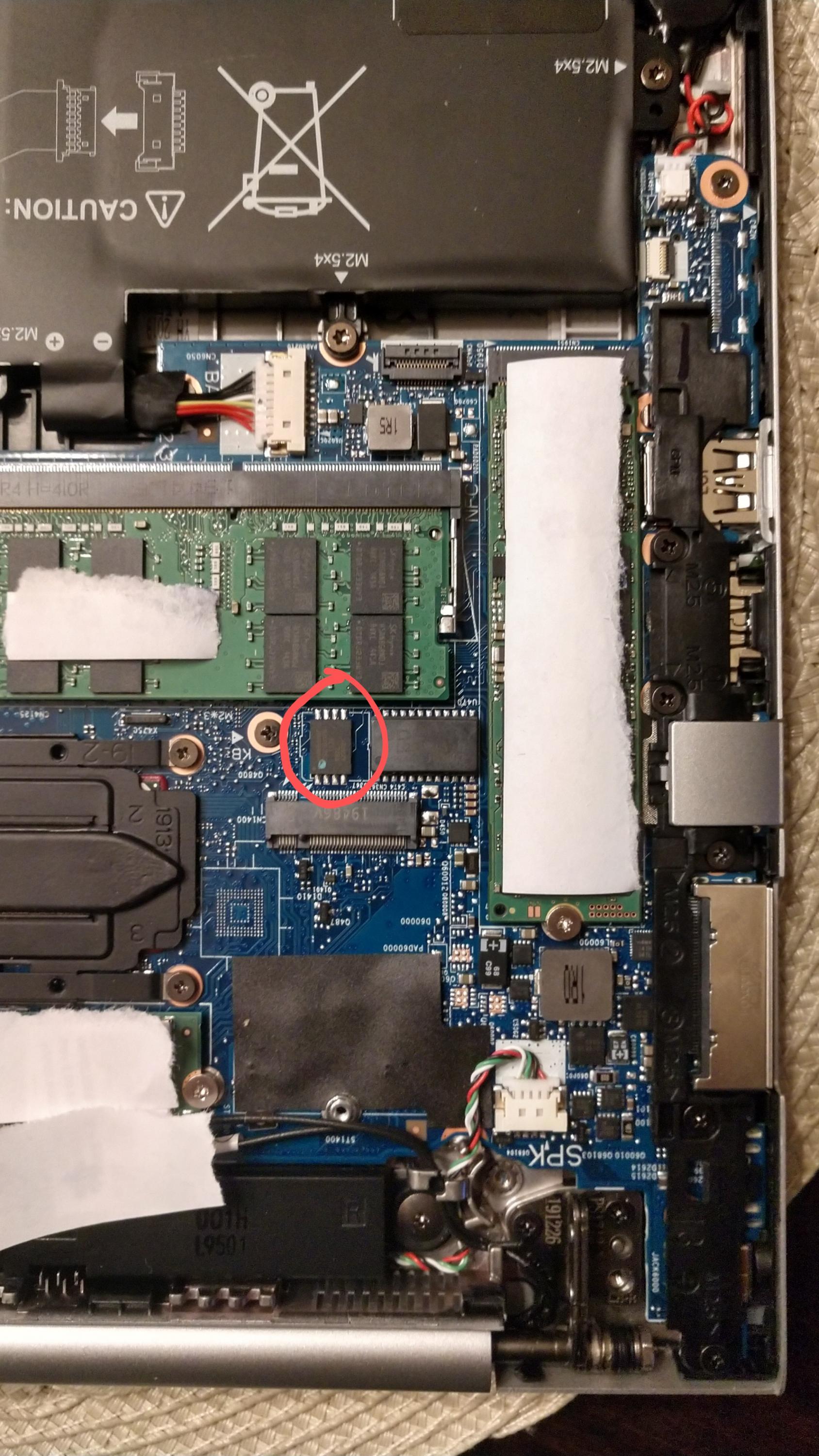

                        Excellent thread and thanks RethoricalCheese! I plan to attempt this on an Elitebook 830-G6 this week and I happen to find this in the nick of time. I realize that you don't have the new v2 version of HPUnlocker, but can you help me confirm what I need to do?
                        I only see one BIOS chip on my board; WINBOND W25Q256JVEN. Is there a second chip that I need to dump and re-program?

                          Re: HP BIOS unlock tool
                          Yes, starting to write v2 today.
                          And yes, you need the other chip, which is on the other side of the board on 840/850/745. I guess its the same with 830.
