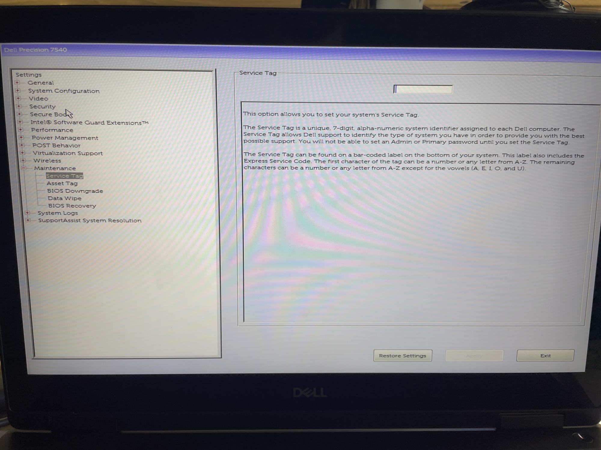

                              Hello can you help me please, I have a Dell 7540 with password Service Tag: 3XP4Q13-8FC8 thank you.
                              • volinakis
                                • Jan 2021
                                • 2874
                                • N/A
                                #35
                                Re: Dell 7540 8fc8 password
                                here
                                • gstronger
                                  • Mar 2020
                                  • 2
                                  • United Kingdom
                                  #36
                                  here
                                  Hi, thank you! it's working, but I have a problem with programming the service tag. It is not saving.
                                  I tried to setup and save, and after reboot still had the same empty space.
                                  Can you help me please how to resolve this issue? Thank you.
                                  • volinakis
                                    • Jan 2021
                                    • 2874
                                    • N/A
                                    #37
                                    try this clean ME version.
