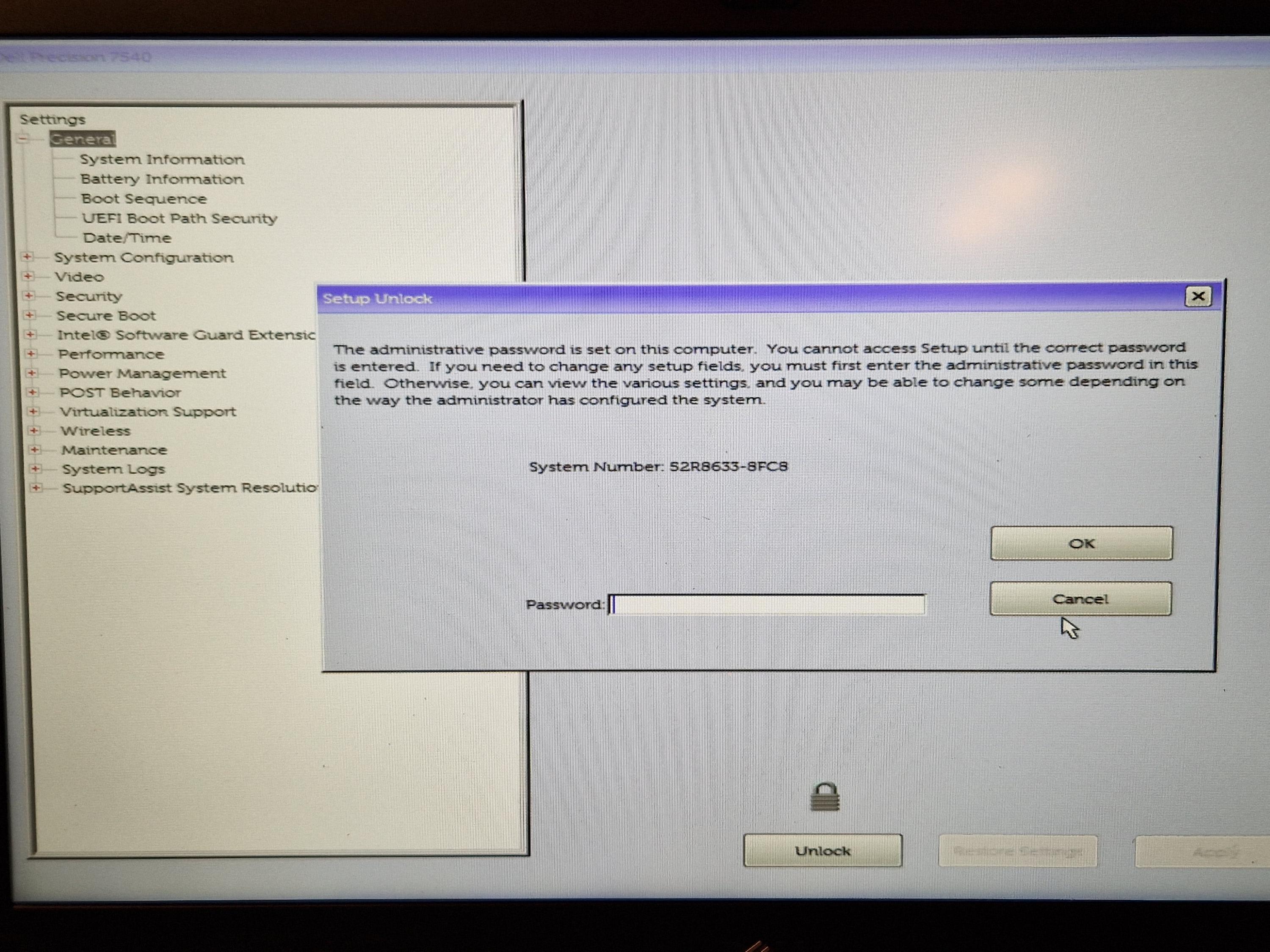

    Thank you Markus1741.
    I flash my dump and this work, but bios locked
    • Markus1741
      • Sep 2020
      • 948
      • N/A
      #42
      Re: Dell 7540 8fc8 password
      You write “I flash my dump and this work, but bios locked”
      You are not allowed to do that because Dell saves the password in the BIOS file.
      If you write back your original locked BIOS there will always be a password.
      You have to write the unlocked file and then enter the service tag, restart and exit with alt + f.
      Maybe this page will help, please read through.
      https://www.badcaps.net/forum/showpo...42&postcount=4
      • hollo13
        • Mar 2017
        • 21
        • Hungary
        #43
        Thank you Markus1741 for your help. The dump you sent works. For first I wrote back the original flash by mistake. That is why it was still locked. Thanks once again.
