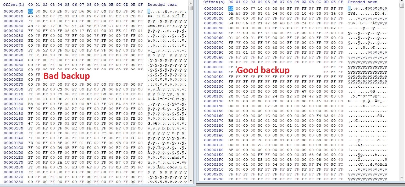

              post the original content of the bios chip

                  You must have a programmer, for example this CH341A : https://www.youtube.com/results?sear...mer+how+to+use

                          use this tool drag the 8mb bios to the tool. https://www.badcaps.net/forum/troubl...l-8fc8-patcher

                                  #237
                                  Well, i did use the patcher tool and it's not working, it keep talking about wa nakit-an ang intel signature which is intel signature not found? idk i translated it using google translate, that's why i had even posted my dumps in the first place.

                                    If you learnt how to use a hex editor you would be able to compare both your backups with some others in this thread. Both of your backups are corrupt ! .If you can`t make good backups its not going to work is it.
