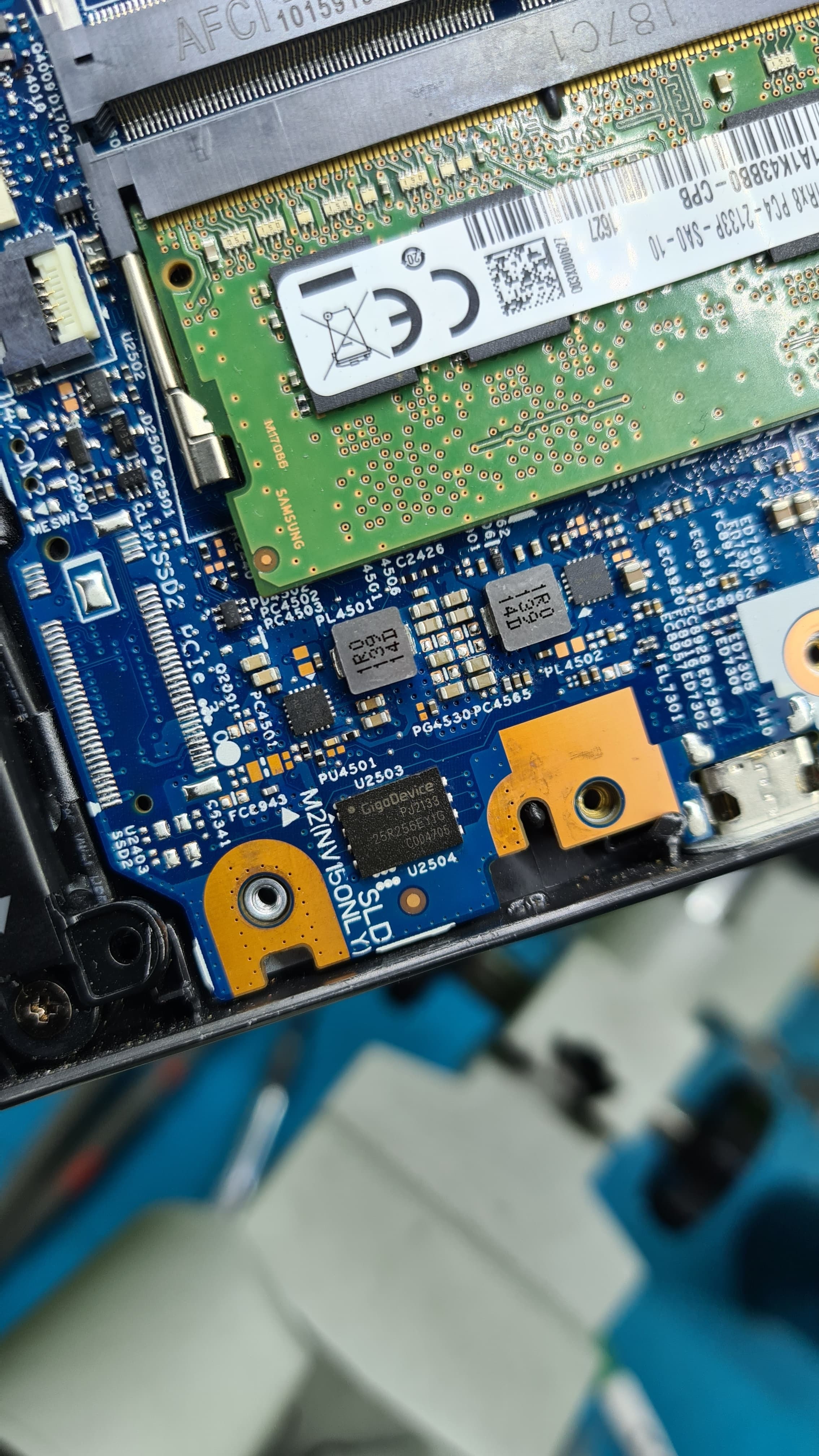

help need clean bios dell latitude 3420

          my device is Latitude 3420 ST:2YR4QG3 these files are for Vostro 3500

                      my computer only has 1 32MB chip

                          #212
                          Originally posted by minhdigital
                          Send to you, try
                          Only the orange LED lights up when you press the power button. The device does not turn on

                            Hello, I have the same thing here with a Dell 7400 notebook.
                            The LED only lights up as long as you hold the power button, that's true.
                            I'm afraid your motherboard is defective like mine.
                            I think this is not a BIOS error.

                                #215
                                but with my original BIOS it works, it only has Absolute and it freezes my computer
                                • Markus1741
                                  • Sep 2020
                                  • 905
                                  • N/A
                                  #216
                                  Well, I didn't know that, my Dell 7400 shows no reaction, no keyboard light, no start, nothing, only when I press the power button I see an amber light in the front.
                                  If I let go of the power button, the LED goes off.
                                  Then it's different for you than for me.
                                  I suspect the EC chip, but reading it is difficult.
                                  I could be wrong.​

                                      #218
                                      Try again !!
                                      After many attempts, this was the one that is working perfectly, it allowed me to configure absolute and modify the device name, the audio worked since with others it gave me an Intel OED error, I appreciate your support, thank you. .
