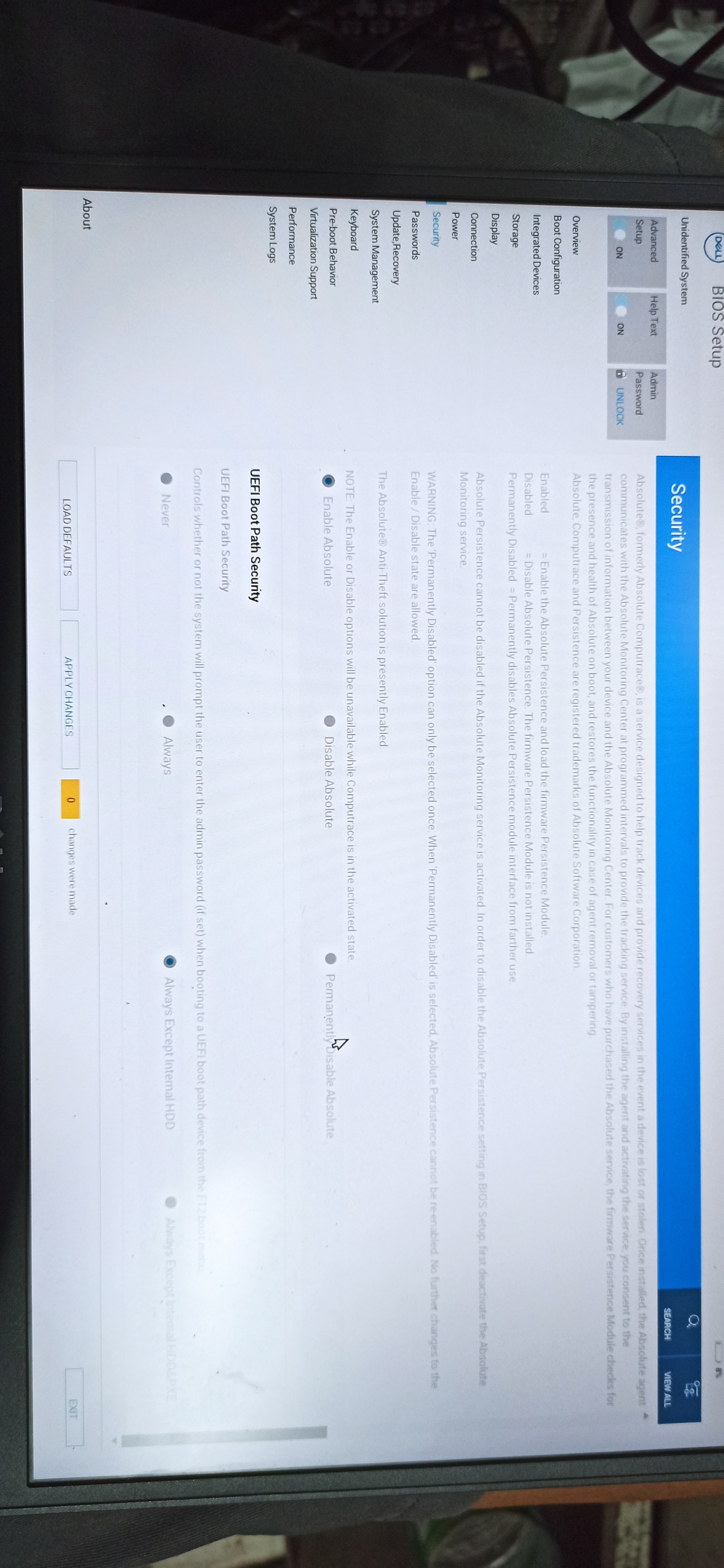

          • rex98
            • Feb 2023
            • 1289
            • Mandaue CEBU, Philippines
            #225
            Originally posted by Hkekkonen
            Hello!
            Can someone help me remove the password? Thanks!
            It's my first time ever flashing bios im stuck at this point. Hex editing is new to me also and want to learn it too.
            Service tag is 1ZN2V93
            1st boot, press F2, write service tag, disable Absolute, save (Apply changes), restart. 2nd boot press Alt+F to exit manufacturing mode.
            • Hkekkonen
              • Jan 2024
              • 8
              • Finland
              #226
              Oh yea! Im happy. Thank you very much rex98! Everything works good.
