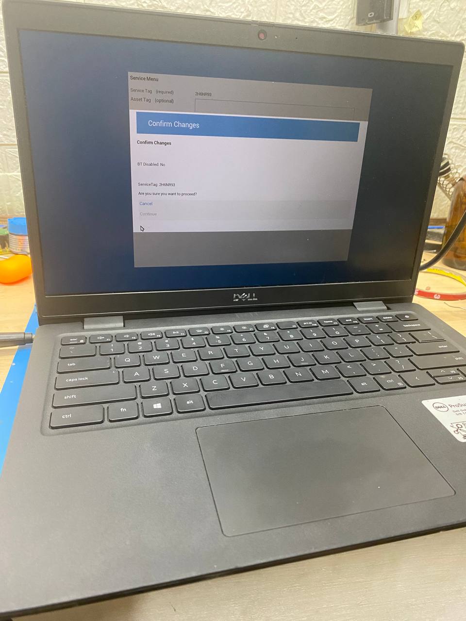

                              Re: help need clean bios dell latitude 3420
                              hi can you help me to fix and clean this bios for dell latitude 3420
                              Service Tag: 2H6NR93
                              ISSUE: NO DISPLAY /BIOS PASSWORD

                                  Try this file than replay

                                      #158
                                      unit has now display
                                      but after setting up the bios and restart not turning on

                                        #159
                                        after this confirm changes

                                          #160
                                          hi update again unit is now ok
                                          thank you very much for your help
