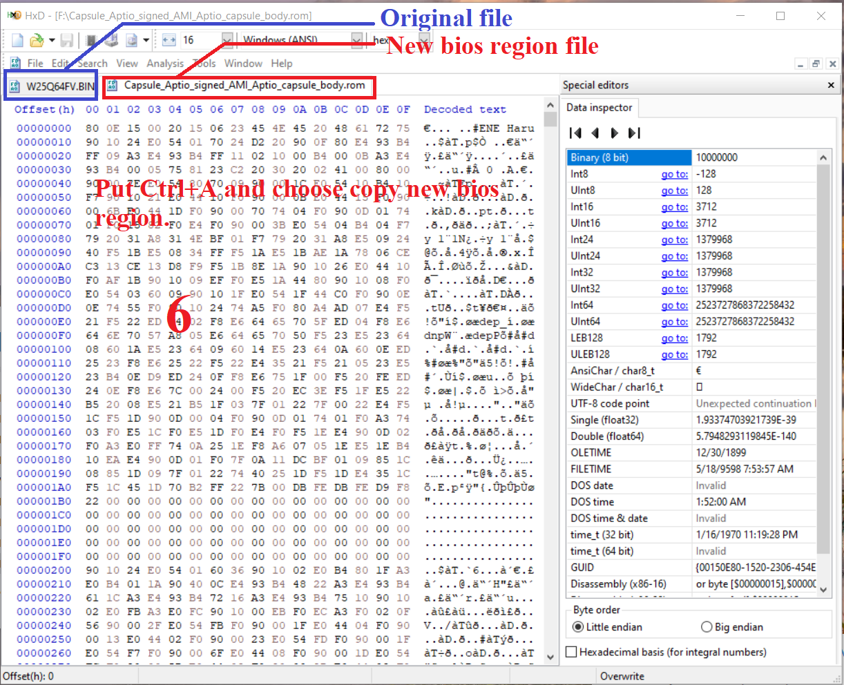

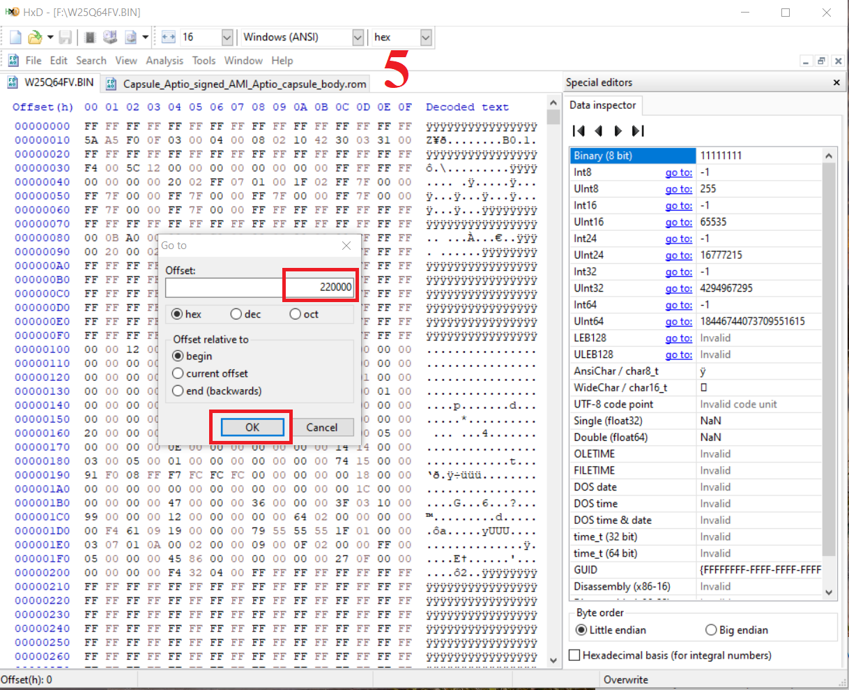

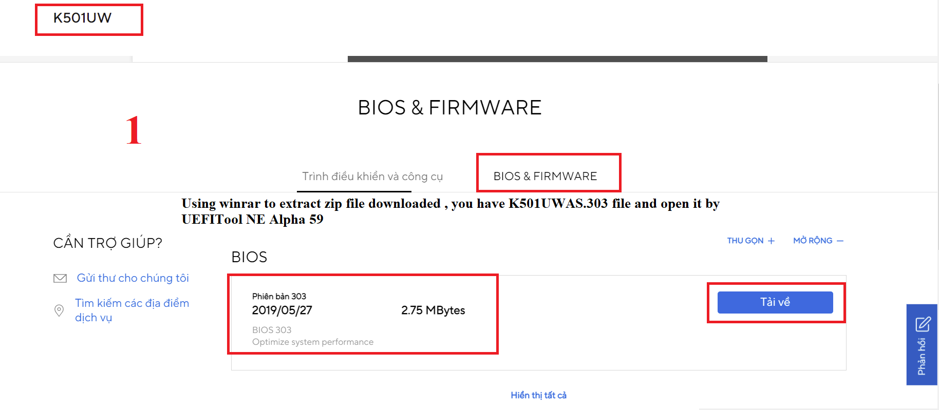

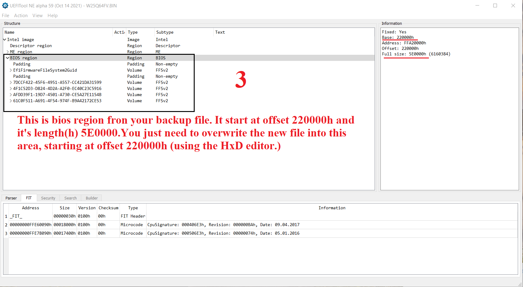

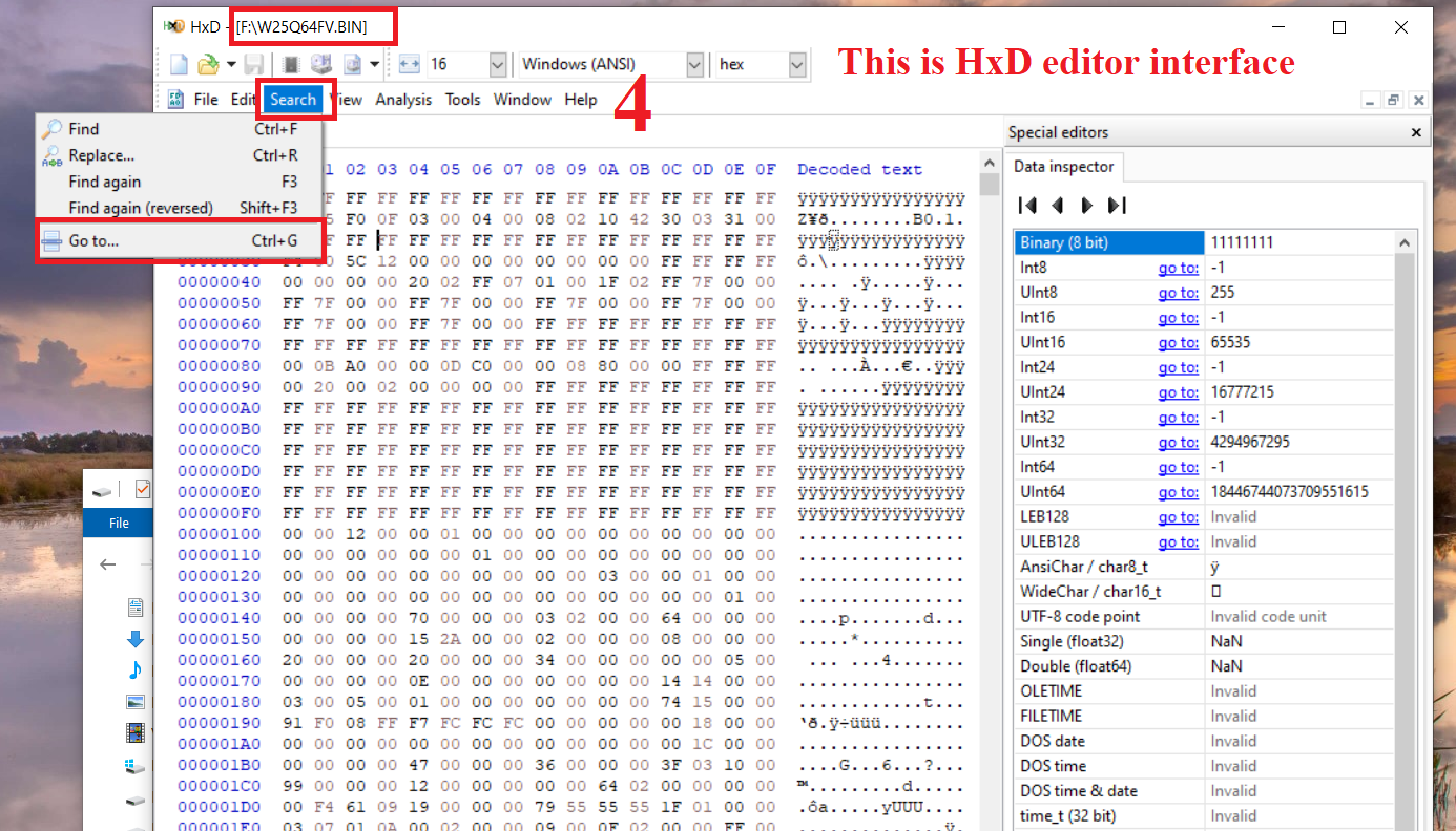

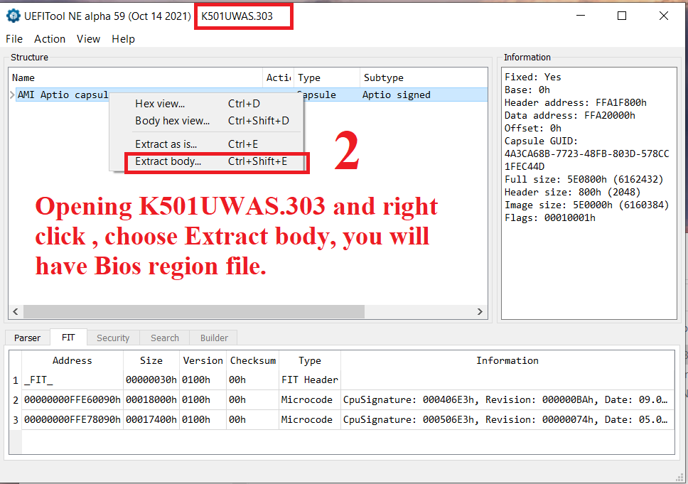

      Asus K501UW Bios Needed...
      computer stays around 0.25A. i want to try bios. have bios file in hand?
      case code : K501U
      Mainboard Code: K501UW Rev 2.0
      Backup
      • Mazorca
        • Jan 2017
        • 463
        Re: bios of this asus board K501UW Rev 2.0
        Try this
        • ProSis
          • Jun 2017
          • 86
          • Turkey
          Originally posted by Mazorca
          Try this
          Working
          • Mazorca
            • Jan 2017
            • 463
            You made my day, I am glad it worked for you.

              I want to learn about the process you have done myself, where can I find a source about it?
              • hoaca388
                Badcaps
                • Jan 2022
                • 11727
                Originally posted by ProSis
                beauty was mutual
                From Asus home page .
                • ProSis
                  • Jun 2017
                  • 86
                  • Turkey
                  Where is the bios editing tutorial on the asus page? i am looking for resource to edit corrupt bios file with new file
                  • hoaca388
                    Badcaps
                    • Jan 2022
                    • 11727
                    https://www.asus.com/vn/supportonly/...HelpDesk_BIOS/
                    And see the pictures.
                    • Mazorca
                      • Jan 2017
                      • 463
                      Start here:
                      https://www.badcaps.net/forum/showth...cleaning+guide, although I started by reading the win-raid guide.
                      then further read ;
                      https://www.badcaps.net/forum/showth...=acer+tutorial
                      Learn how to identify DMI Region, extremely important, I did a few blunders, none that would brick a laptop, I hope. It is best to use FIT to build image but UEFITool is great for extraction of regions.
